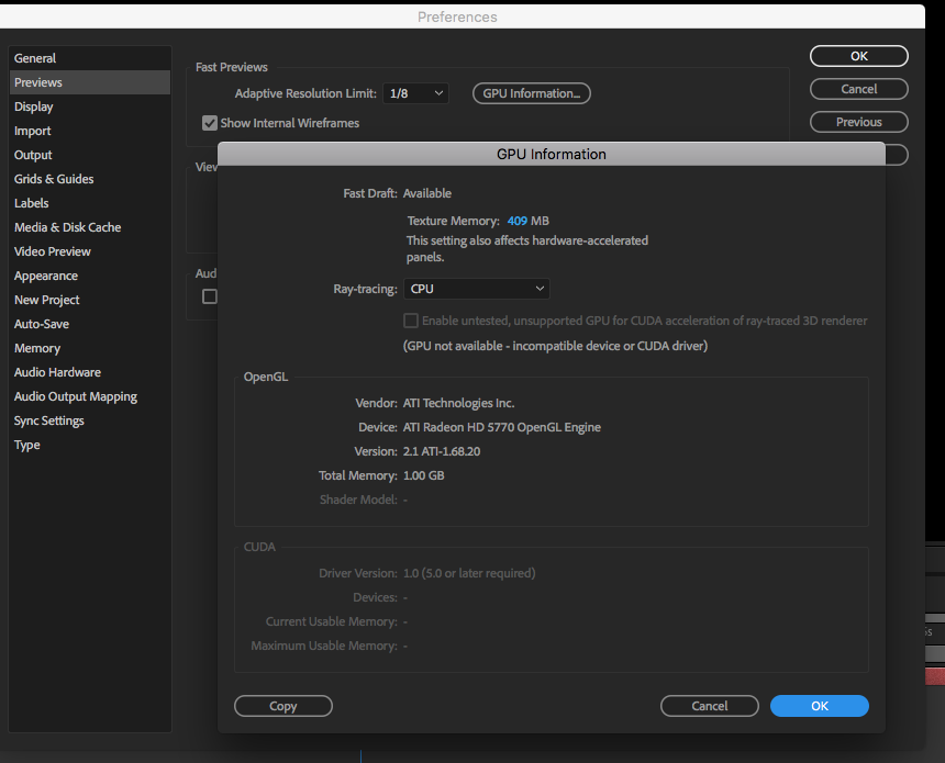

Im running High Sierra, in this case I uploaded this after effects screenshot showing the HD5770 as the rendering card... I want to use my RX560 instead, but don't know how to change it.

Check System Profiler to see if the cards are recognized.
Whichever card is connected to the display will be viewport accelerator card. You can use additional cards for rendering but only if the coded or project supports it. If you wanted to render with h.265 for example then the CPU would take over.

OpenGL only available to the GPU that connected to the monitor. As I said before, the 2nd GPU can only be used for compute.

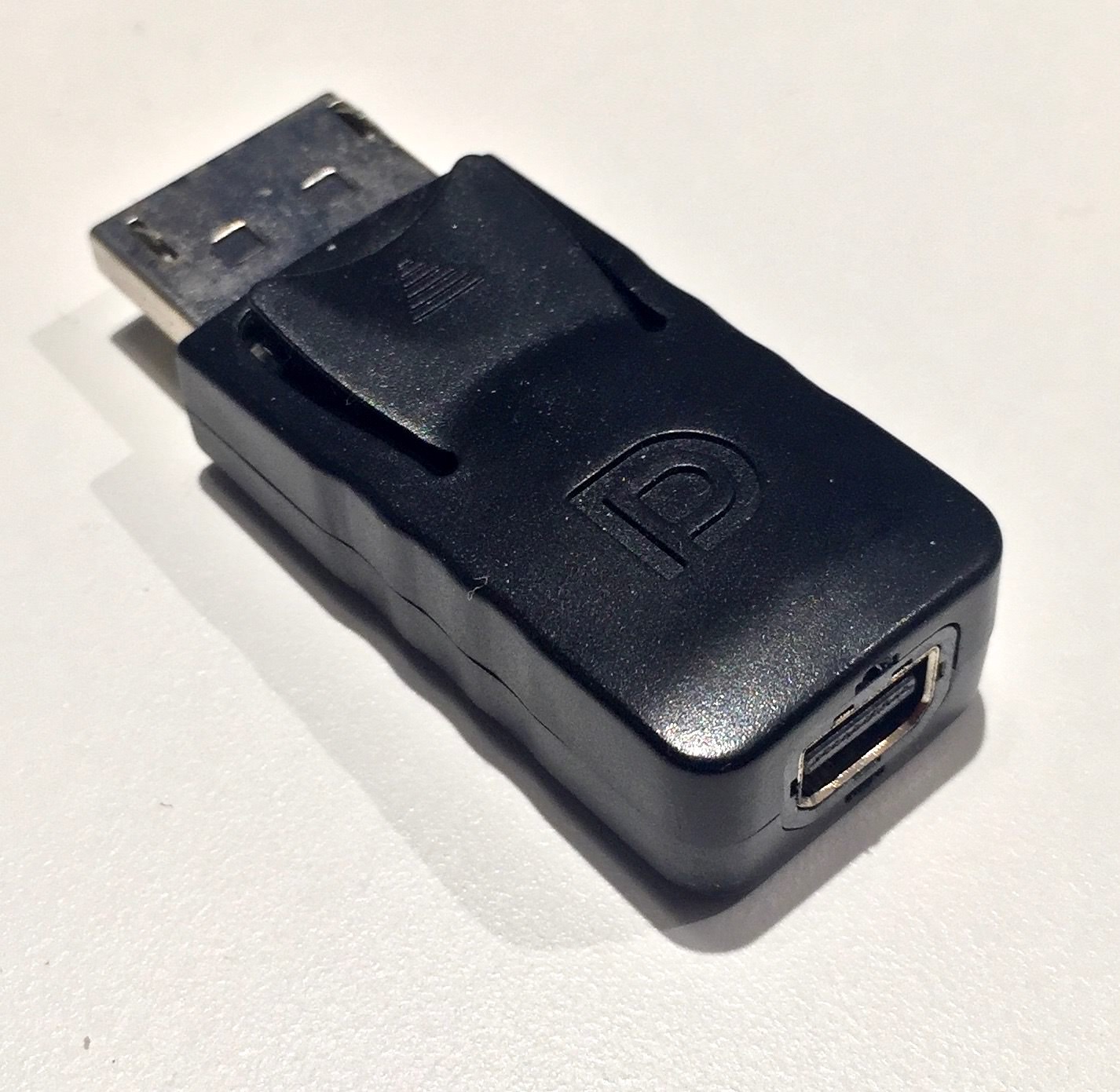

Anyway, when I using my 27" ACD with the 1080Ti, I use this adaptor. It's from China, about $1, work flawlessly.
Yeah! thanks a lot for your help, I will order this adapter so i can use second GPU as my screen display.
