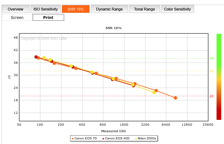

Since this thread is still going and DxO has again reared its ugly head, I'm going to return to the chart OreoCookie posted on Page 1. It occurred to me shortly after my last response that his chart was probably the "screen" comparison, which completely brackets out the issue of resolution. Indeed it is. The "screen" summary is an abstract and artificial construct with no basis in any practical application of interest to photographers. The tab you want to look at on the SNR (signal-to-noise ratio) option is the "print" tab, which takes resolution into account; that is, it normalizes the output from each camera.
When you look at this more informative tab, you'll see that the 40D doesn't fare as well and that the 7D is the frontrunner at higher ISO sensitivities.
Here's that chart:
It just goes to show that you can't separate one little factor in a camera from the others and get anything meaningful out of it. If the OP is shopping for a camera, he needs to have a wider scope than "high ISO" in order to make a good decision.
I haven't seen this one, it could have saved me quite a bit of time ;)
In all data points but the last two, the 40D is slightly better. In the last two, the 7D beats the 40D by 0.5 db and 0.9 db, respectively. This corresponds to an improvement of 6-12 % at these high ISO settings. At lower ISO settings, the 40D is better by the same amount (0.5~0.9 db, i. e. 6~12 %). (I'm sorry to be so nitpicky, but I'm a scientist, I like numbers ;))
The 7D's improvement is that you can use your camera at much higher settings, although if the 40D were designed today, the graph suggests that this were easily possible as well.
