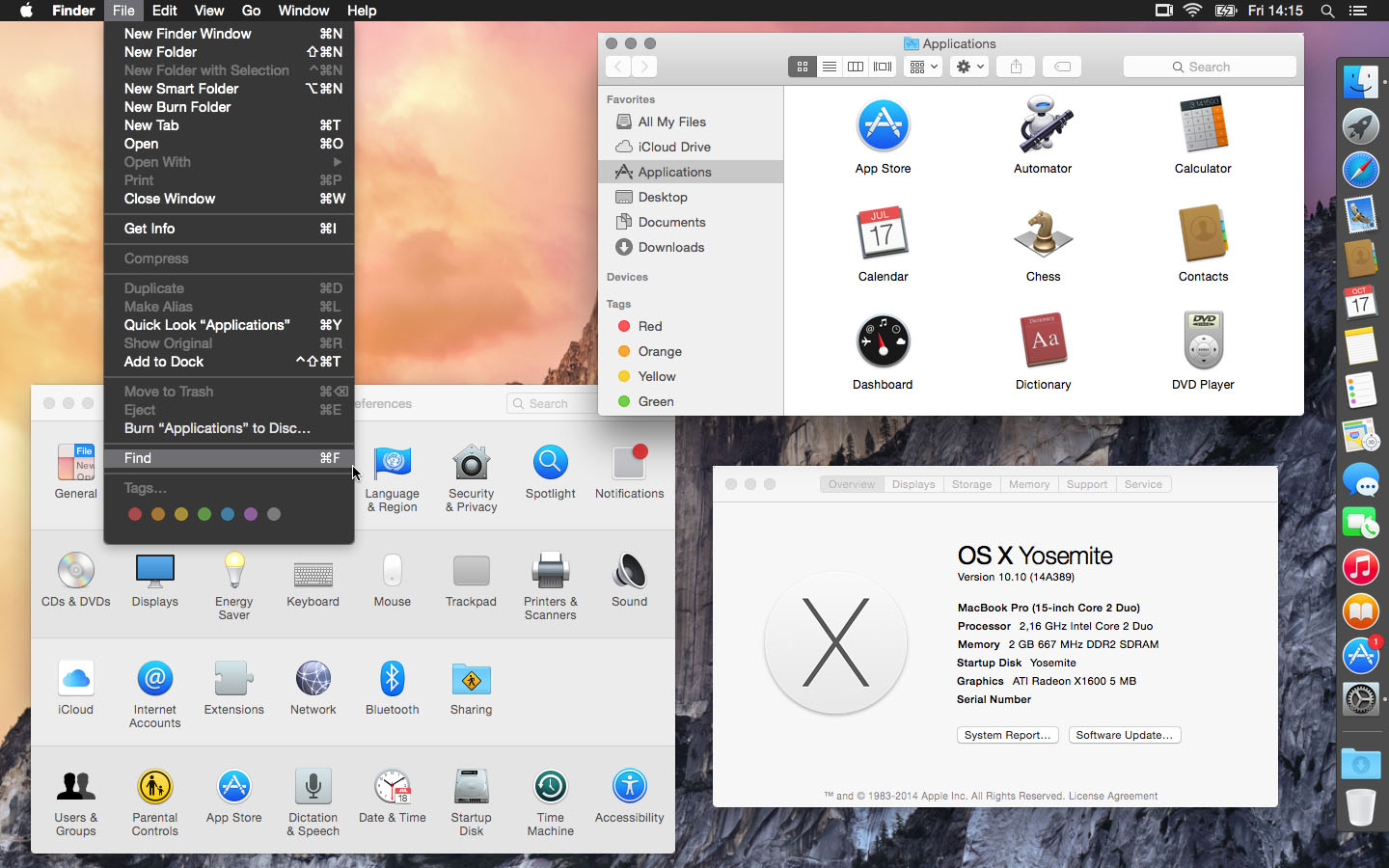

The dark mode looks somehow not bad on unsupported Macs without graphics acceleration. If you change the appearance (in System Preferences) to Graphite, dark menu bar & Dock as well as Highlight color Graphite too, then it looks quite decent and remembers a little bit at NeXTSTEP ....
nah, nothing compares to the NeXT GUI ;) owning a bunch of NeXTcubes myself, I still am very much in love with the old 2-bit greyscale GUI. it so was not distracting from the content or work on the screen. BTW: the Dock needs to be placed vertically on the right border of the screen :)
Fixed ... ;)

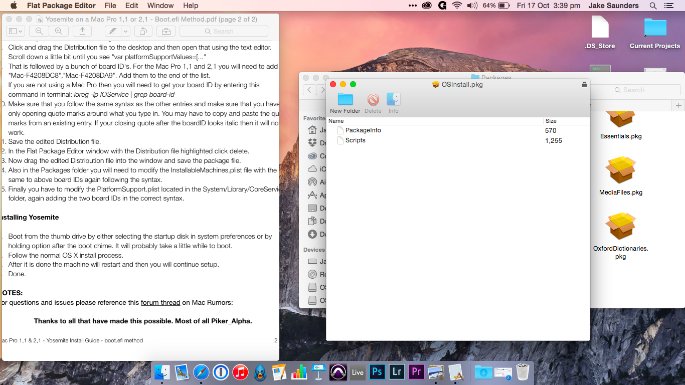

When editing "Distribution" and PlatformSupport-plist, are you ABSOLUTELY sure you didn't use curly quotation marks such as “”〝〞? If you are ABSOLUTELY sure, make ABSOLUTELY sure AGAIN. More likely than not, that's the reason it isn't working for you. Some editors add such quotation marks by default, even if that isn't your intention. The quotation marks MUST be straight: ".
IT WORKED!!! :D
Turns out that was the problem. I was absolutely sure but yes I made absolutely sure again. ;) Textedit added a curly quotation at the end by default for some reason. I indeed replaced the last one by straight quotation and....here I am posting this from Yosemite! :cool::cool::cool::cool:

fwiw, I think the xar option for editing the Distribution file is an easier (and faster) solution than FPE.
