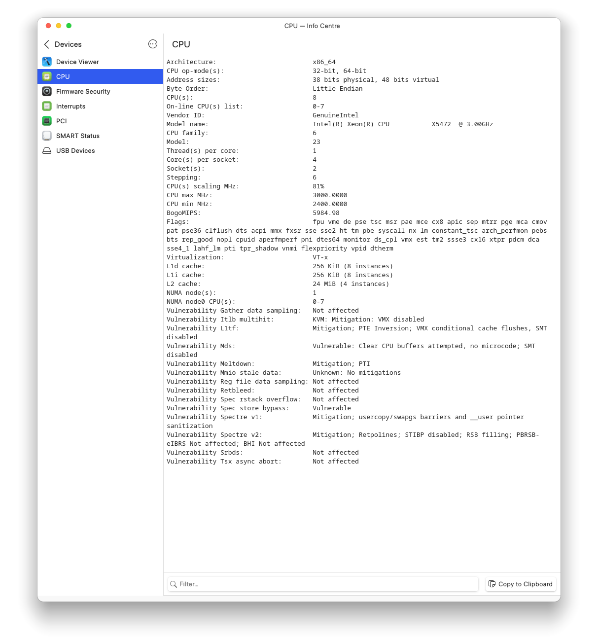

VMX/VT-X support is only available as from the Westmere CPU.
This precludes the MP31 (Penryn), MP41 (Nehalem) as well as Nehalem CPU MP51 (some have this).

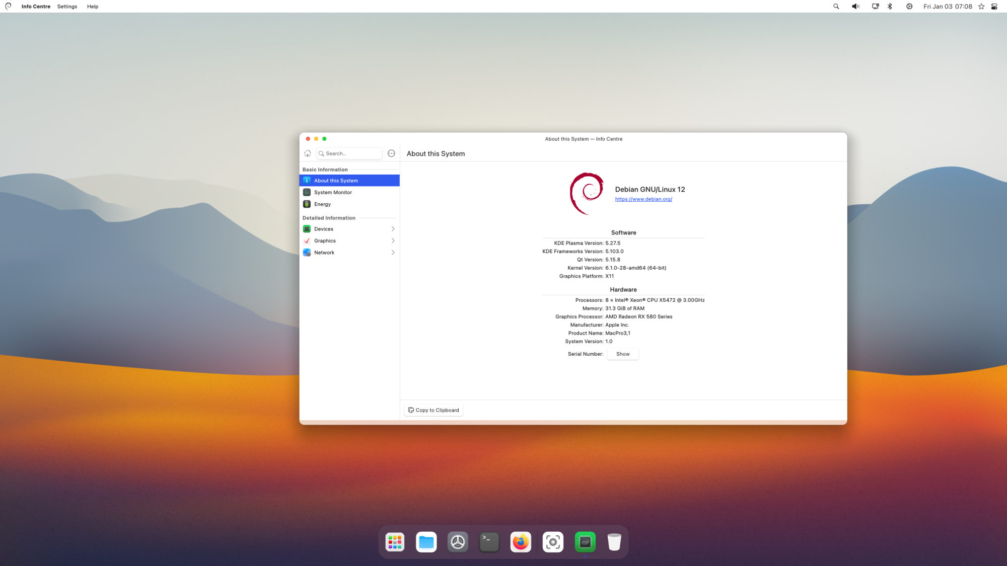

Turns out this was inaccurate. VT-x is available on MP31 as long as not booted via Mac OS.
Note the additional CPU flags. This is on Debian:

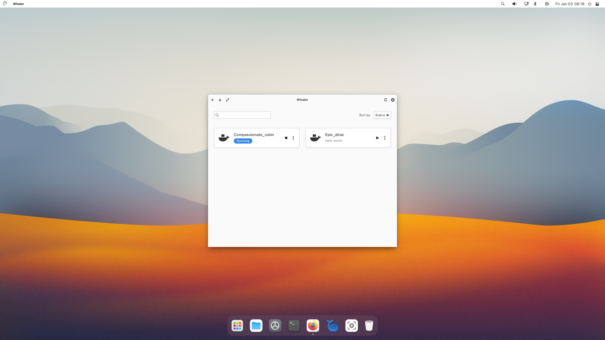

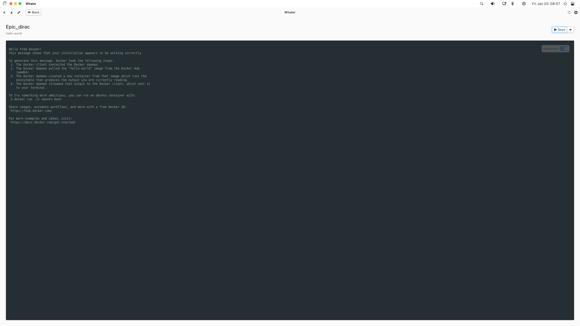

So, for instance, while Docker cannot be installed from Mac OS on MP31, it runs just fine, up to the latest v27.4.1 version of 18 Dec 2024, from Linux:
