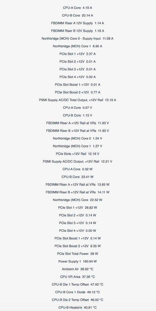

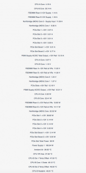

Attached is more detail on the sensor report. The current and the wattage on CPU-A Core is much lower than CPU-B Core.

Anyone think my low voltage on CPU-A Core is a sign of a bad CPU? I can get a replacement on Ebay for $25.

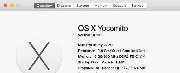

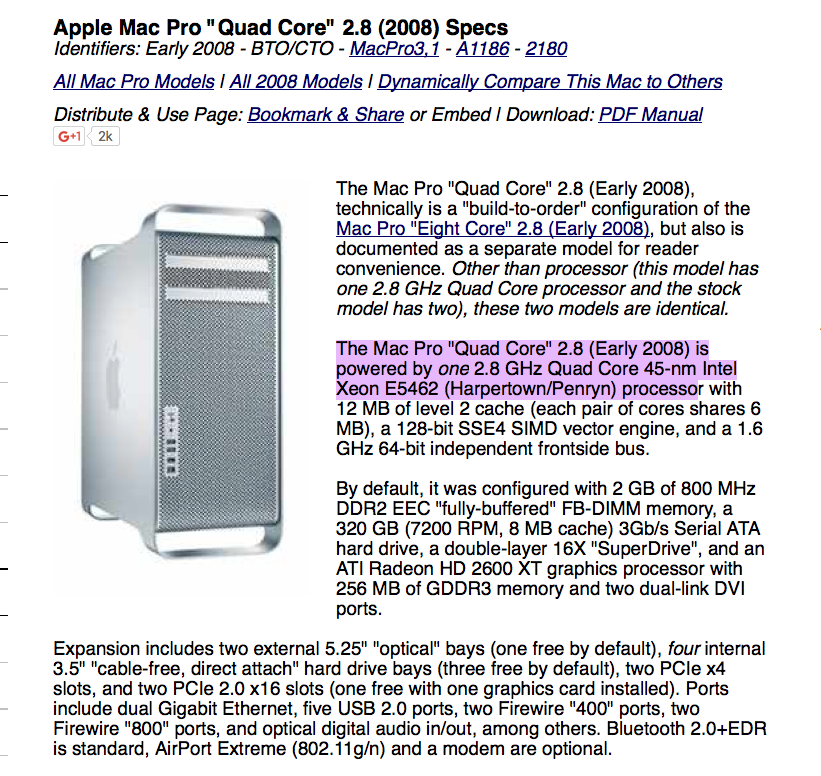

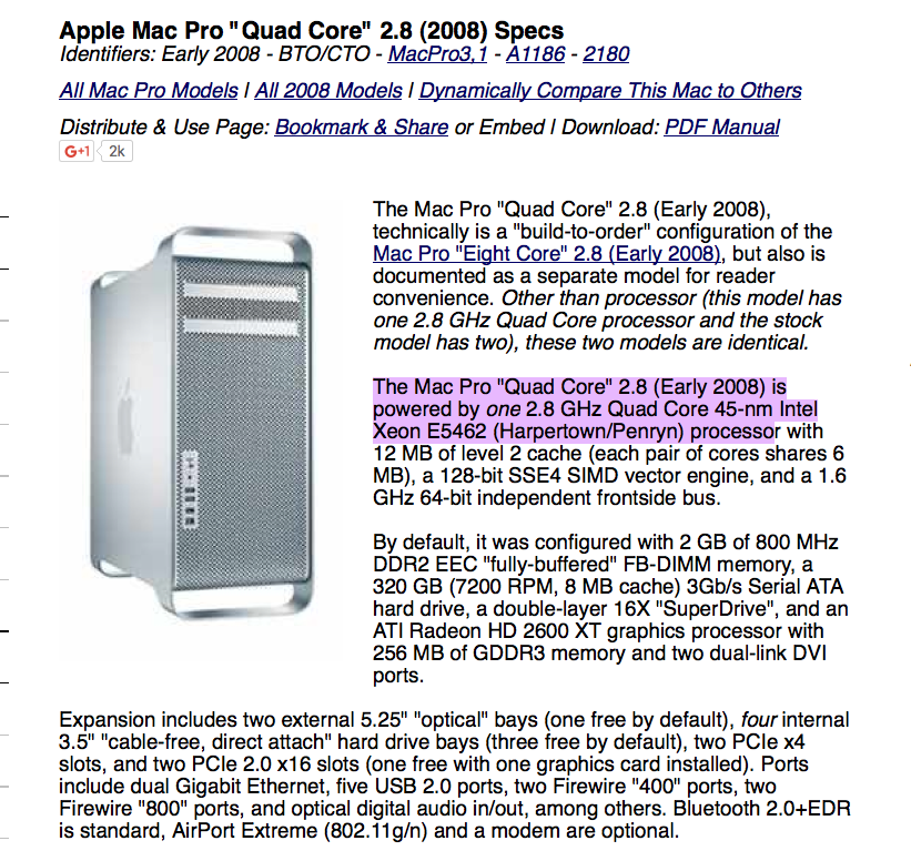

I do only have a quad core as show in the attachment. Is CPU-A just the empty socket? if so, I guess that is not my issue?

I have the same issue, running TechTool Pro 8 and getting the fail message on CPU-A Core for the 0.07V. Has anyone determined what the remedy is for this?

I special ordered one of these quad core models in late 2008 and am just now running TechTool's sensor test. I got a voltage sensor error...I suspected an erroneous error was being reported about CPU-A only getting .07volt. All 4 cores showed running fine when doing CPU tests. Thanks for the heads-up, with your post! It just makes sense once you realize that Apples never installed a "CPU-A" at the assembly plant.
