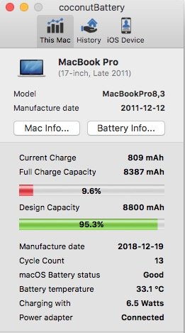

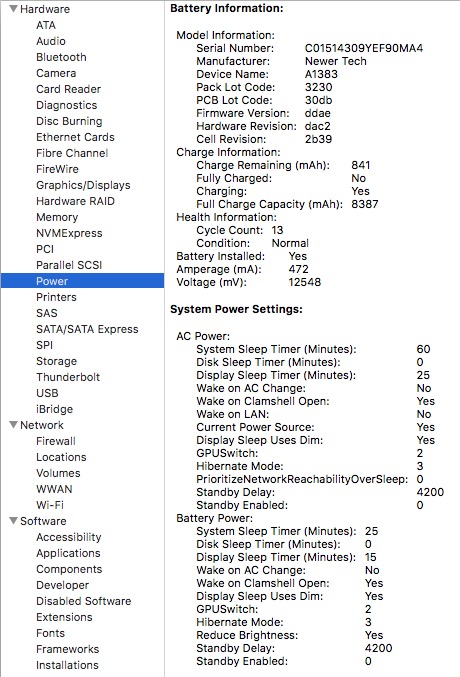

In March 2019 I replaced the batteries on our 2009 and 2011 17" MacBook Pro's.
They are NewerTech bought from OWC, and when first installed they could run on battery for a respectable time.
Both 17" now have the same battery stamina issues - they'll run for about 20 minutes and then shut down completely without any low battery warning.
The battery level is around 70% at the time they shut down, and when the power is reconnected and the computer started, the battery level shows 0%, and slowly climbs to around 50% and in a short time shows 100%.
The cycle count on the 2009 is 40, and on the 2011 its 13 - they are both predominantly used on power.
I did a SMC reset on both and no change.
These NewerTech batteries didn't last anywhere near as long as the original batteries, so should I look at buying replacements from Apple, or do you recommend something else?

This usually happens when there's one or more shorted cells in the batteries. Your best option is just to replace.

It isn't the caps and yes they are indeed Tantalum. Recallibrating the battery will not bring it back to life. It is probably just a shorted cell in the battery itself, which also explains why you get no notice from the OS right before the power cuts out.

I ran my wife's MBP completely down on the battery about 8 times, and it can now run on the battery for about 1.5 hours compared to 20 minutes before doing that.
The OWC could go well over 3 hours when new - I think us using it almost permanently on mains power is shortening the life of the batteries.
