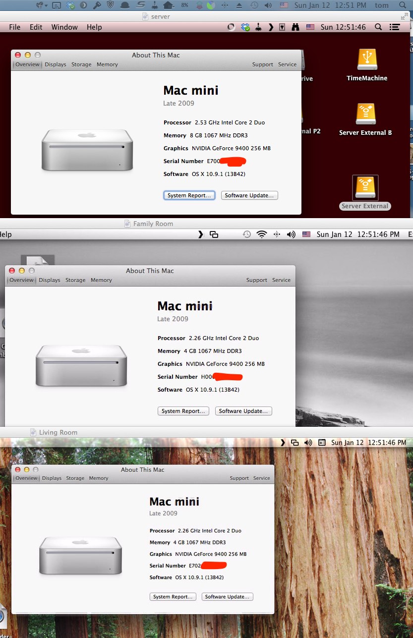

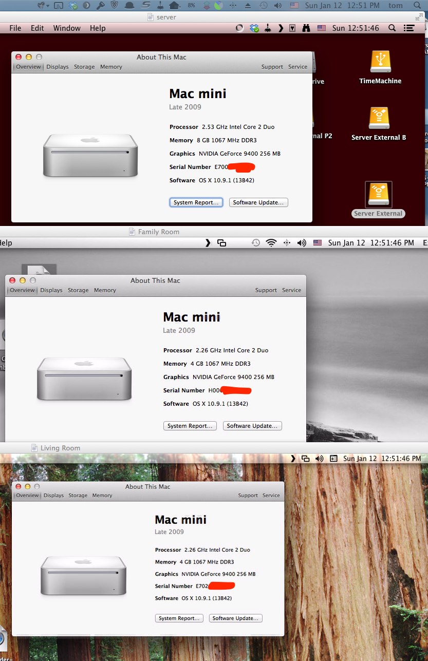

I don't know what October 24 has to do with anything. And I posted "high praises" in this thread in November. I've got 3 late 2009 minis, one a server model and the other two base models. They have all been upgraded with 2x RAM (8GB on the server, 4GB on the others) and and SSD on one of the base models.
One base mini went through most of the Mavericks seeds, and indeed there were several seeds which would grey screen attempting to install, but the release 10.9.0 installed with no problems. The second mini went from Mountain Lion to 10.9.0 with no issues. The server just two weeks ago went from Mountain Lion + Server 2.x to 10.9.1 + Server 3.0.1 + VPN patch with no issues.
I could tell no speed differences with the base minis which are used only for Plex, iTunes, and Safari. The server became noticeably quicker with file sharing, and far more reliable with maintaining connections for Contacts and Calendar servers.
The only way you can prove me wrong is the screen capture your system log as of today which will time stamp from October 24, 2013 to today everything your MM has gone thru. If you can't just proves what I'm saying.
I'm sure that you had problems, and sure that I did not. I don't know what the log files would "prove" but I've attached a screen shot showing all three minis' "About This Mac" viewed simultaneously with Screen Sharing (which also works better than it did under Mountain Lion).
