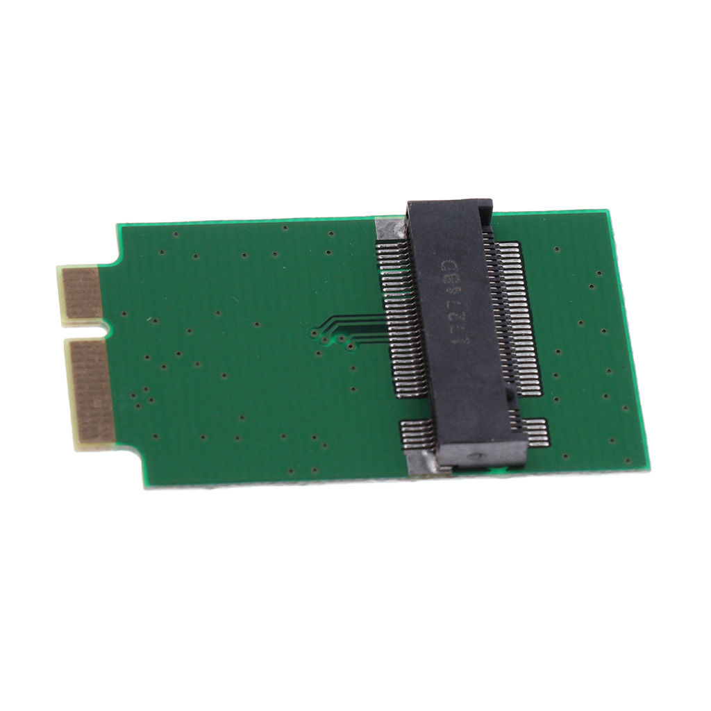

Ok, so as I understand it, the Late 2010 MacBook Airs used SATA SSDs.
Should this Sintech adapter and this Crucial SSD work to help resuscitate an old 11-inch 2010 MacBook Air?
Would prefer not to resort to an Aura 6G Pro or whatever as they're awfully expensive compared to this solution.

I have never heard of those Sintech adapters being used in a 2010-2011, but I guess if you bought a SATA drive (NOT PCIE/NVME) it could work.
The 2010 and 2011 Air use the same connector. They are both SATA. However, there are only a few aftermarket drives that will fit it.
Here's a weird fact. You could get either a Toshiba or Samsung drive with the 2011 Air (from the factory). The computer has a 6gbs SATA controller, however both drives were limited to 3gbs!
Sandforce drives had link speed auto-negotiation issues with the NVIDIA chipsets (MCP79 (?)) but those were only found in the 2010 Air and Pro, and 2009 Pro. OWC patched their drives to fix this, and so did OCZ.
The 2012 drive was a weird one, it's the only year that used that connector. In 2013+ they used a PCIE connector
Back to your situation...you need a drive that works with the 2011/2010 MacBook Air. That leaves you with a few choices:
OEM Apple drive from eBay, iFixIt, or some other used market (256GB is as big as they go)
OWC (they have drives up to 1TB, are known to fail but have a 5 year warranty)
Transcend Jetdrive 500 (up to 960GB)
There's probably one or two that were released that I'm forgetting. But this is a 7 year-old computer so good luck finding any parts that old because so few were made.
So I couldn't wait any longer for controller advice to buy the SSD. I'll trial and error my own findings but I think it will work, atleast theoretically it can. I bought a $140 1TB WD SSD that has a different key setup with a $10 adapter.
This is a much cheaper approach than the ridiculous $400 1TB OWC SSD with what has already been proven to have poor controller performance with their crap Sandforce controller. So I think this setup is much cheaper, faster and a better, more reputable brand.
https://www.newegg.com/Product/Prod...cm_re=wd_blue_nand_1tb-_-20-250-092-_-Product
https://www.amazon.com/Sintech-Adap...coding=UTF8&psc=1&refRID=TN35F971W1MKPB0XDE2R
http://eshop.sintech.cn/m2ngff-ssd-adapter-as-ssd-of-20102011-macbook-air-p-1062.html
and I bought this one...
https://www.newegg.com/Product/Prod...wdFLDckZFcPhcenDjD0aAt8dEALw_wcB&gclsrc=aw.ds
So, did this work? There's already 6 reviews on your second link that say they've been successful with that adapter and an ADATA SU800 256 GB..

I have the 2010 MBA. I just bought a generic short adapter (5 for $3 or something on eBay) and coupled this with a cheap ADATA SATA drive. Works well but you are limited to SATA II on the 2010 MBA, so max read/write speeds of about 250MB/s.
the adapter looks like this
I've installed the WD SSD with the Sintech adapter and it works fine. the only problem that you will encounter with these SSD's attached to any of the adapters below is that it raises the SSD off the adapter to create an overall thicker unit.
So you will notice that the belly pan of the MBA doesn't close as easily. I very carefully tried to create a slight divot or depression in the pan by hand to compensate for the SSD and to not have it press into the motherboard too much when the pan is fully screwed in and closed. But the pressure isn't too much to be honest and you can fully close the bottom pan and save $260 instead of buying the OWC SSD with their crappy Sandforce controller with their throttled down 3GB speeds.

...so theoretically you can use any one of the 3 pronged popular M.2 mSATA SSD drives from any of the more branded names and with the Sintech Adapter for sure it will work.
