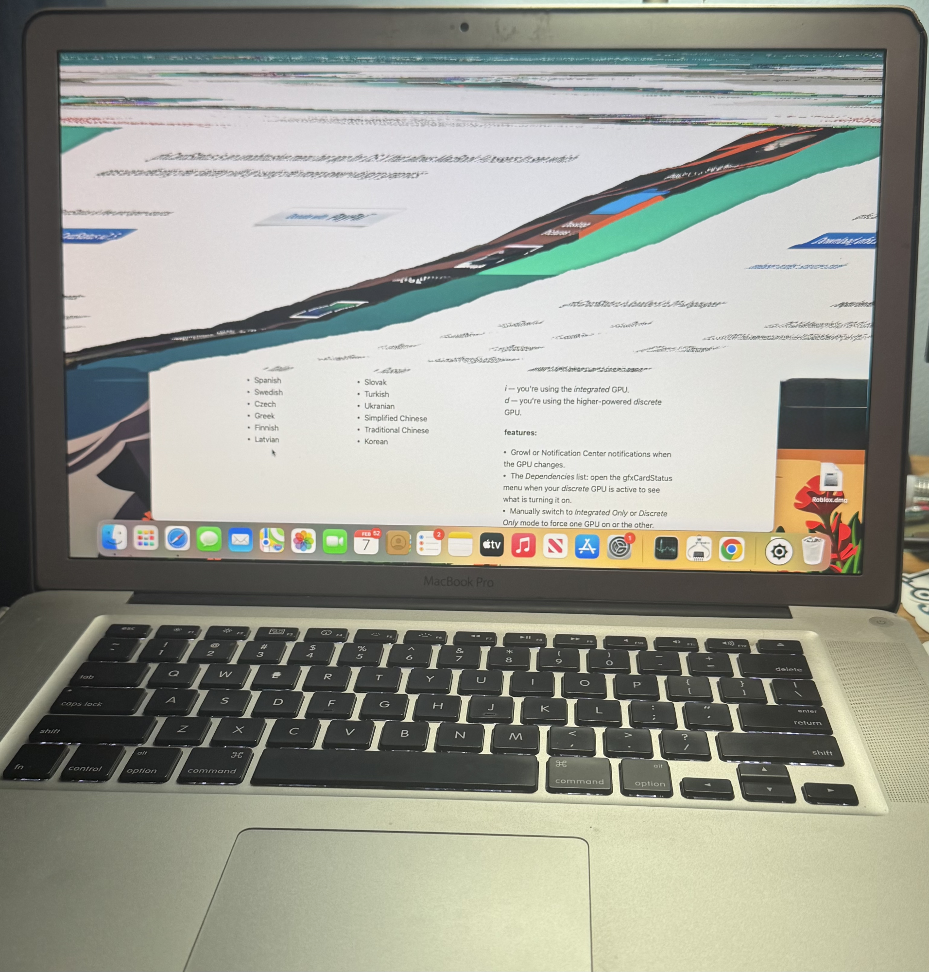

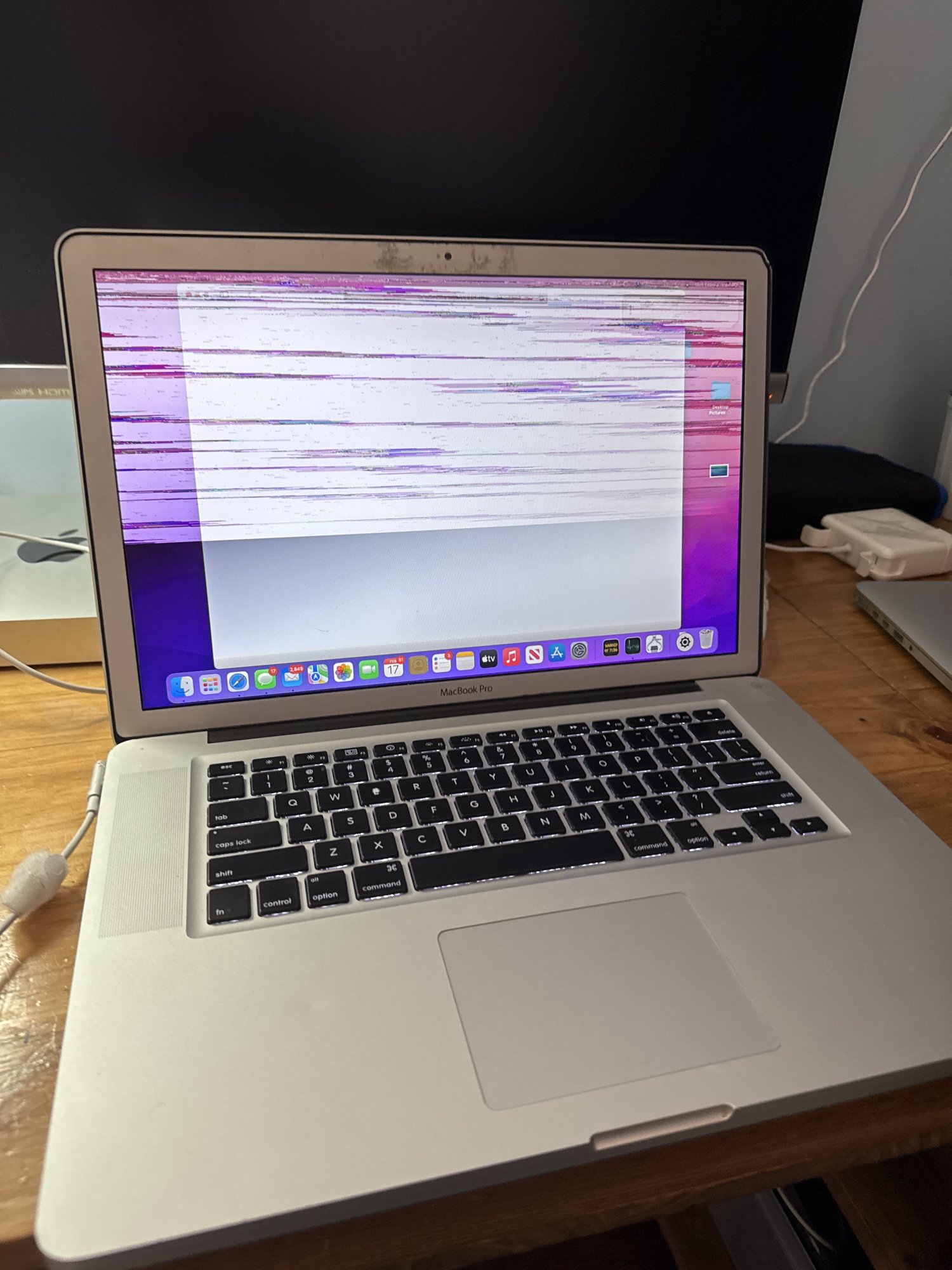

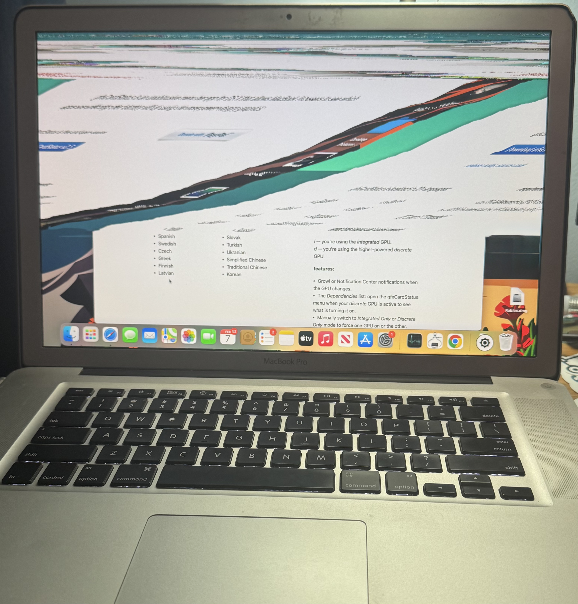

I have a 2.88 I7 model with Nvidia graphics and it randomly kernel panics or freezes in random spots or does the 3 beep chime when running. It is a really nice laptop for at home use or movie watching but it makes itself unusable when it crashes for about 15 minutes. Then it Will either fail to boot and just have the front white light on or it boots and runs for a few seconds before either artifacting the screen and freezing or kernel panicking. I tried the graphics switching apps and it still overrides it and runs the D-GPU or it may be still on integrated. It usually freezes and prevents me from checking which one its using. Are there any solutions to fixing this or is this laptop toast?

Usually three beeps at startup indicates a ram issue. I know the chimes are while running but maybe try different RAM to rule it out.
Reactions: Parowdy
I swapped the ram with another set I have and it worked for a few seconds before freezing again and beeping after.
That's disappointing. Guessing it could be the GPU. Try disabling it.
Failing that, the GPU and/or the CPU may need to be reflowed.
Reactions: Parowdy
Would it be the whole GPU or is there something else because I read that these have a capacitor that can be replaced but I don't know if that would do anything.
At this point it is trial and error. There isn't any point in replacing anything because it isn't worth it to spend money on it. You could probably buy a newer machine for the cost of a repair of your current machine.
That's what I'm most likely going to have to do.😢 Its such a shame though because these unibody Macs design is incredible.

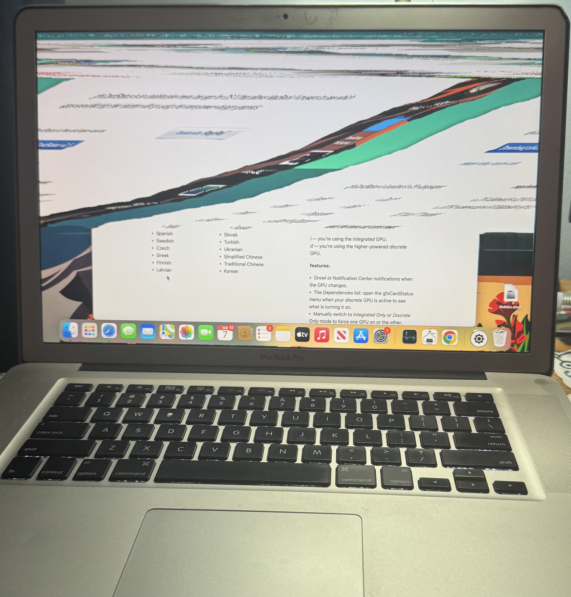

If the graphics switching apps aren't working, try this one: https://dosdude1.com/apps/MacBook Pro dGPU Disabler.zip
And if that doesn't work, disable the GPU via code by following this pretty straightforward guide: https://dosdude1.com/gpudisable/

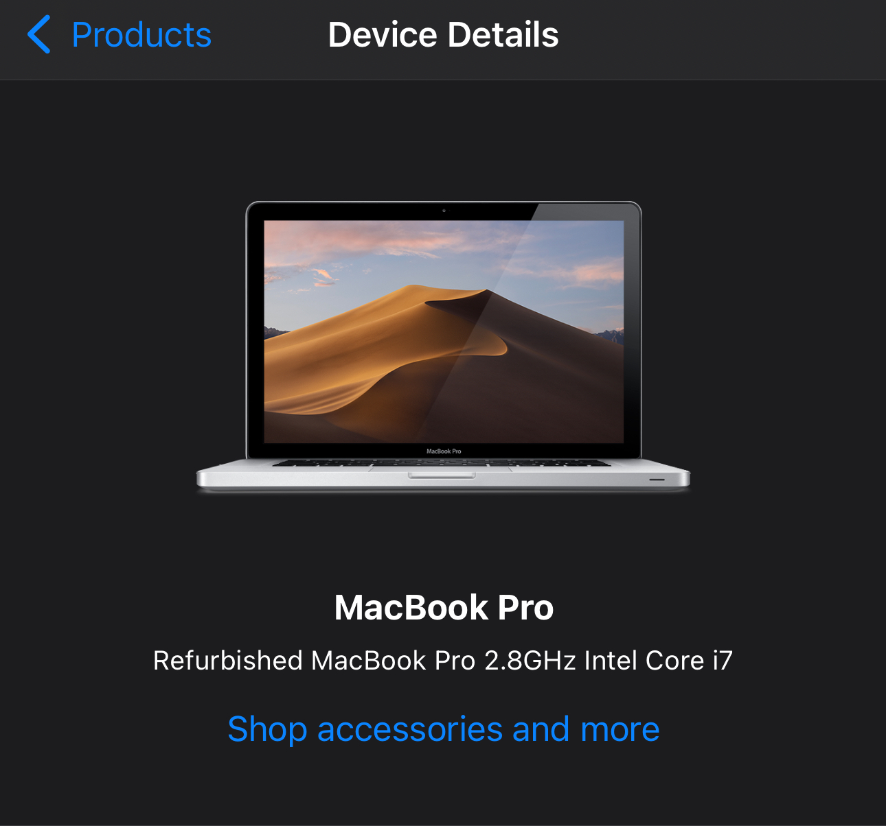

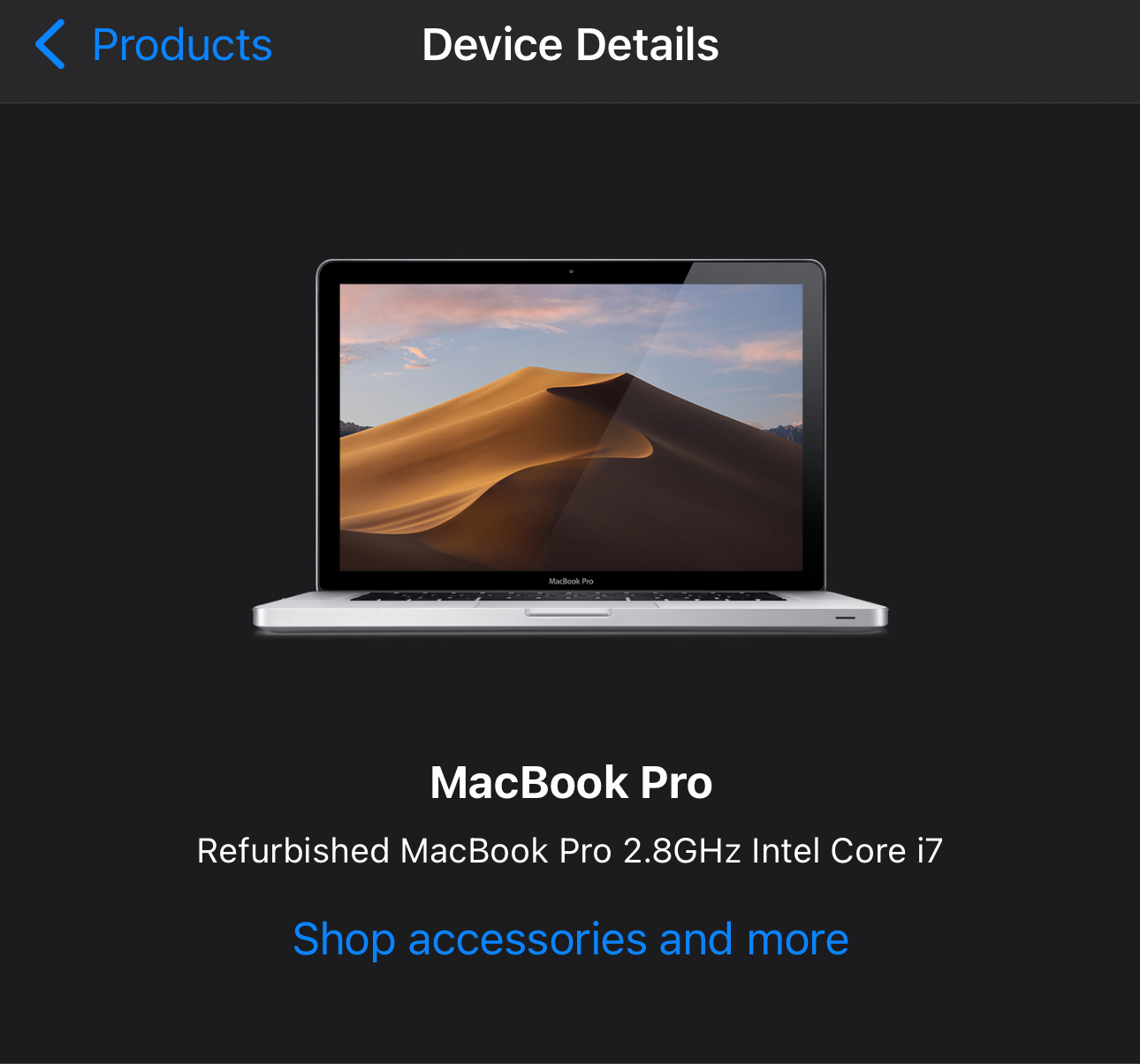

You say that model is an i7 2.88 mid-2010, but the highest speed of the i7 that year was 2.66. With a GForce GT 530 512MB graphics card, it was that i7. That seems to be a graphics issue. I have the Pro mid-2012 and it's never had any issues; it works great after 13 years.

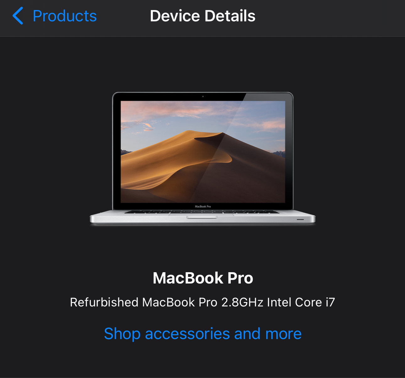

The one I have has 2.88 because it was a later, higher tier of the 2.66 but it was configure to order. Mine is also technically a refurbished one. I bought this off of eBay a few years ago. It has the 330m in it. I’m glad your 2012 works well. I had a retina one for a little bit that made a popping sound and never turned back on with a display.
Was telling you this because the graphical glitches appeared on the 2011 MacBooks. The glitches were gone in the mid-2012 models. Mine isn't Retina, it's the latest LCD (9.1). Retina came out a few weeks later. I wish you luck in fixing this issue. It's best to take it to an expert; the Apple technical service where I live is very expensive :-:
