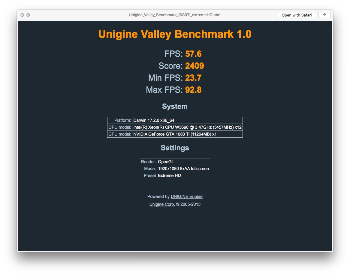

[doublepost=1544226940][/doublepost]This is my 1080Ti Valley result in my cMP, that's already with a 3.46GHz W3690.

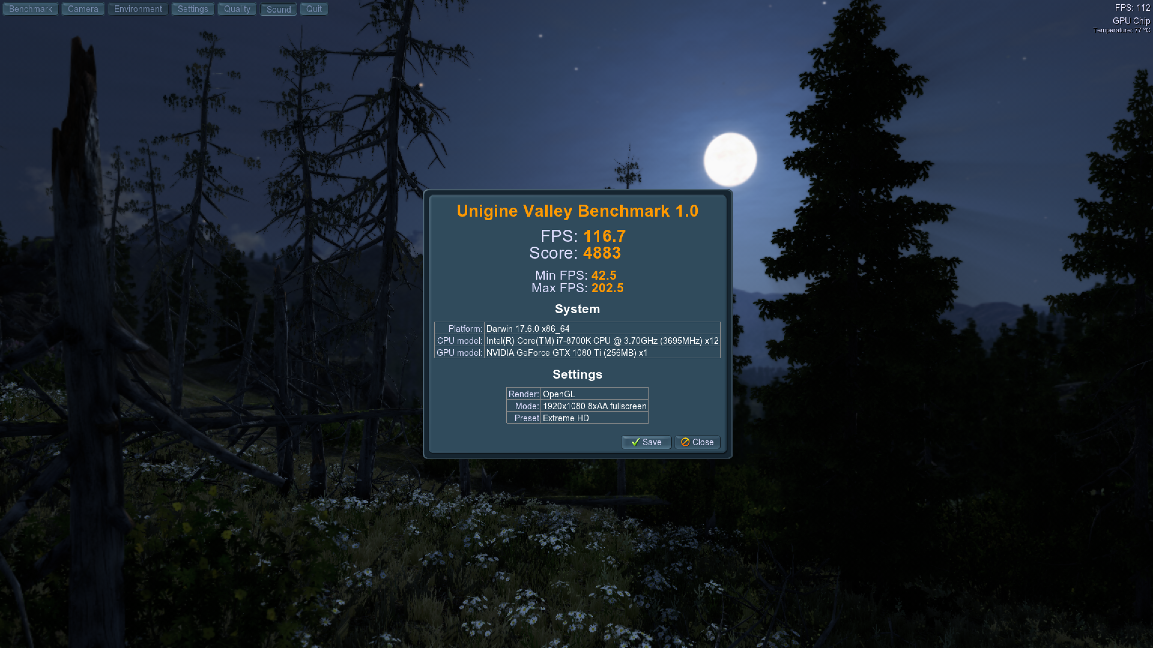

And this is the exact same card can do in my Hackintosh (8700k)
As you can see. The 1080Ti can only perform at about ~50% even with the Extreme HD preset. The power draw will be lowered as well, and the GPU will run cooler. With your 2.4GHz CPU, it will be even less stressful due to even less draw call will be made by the CPU.

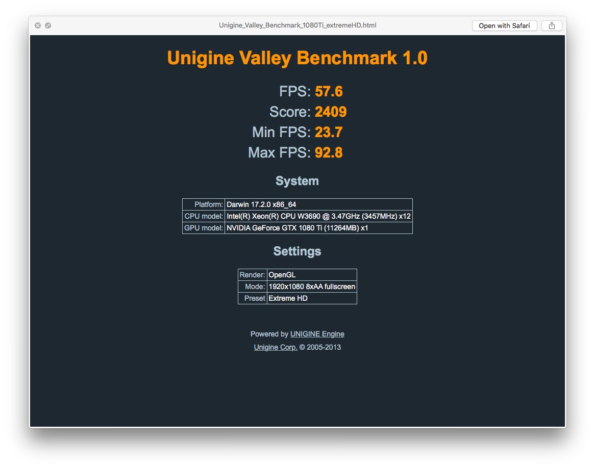

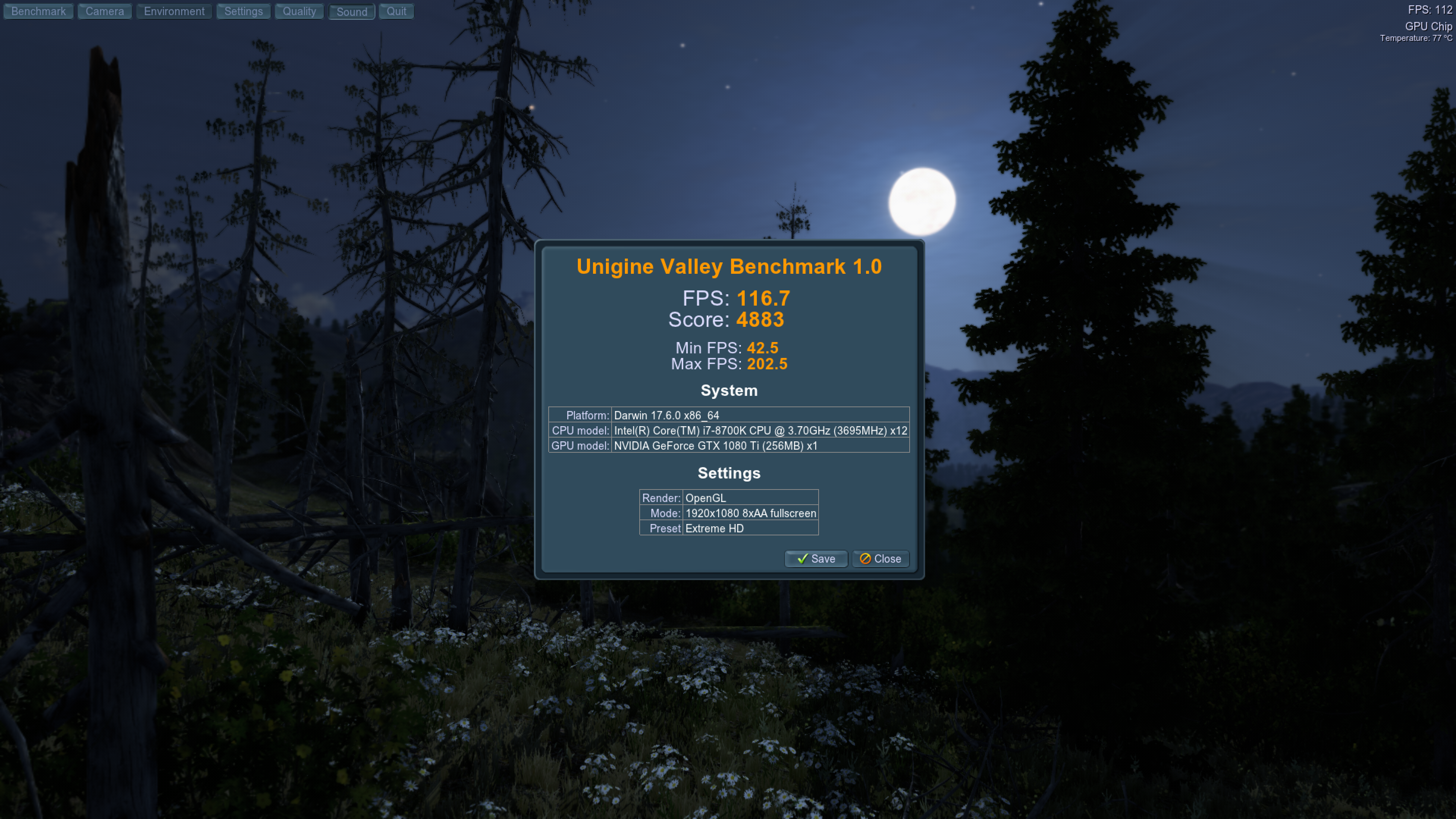

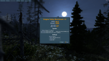

I made a typo.. it's actually a 3.46 ghz
[doublepost=1544230546][/doublepost]ALL IS GOOD EVERYONE, THEY'RE WORKING! 😀
They're just not spinning constantly... just kind of short low bursts
Here's my score:
