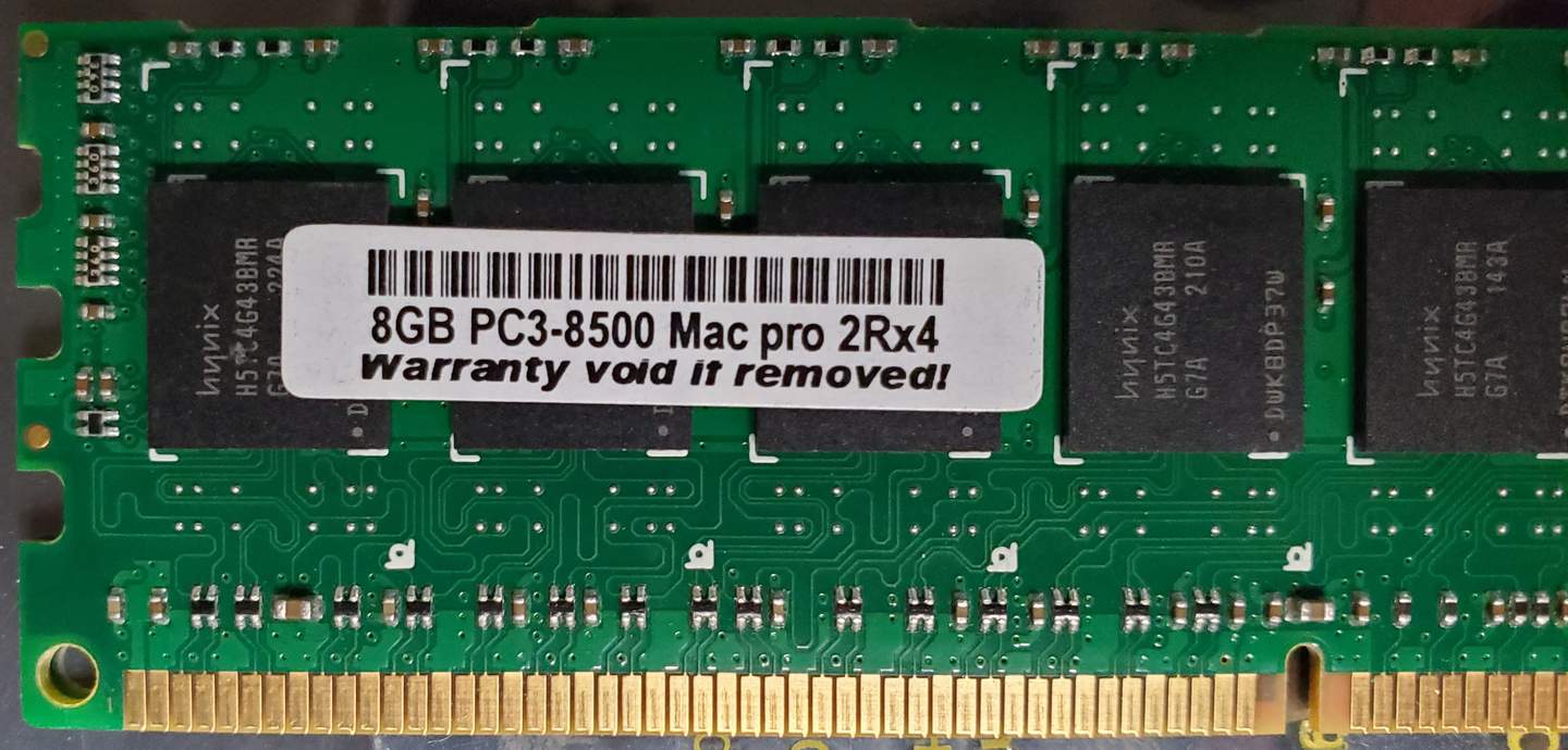

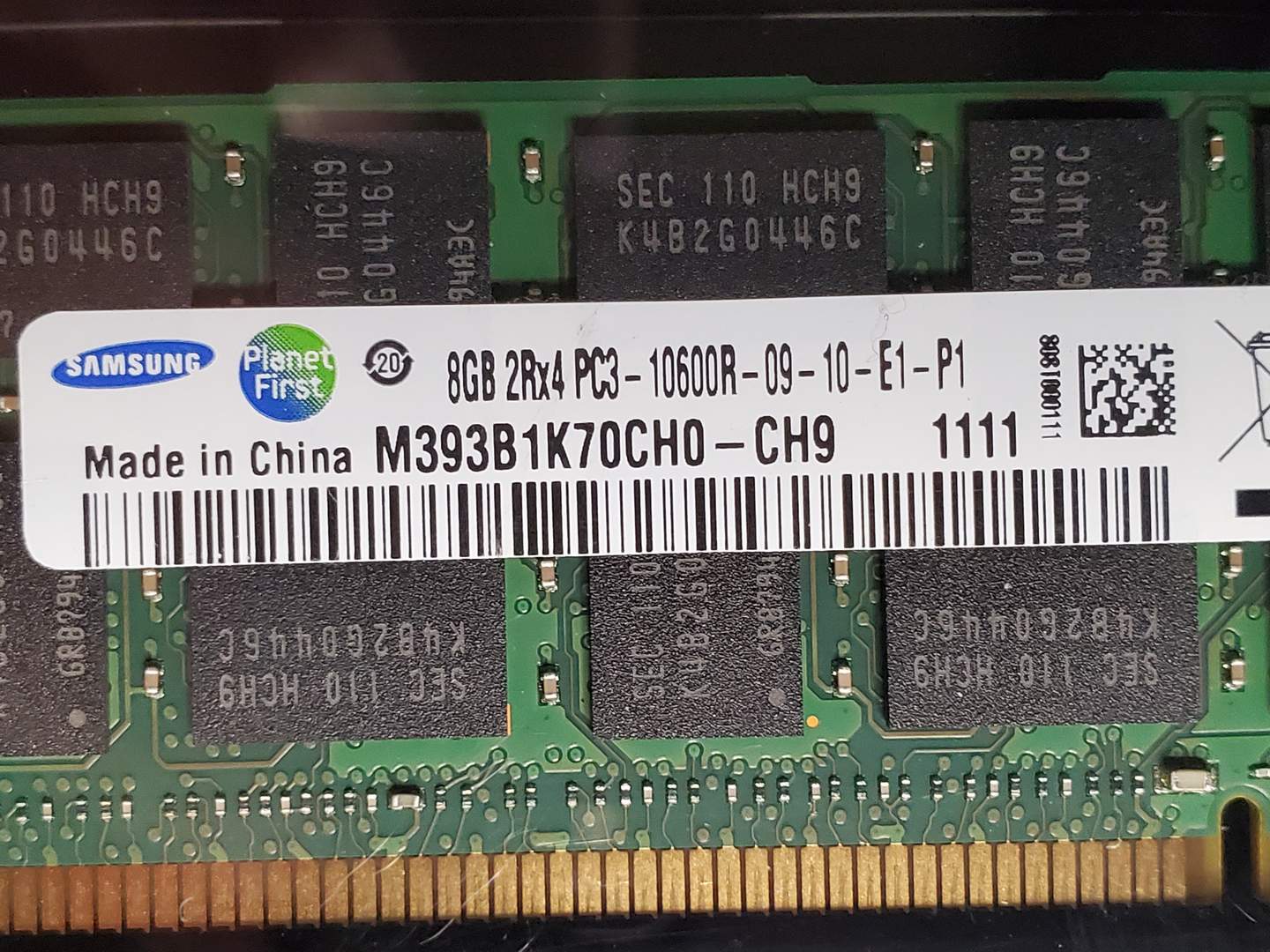

That sounds reasonable. Here are pictures, top is the original memory and bottom is the new memory. Can I assume the "R" after the 10600 stands for RDIMM and the lack of an "R" after the 8500 indicates UDIMM?
Since the label of the first one don't show any more info, upload a picture of the full DIMM, then we can see if it's UDIMM or not. RDIMMs also have a register controller CI.

I think I am going to order another set of 1333MHz memory. Each set of DIMMs works individually and they both work in either bank. This suggests the two sets of memory are incompatible with one another. I was on the fence if I should buy another set of 1333MHz but figured the performance gains, for what I do, were almost nil. Now I have a reason to buy them. I'll report back once I receive the second set.

I wanted to update this thread with the resolution. I ordered a second set of memory from the same seller and all is now good. There definitely was an issue between the original and the new memory which has been resolved with 8 sticks of the same memory.
