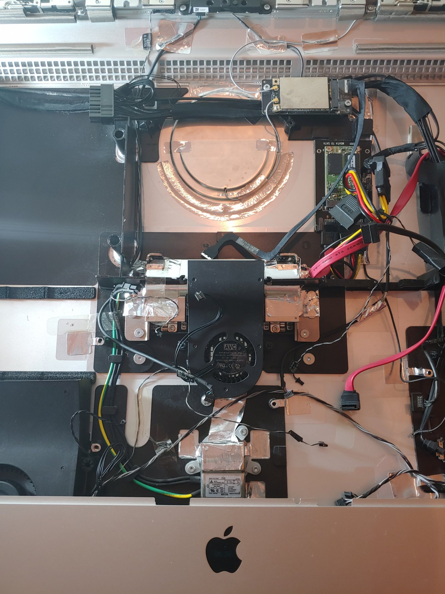

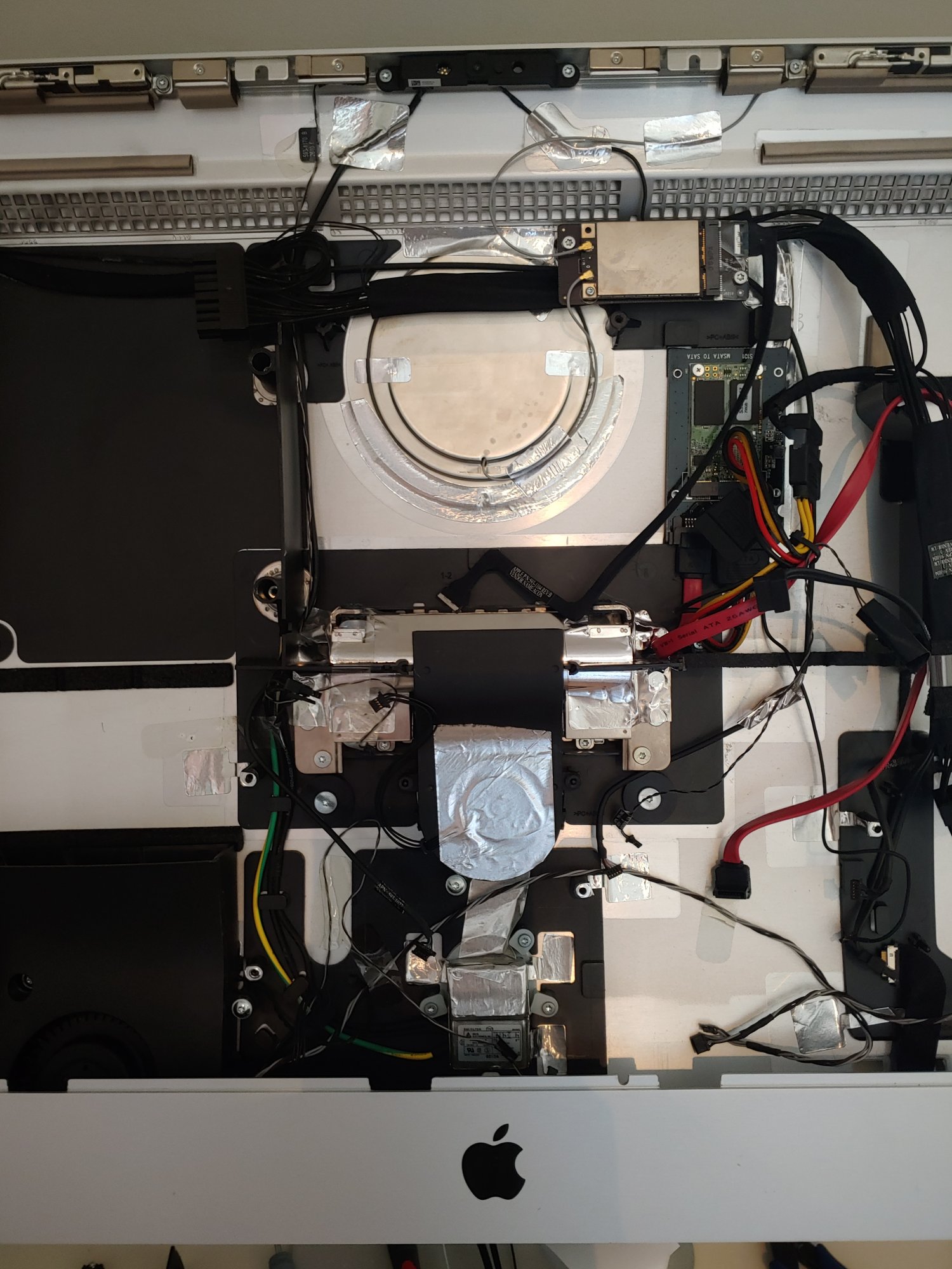

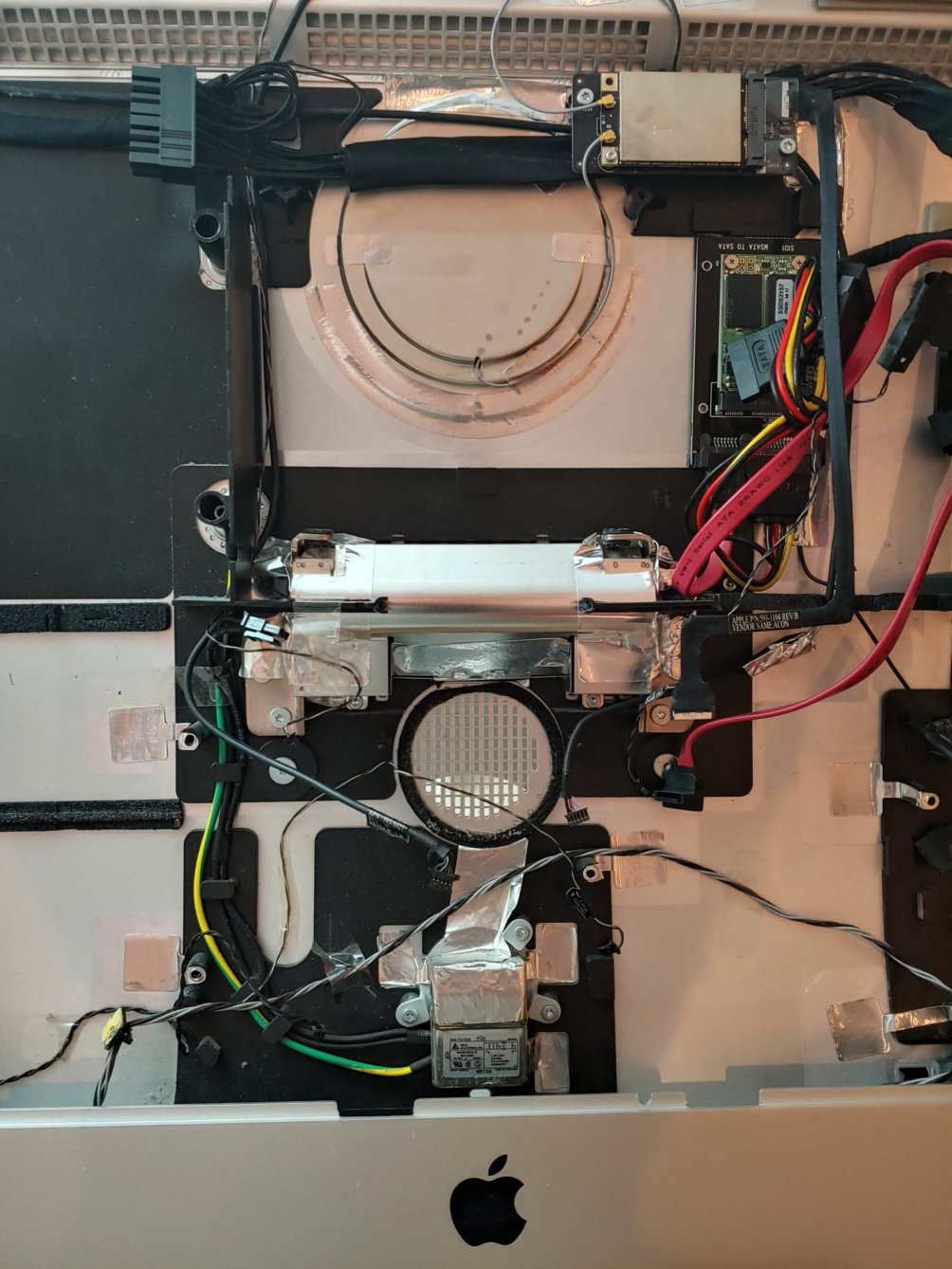

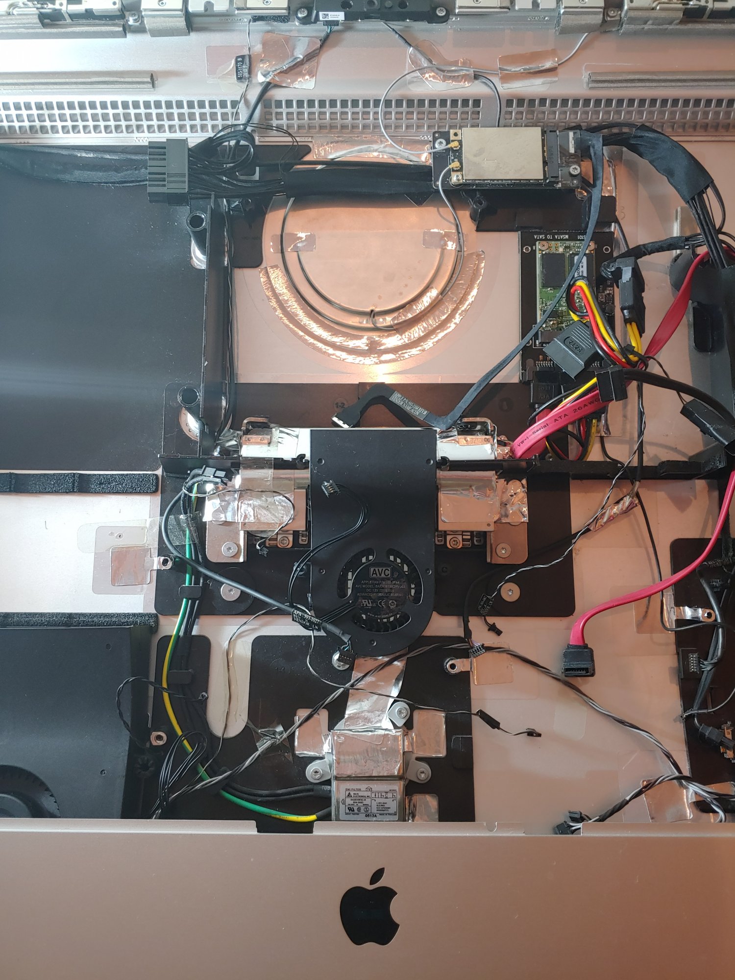

I dismantled each fan to do some deep cleaning but they were not that dusty even after 10 years. I doubt if cleaning alone would have lowered temperature by more than a degree or 2. However, I found a way to cut around 5 degrees C off my hard drive temperature. First, we observe that while the air flow is generally from bottom to top, there is an exception. The hard drive fan has its own intake vent.
The HDD fan blows both directly through hitting the main board and upwards. This is the reason for the HDD's high temperature. When the CPU gets hot the hard drive's temperature goes up, too. I am surprised the original HDD has lived for 10 years before failing in such a hot environment.
Now, I used foil tape to cover the front vent so that the incoming air can only go upwards.
I actually did that for all 3 fans. However, there is little need to seal up the CPU fan because it fits very snuggly against the housing with little room to leak air. If you do decide to seal it, however, you may need dryer-grade foil tape for that because the CPU is the hottest part of the computer.
