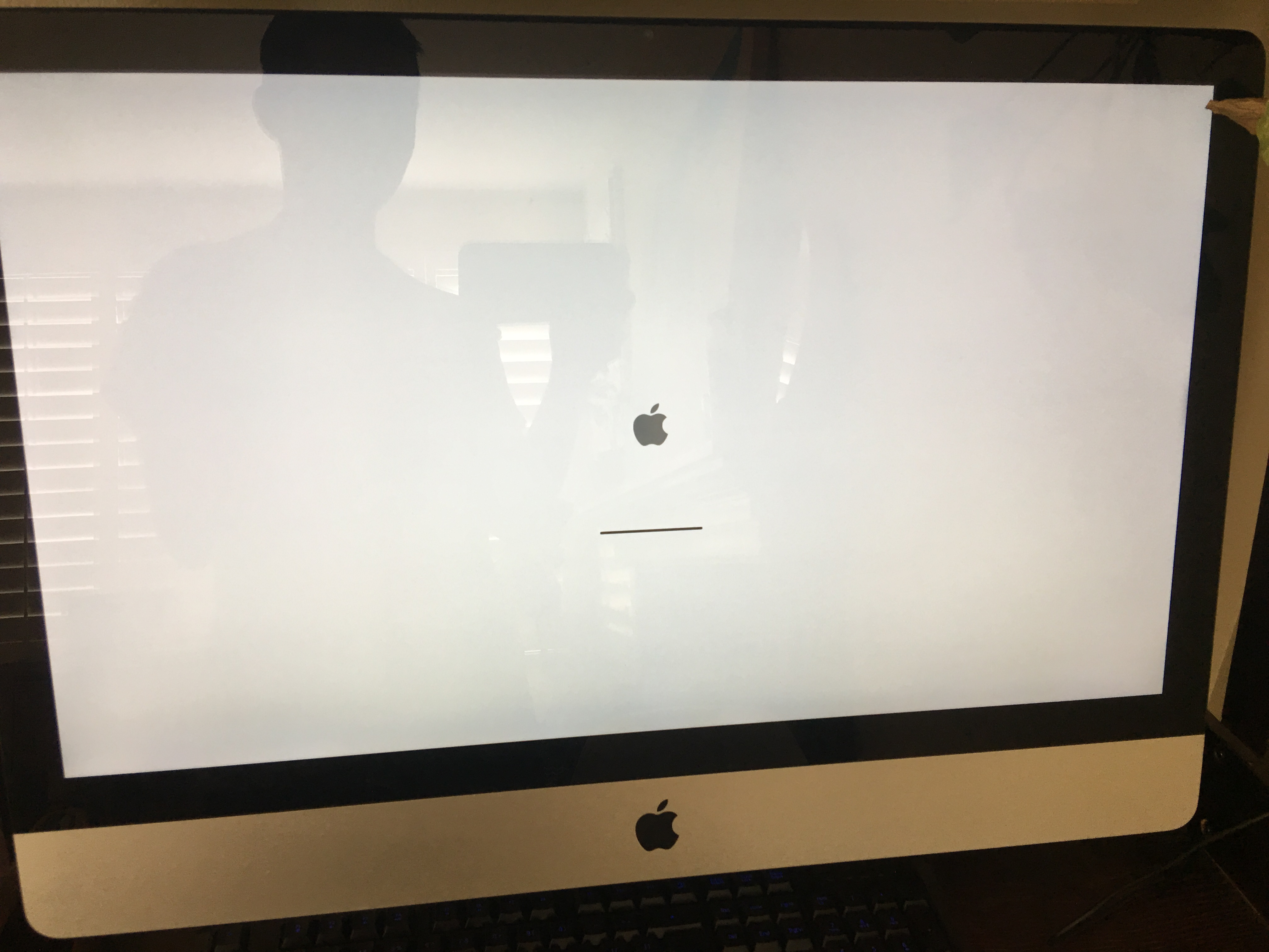

Thanks @Fishrrman. I followed your instructions and there was certainly progress! Once I erased the entire drive and went with HFS+ w/ journaling, I reinstalled LS but it took quite a while so I just let it run overnight. When I woke up this morning it was stuck on this screen so I rebooted iMac but it is still stuck on the "loading" screen (see image).
I tried rebooting the iMac again and it's still stuck on the loading screen.
Any thoughts on what I should do next? Much appreciated.

You might repeat the process, but this time:
1. Erase the drive with Disk Utility, but before going to the installer...
2. Run Disk Utility's "Repair Disk" function on the drive and see what results you get.
3. If you get "a good report", repeat the test 2 or 3 more times.
4. You want a good report every time.
The idea is to verify that the internal drive is still good.
Other than that, it could be something like firmware, etc...?
