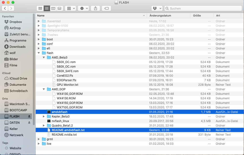

How to use the Linux boot stick with AMD cards?
Nobody reads my posts :-( If you want to use the Linux boot stick version read this post. You will find the files to be added to the USB stick and the commands to be typed in...except that you will most likely write the WX7100_GOP.ROM instead of the WX4150_GOP.ROM shown in the example.
Of course you can find my post on the first page and first post, too. It is hidden in the flash section.

Speaking of Linux steps, Lottosmp posted how to easily autorun scripts from the sd card. I've flashed several K1100m w/o any interaction required.

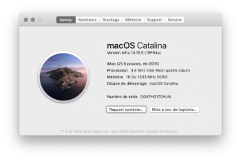

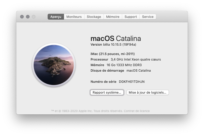

Bonjour,
I found a site to update the GOP of a graphic card (of the copy-paste practical), I used the last DELL of my card (K2100M) but I only have a black screen, oblige to reflash with Linux USB stick...
Attached capture of what I saw by "Remote Destop" (this one is modified by photoshop it is to make you see)

Unfortunately I see that my skills are too limited, I would probably settle for easier hacks next time. 😓

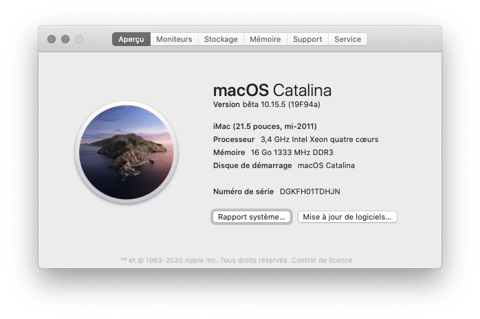

Bonjour,
You need at least a Mac EFI Gop not a PC Gop and it's maybe not enough.
There is a K2100M bios which works already, why not using it?

You can too inject AppleBacklightFixup.kext in /L/E and not using OpenCore maybe, i have not try but it should work.
I have Windows 10 which takes advantage of opencore to boot in UEFI and also of its patch of Brigthness + DSDT patch, at worst and I already did it, I unplug My SSD. 😅 😉
