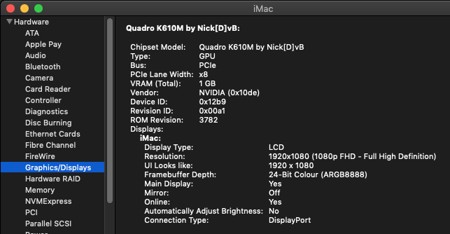

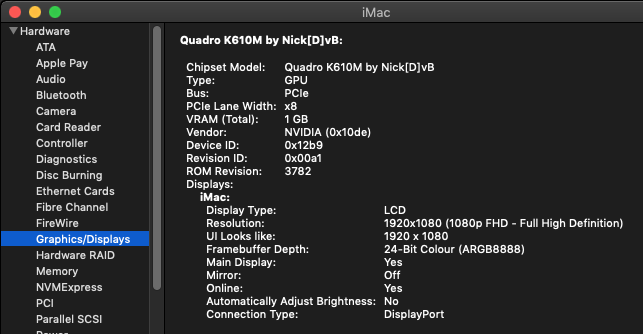

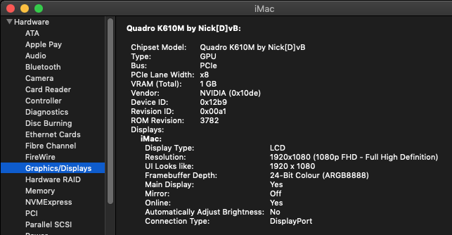

It's working!!! Thank you very much for your help. It's greatly appreciated.

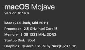

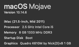

I'm just wondering if I've got the right drivers (Mojave).
Thanks for your help! Drivers for Kepler cards are included in the macOS Mojave and Catalina. No need to change things here. Please run the Valley benchmark using (1920x1080, medium, no AA) and upload here...

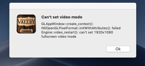

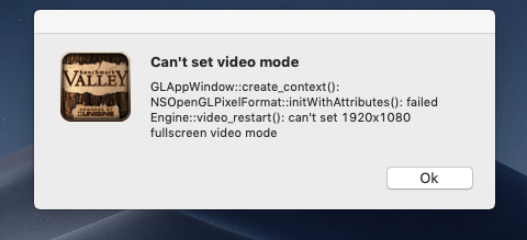

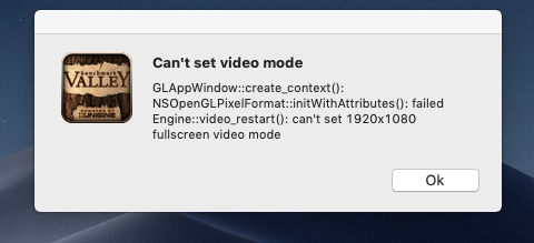

Hmmm. Not sure what's going on here?

Still can't run Valley and I still get corruption on Safari tabs which makes me think that it's an issue with the graphics driver or lack there of.
Thanks for your help Ausdauersportler. You have been amazing.

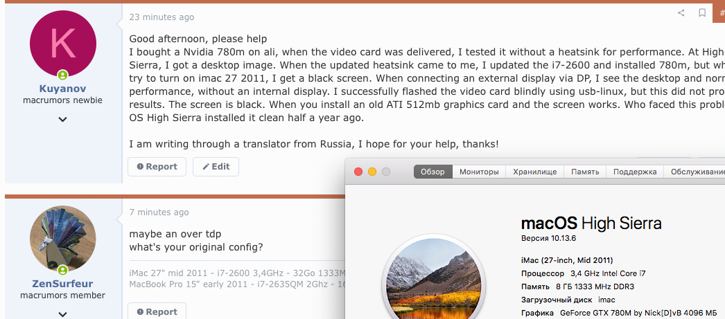

Good afternoon, please help
I bought a Nvidia 780m on ali, when the video card was delivered, I tested it without a heatsink for performance. At High Sierra, I got a desktop image. When the updated heatsink came to me, I updated the i7-2600 and installed 780m, but when I try to turn on imac 27 2011, I get a black screen. When connecting an external display via DP, I see the desktop and normal performance, without an internal display. I successfully flashed the video card blindly using usb-linux, but this did not produce results. The screen is black. When you install an old ATI 512mb graphics card and the screen works. Who faced this problem? OS High Sierra installed it clean half a year ago.
I am writing through a translator from Russia, I hope for your help, thanks!
Imac 27 2011, original i5-2500s and Radeon HD 6750M 512 MB, I see that all users upgrade their imac to i7-2600 and 780m
