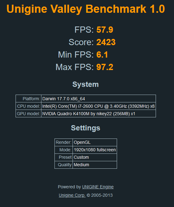

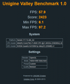

This is an interesting result.
The topology of the card sometimes matters. I used a Dell card for the ROM from a Dell Precision 6800. What kind was yours?
Approaching this logically, if the ROM was the problem, many of us by now would be reporting weak Valley scores. In fact, I just ran mine again:
My suspicion is that the card itself may be failing in a way that's not completely obvious. I purchased a GTX880M which is SLOWER than my K2100M. Some of these cards that have exchanged hands on Ebay are handled roughly. Inspect the card carefully. See if all the small components are on there. The real test would be to use this exact card in another 2011 iMac and see if there is the same problem. The P0 state is were all the action is, full boost/power. It should not register "0". Good debugging so far though!

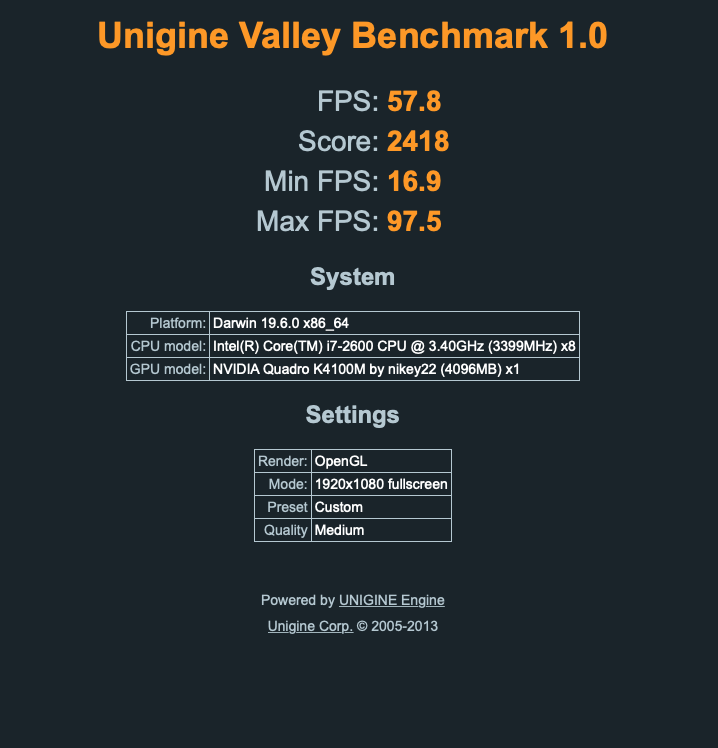

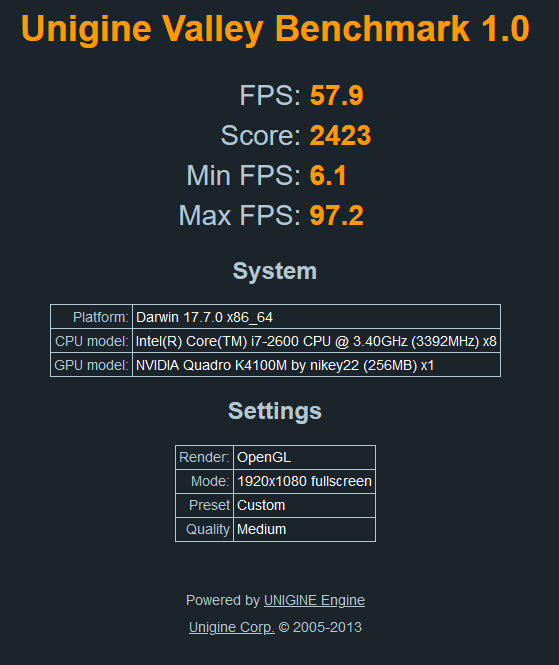

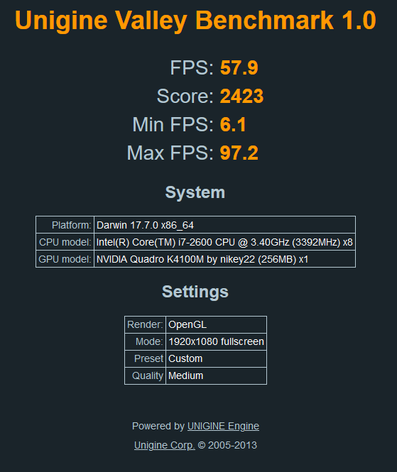

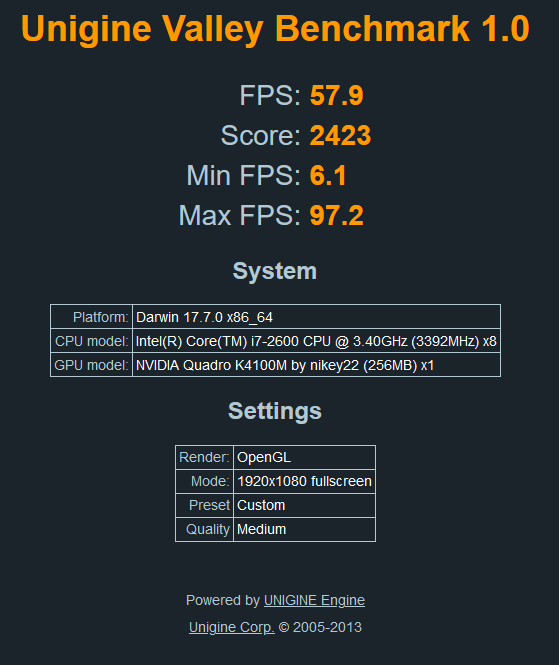

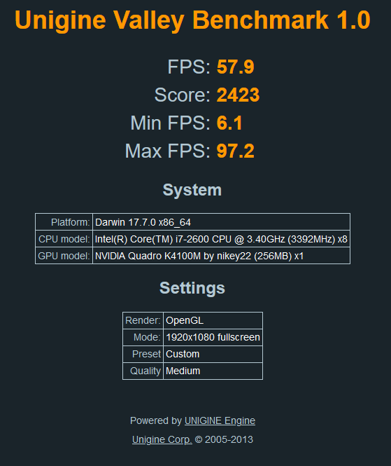

@nikey22
Fixed! Still isn't clear how because this is what I've done in the last hours in order:
Messing with kepler tweaker and flashing a new vbios
Because that didn't work I reflashed your original vbios
Disassembled the iMac and reconected every cable following the advice of #8160
In the process of reassembly I removed the odd sata cable because I did remember that i did read somewhere that the 21.5 macs where having power issues with 3 sata ports connected and the gpu upgrade, so just for troubleshooting I disconnected it ( I'm not running a 21.5 psu in my 27 )
Once I reassembled I booted straight to W7 and fired up nvidia inspector and gpu-z and the card was getting to P0 865 MHz, so I booted to HighSierra and ran Valley which hit 60 fps.
Then just to discard I did a smc reset and a pram reset just in case.
Now, the screenshot attached is from catalina and is hitting the expected score.
This weekend I plan to install the wifi kit and I will troubleshoot all to see if its possible to reconnect the ODD, so I will report back with results.
Quick question, can I reinstall the fakesmc so I can monitor the clocks from HWSensors ( The ones that I have are from nick or @Ausdauersportler opencore loader image ) or do we need some special ones for the K4100M?
Cheers.
Reactions: nikey22 and roscho

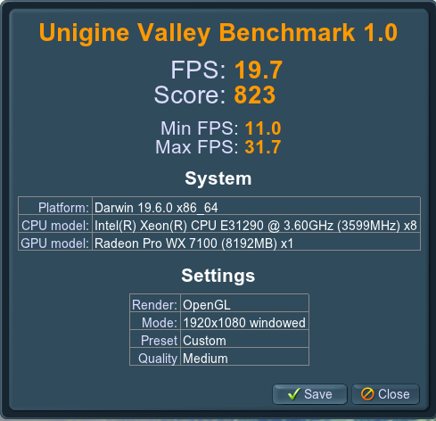

WX7100, right? You used the other version before without PolarisBoost?
This version comes without the device-id settings to get the FakeSMC temp readings. @highvoltage12v told my some WX7100 owners saw performance issues using another device-id. Cannot confirm without a working card 🙂
EDIT:
And no, the FakeSMC is only off use directly after installing the card to see the coupling of GPU with sink. You would like to see low temperature differences. In real production I do not see any reason to have it installed.
EDIT:
Without the Falcon SMC firmware the smaller WX4170/WX4150/WX4130 have a Malaria, i.e. mid performance before sleep and low performance after sleep. You can see it both with Valley (OpenGL) and Metal (GeekBench). With this firmware settings we have mid performance after boot and high after sleep (Metal) and high performance with OpenGL in any case.
Probably we need a special WX7100 config.plist. Take a look at this or the one @Pascal Baillargeau just posted.
I think Malaria describes it well, regarding my newest insights:

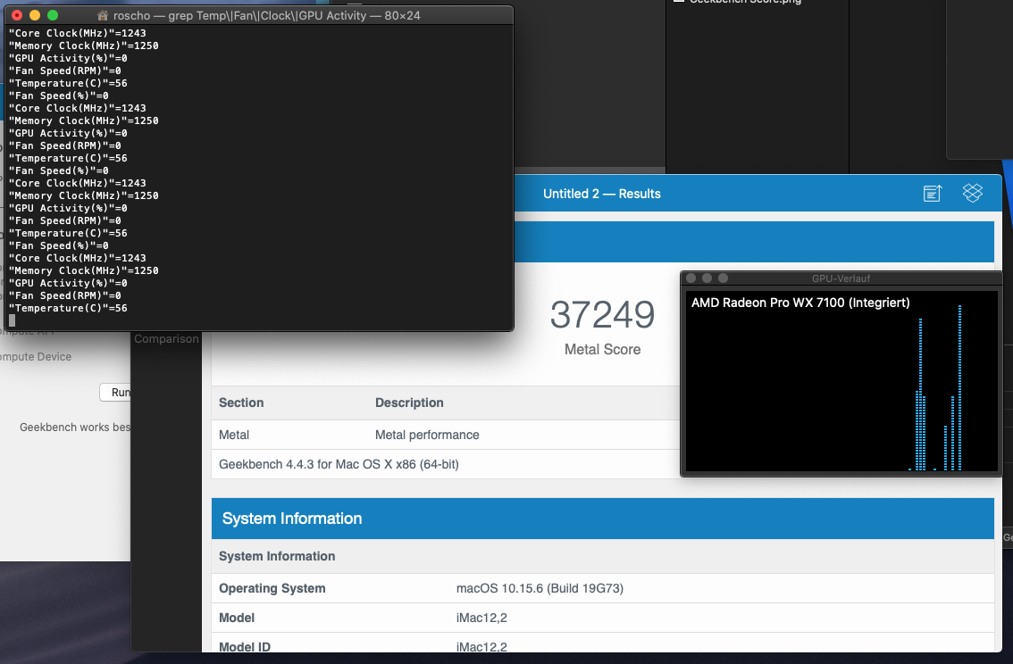

I finally managed to speed up the SCLK speed on my WX7100 to 1253MHz in Catalina! (Tmax around 67-68°C)
Actually setting the driver parameters (AMD9500Controller.kext) ist somehow tricky.
When I tryed CFG,CFG_FORCEMAXDPM = TRUE and CFG,CFG_FORCE_MAX_DPS=TRUE earlyer on without PolarisBoost / FalconSMCFirmware -> only FORCEMAXDPM showed an effect (max MCLK).
Now I gave those two parameters again a try placing them as last parameter of the PolarisBoost, and voila -> max SCLK!
Anyway, the benchmark results stay somewhat esoteric.
In GeekBench OpenCL I reach 45000 now (high score), Metal Score stays around 37000 (but this time even with PolarisBoost injected). Valley gave a somewhat sad an senseless 890 points???
