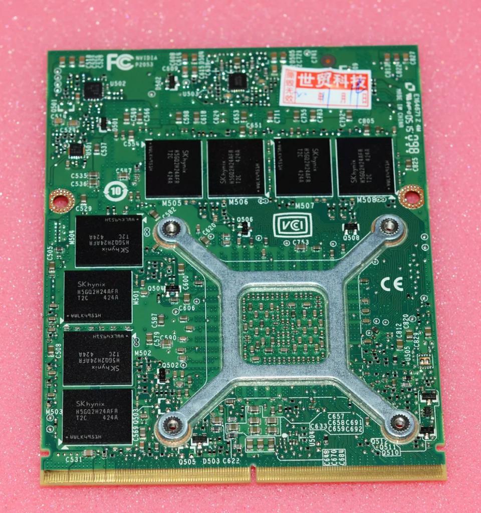

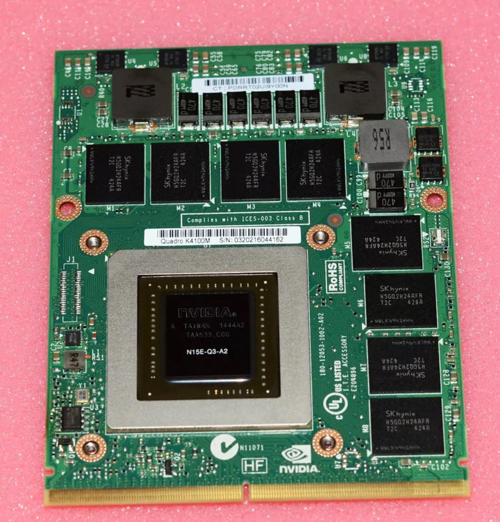

Got any photos of the card front and back?
Here are a photos from the original eBay listing and a screen shot how the flashing went.
This happens when you forgot to connect a temperature sensor.
But at least your screen would be on. Not sure that's it, or at least the only problem.

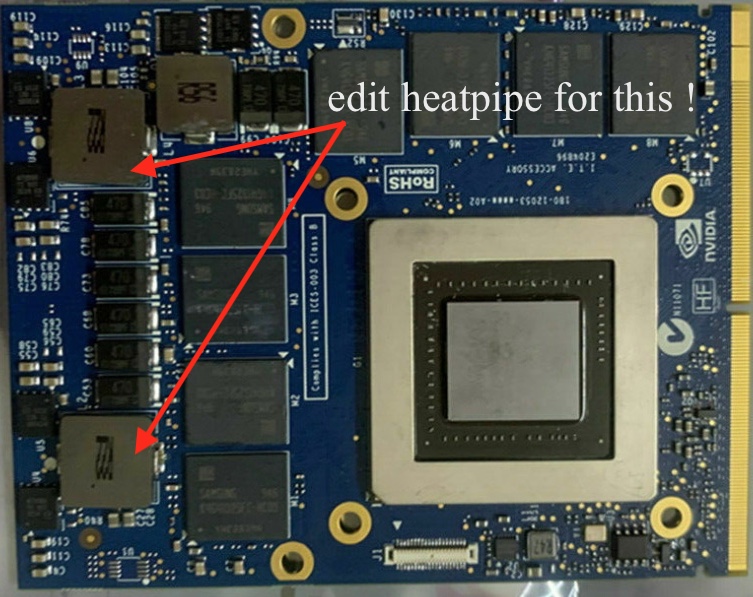

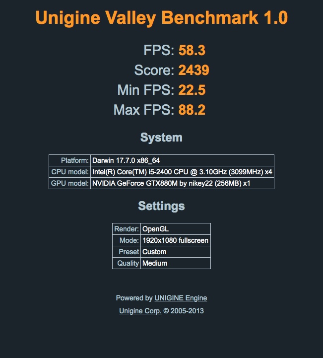

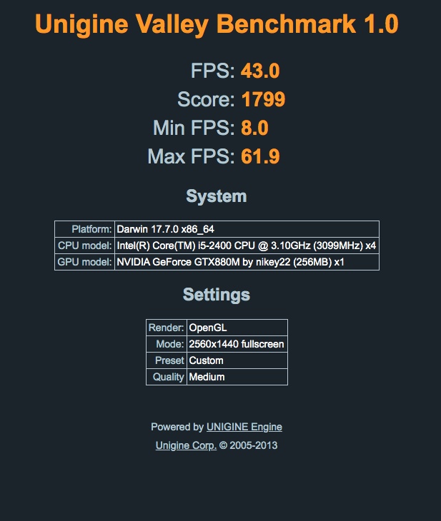

INFO - Nvidia GeForce GTX880M:
after several month of Quadro K2100M (55W) usage, I got a cheap chance
and buy an unpatched GTX880M (8GB) from an ebay-user of the Netherlands
for roundabout 100€.
Hopefully I exchange the card after days of think about temperatures and wattage
of the GTX880M (Peak: 122watts) and compare that with the Quadro K2100M (55 watts).
Now I know - after installation of the GTX880M - the temps in idle mode are about
36° Celsius (!) and goes up to 62° Celsius after a short Unigine Valley Benchmark test !
The card is fluid and fast and I hope that the card stands for month or years, but
the screen brightness is dimmed. I hope that I can use an AppleBacklightFixUp.KEXT
(or not) to solve the problem...
Native Brightness Control supported !
ATTN: you must edit the GPU heatpipe !
Full HD resolution 1920x1080:
Native resolution 2560x1440:

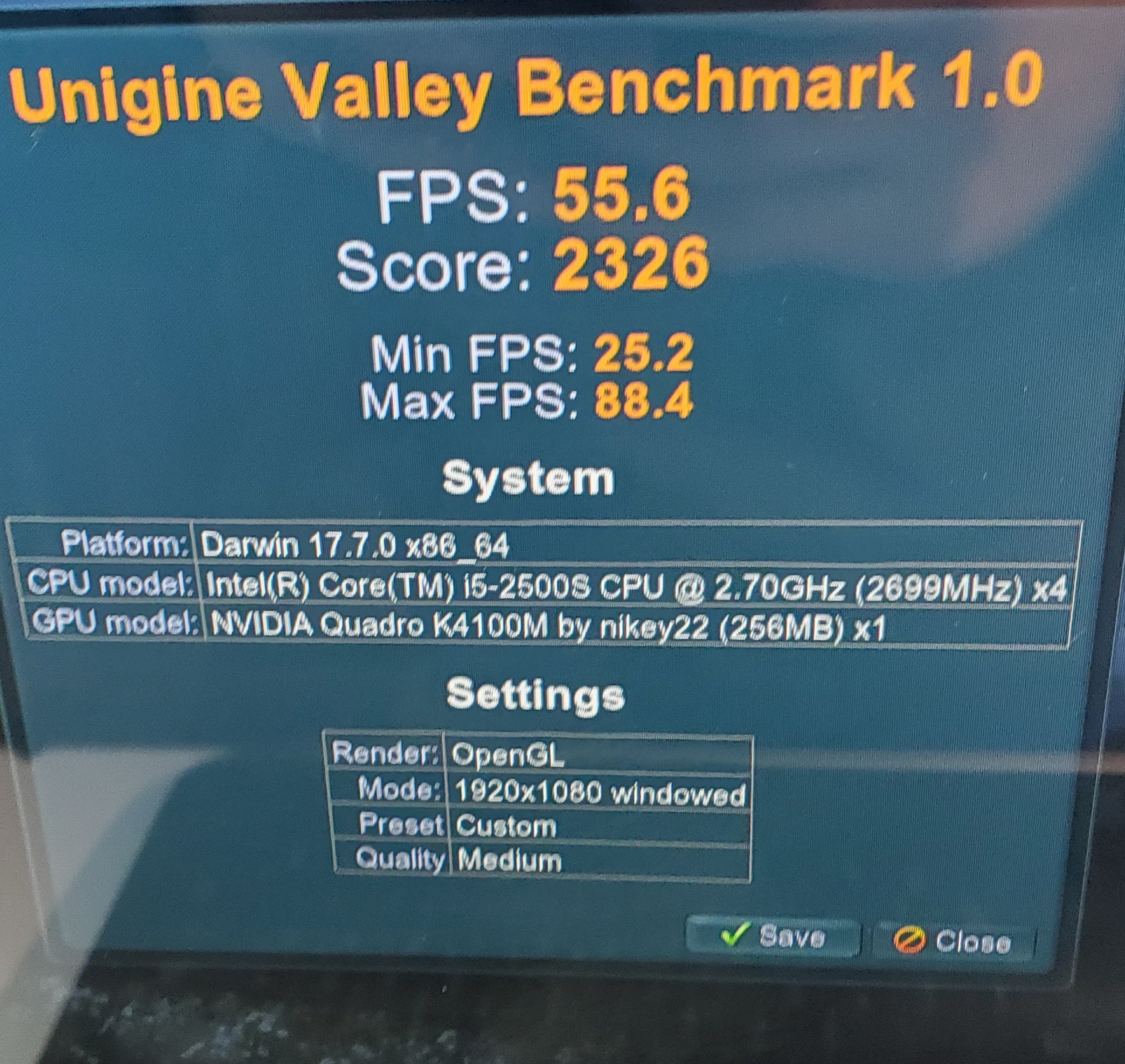

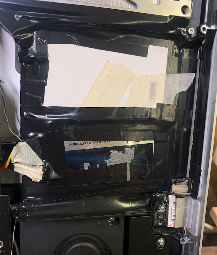

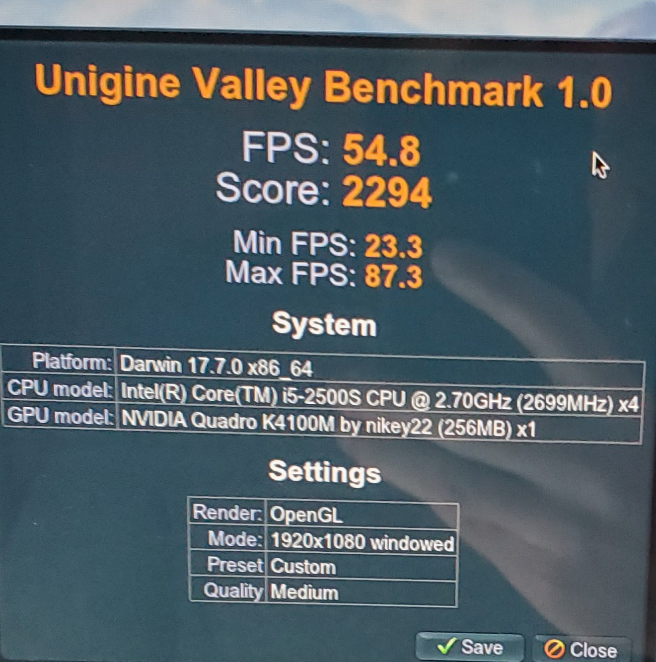

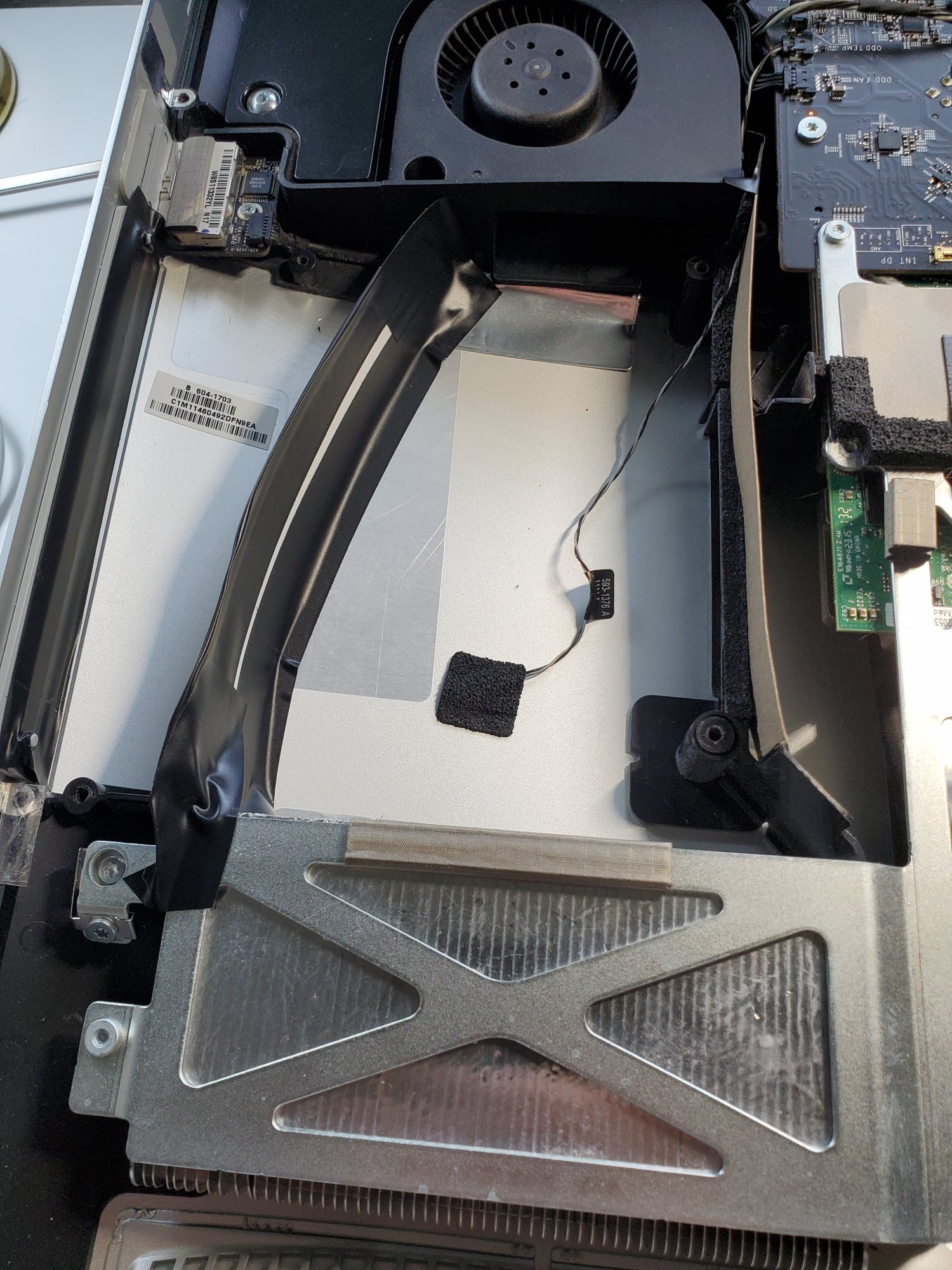

I did some duct work with good old electrical tape and paper board. Tried to make a lip seal at the top. I just did the sides so the back of the LCD would still have some air flow.
Valley benchmark increased a little. Maybe it is coincidence.
Valley is not completely consistent because it relies also on the CPU (load) and used. You will always have some variation in the results, it will be only stable under the same load...

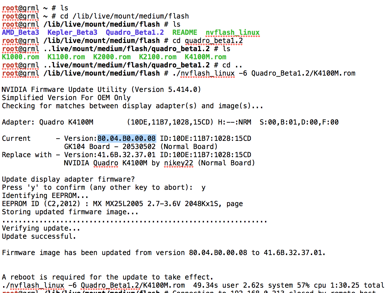

so guys, I have a little gift for you to give back after such an incredible thread :D
hope you like it, the headaches to get it running were immens for me as a newb.
I couldn't stand it to use fckin windows to flash the cards and so I prepared this ~350mb drive
I created a Linux Live USB (based on grml.org) Thumb Drive with nvflash_linux and Nicks Bioses preloaded. and its booting by itself so you can work blind with a new unpatched nvidia card plugged in. Also, its starting a ssh daemon and using DHCP to get an IP so you can remote login :)
Steps
Download
14 days left to download, uploaded here: https://www.mediafire.com/file/cztz4xqj2sru9gj/2011_imac_usb.zip/file
mirror by NOTNICE, thnx: https://cloud.notnlce.com/index.php/s/xkJP34GD6a9WziE/download
Prepare USB Drive or SD Card
so, you take a small usb thumb drive, partition it with disk utility on a Mac: GPT + FAT32
and just unzip the files structure onto the drive, no dd or etcher or something. just copy paste it. folder structure see attached screenshot. (you can remove the .roms I downloaded and download itself if you want to be sure about the correct file size. I did not verify them at all. use/flash at your own risk please)
Test & Try
test your thumb drive with a more or less working GPU/ external Screen or just have faith in me
Swap Hardware
swap your GPU to NVIDIA and (!) disconnect every SSD/HDD, makes it easier to boot blindly from one USB or SD Card, connect the ETH Cable (!)
Find IP
let the iMac boot, everything is black, the boot loader is waiting 20s before booting, so give the whole process 1min time, then head over to your Router Page and find the right IP that the iMac got through DHCP
SSH to the iMac
now fire up your terminal on a Win/Mac/Linux Machine of your choice and ssh to your iMac with
ssh root@YOURIP
Password: flash
Confirm the ssh id with yes and you should be in your iMac
Working Directory
cd /lib/live/mount/medium/flash
read the RADME in there… I will enjoy my brand new k2000m in my 27" 2011 iMac with Catalina 10.15.3
… and because this is so easy, I rebuild it to a K1100M and flashed that also :D :D :)
(someone could write some fancy scripts but I thought its saver that everyone is doing it command by command and don't stop thinking and trusting some scripts)
You could point out the difference in temps. This is critical :)

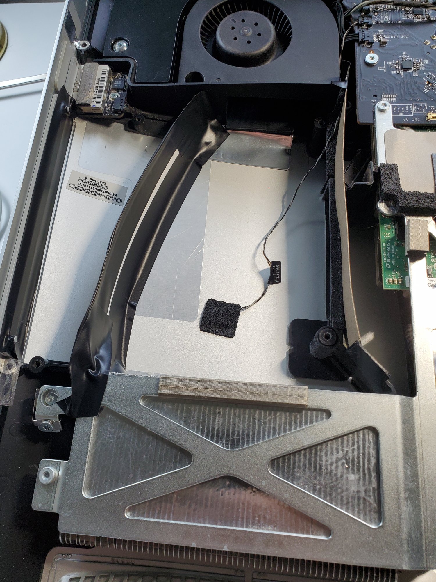

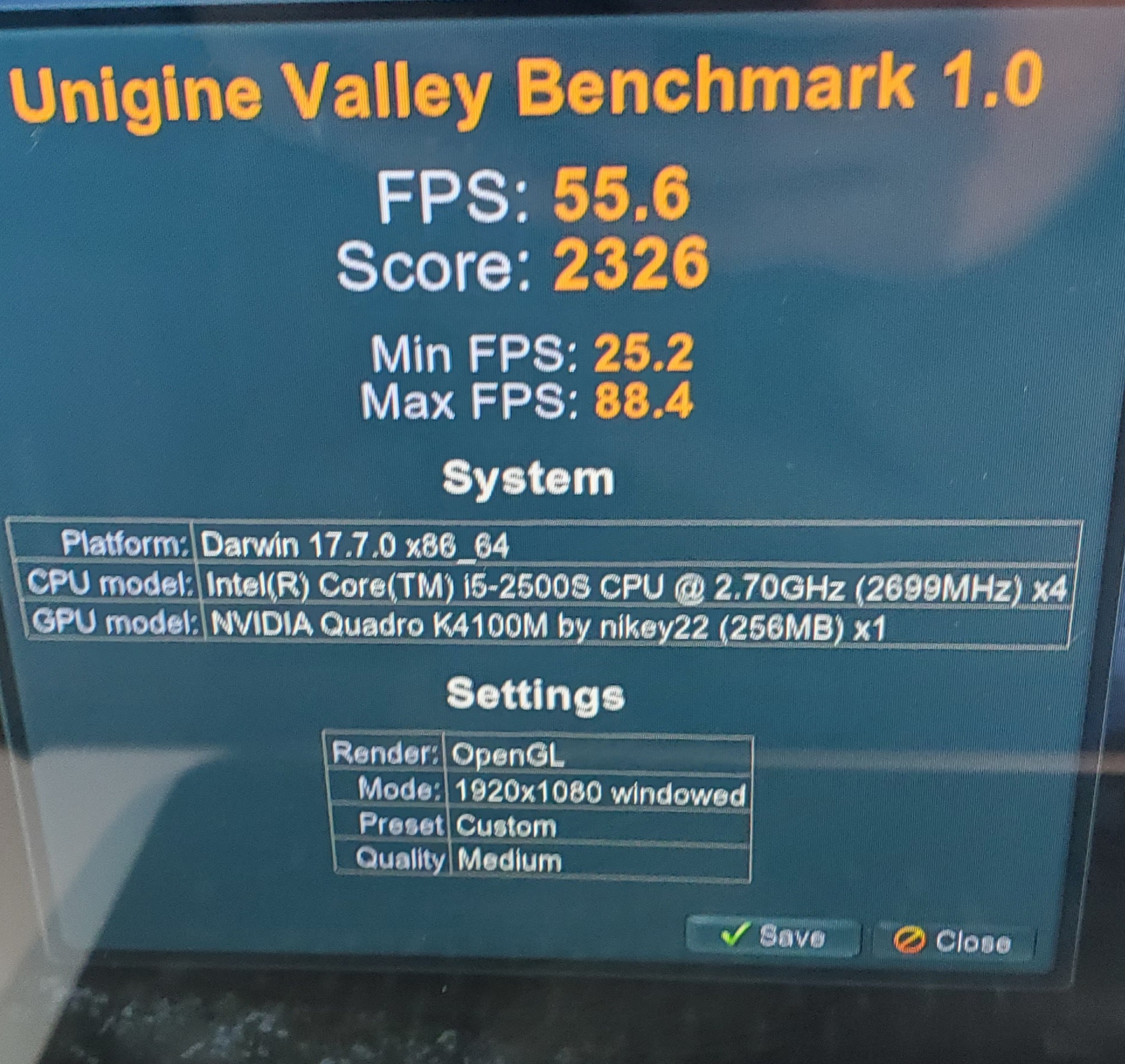

I did something alike but taped it as good as closed, nothing going to the LCD.
The 2 LCD temps in MacsFanControl stay both around 30°C to 35°. Well to be more precise, running a bench as I type to test. The first LCD temp is now at 32°c and LCD temp 2 is at 36°C.
ODD sensor was glued to the back of the heatsink with epoxy as Ausdauersportler explained some pages ago, thx for the tip btw. Works neat!
ODD fan & temp start to ramp up around 48°C and stays around 50 to 55°C. Heatsink fluctuates between 55 & 60°C.
edit: lol just noticed you / ChrisCaro were the one who asked me about the taping in the other topic. 🤣
