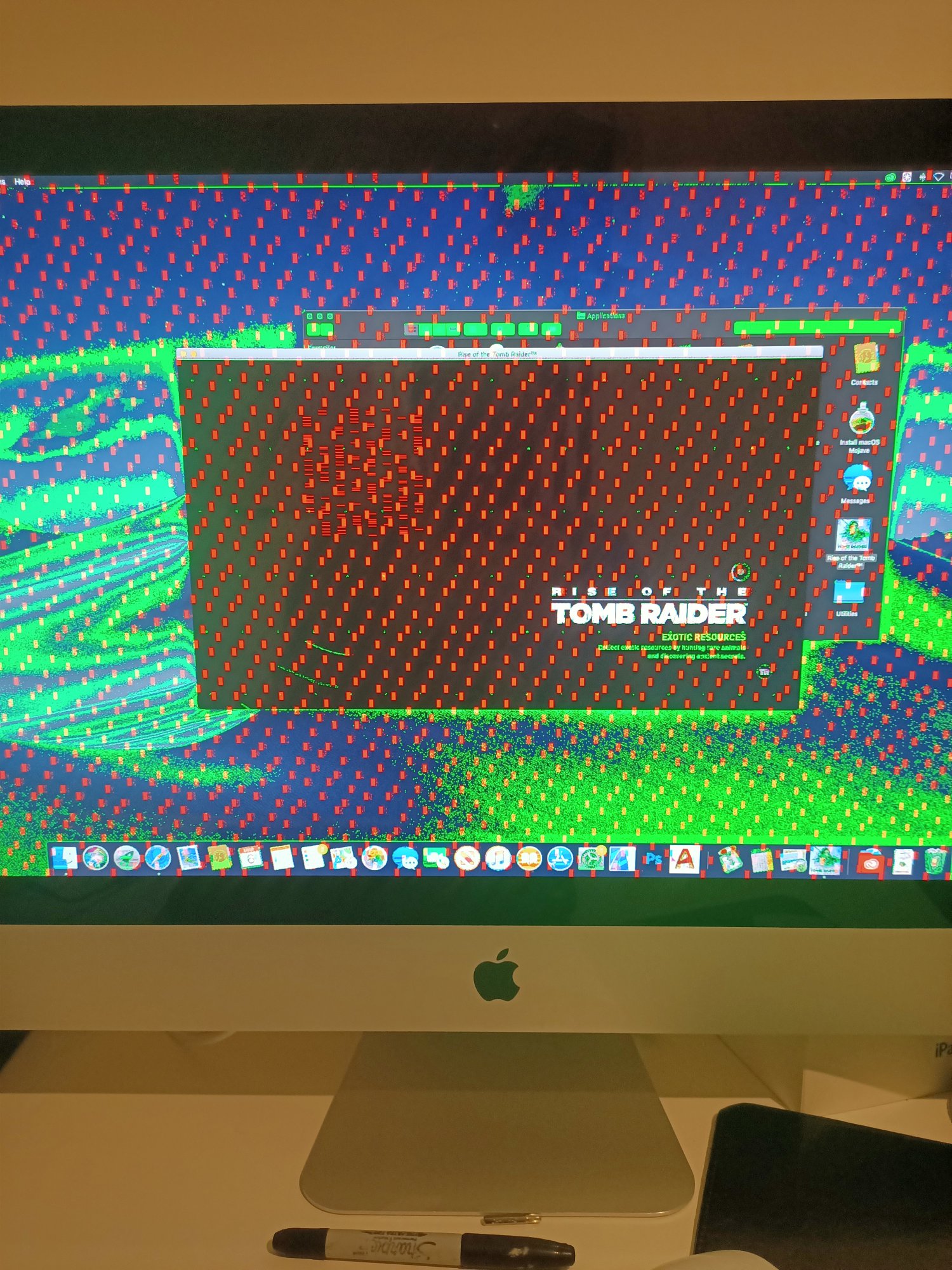

Don't rule out your card being faulty. A week after installing my 700m i got this:
Best way to diagnose it is to try it in another same spec iMac.
I hope for your sake it is a user error causing your issue but really this can be a pretty random game we play.

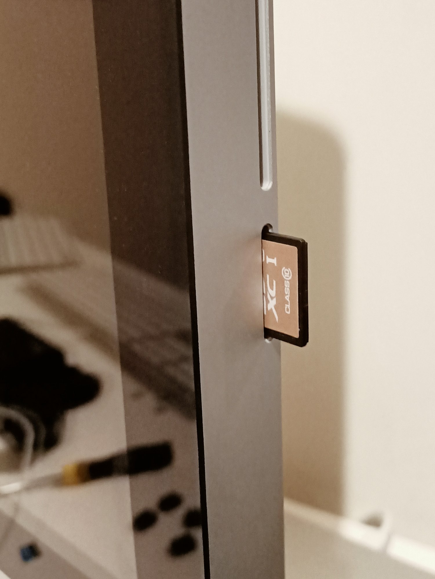

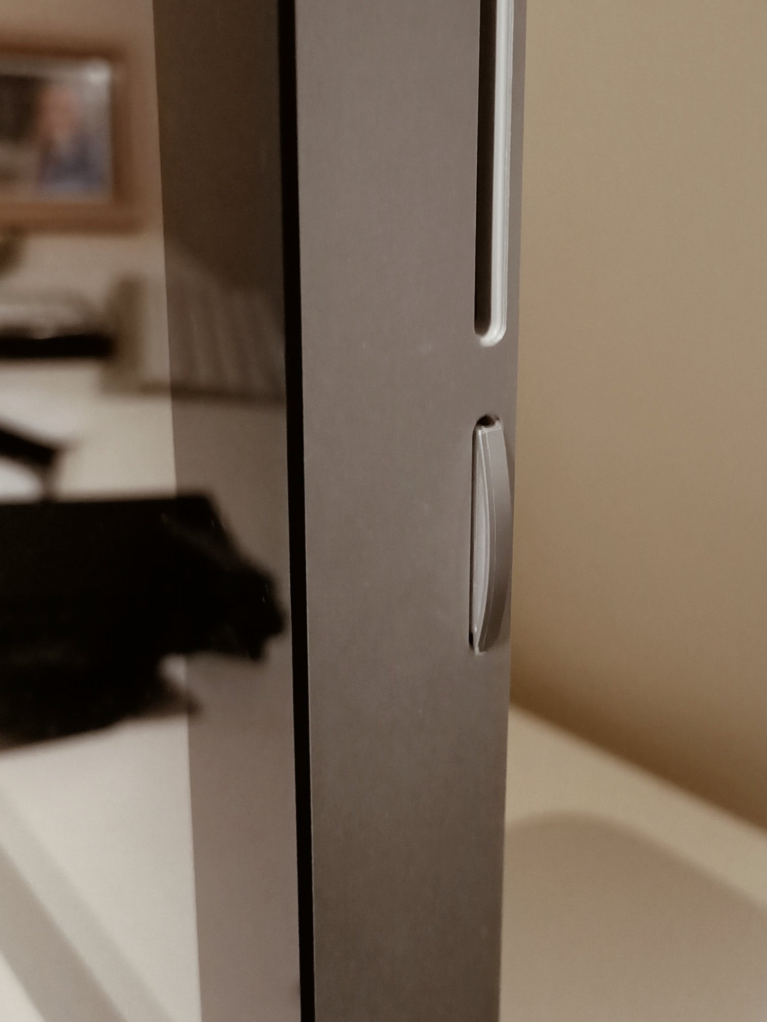

Thought I'd share my CL OpenCore microSD slim adaptor set-up to clean up the look of my iMac running the 770m
It's only $1.50 shipped from AliExpress, China to AU in 10 days. If you want to get real fancy you could spend 20 X more on the BASEQI 303A adaptor that sits totally flush or the Transend Jet Drive (bit of a overkill at 64gb)
Before
After
Reactions: 0607557

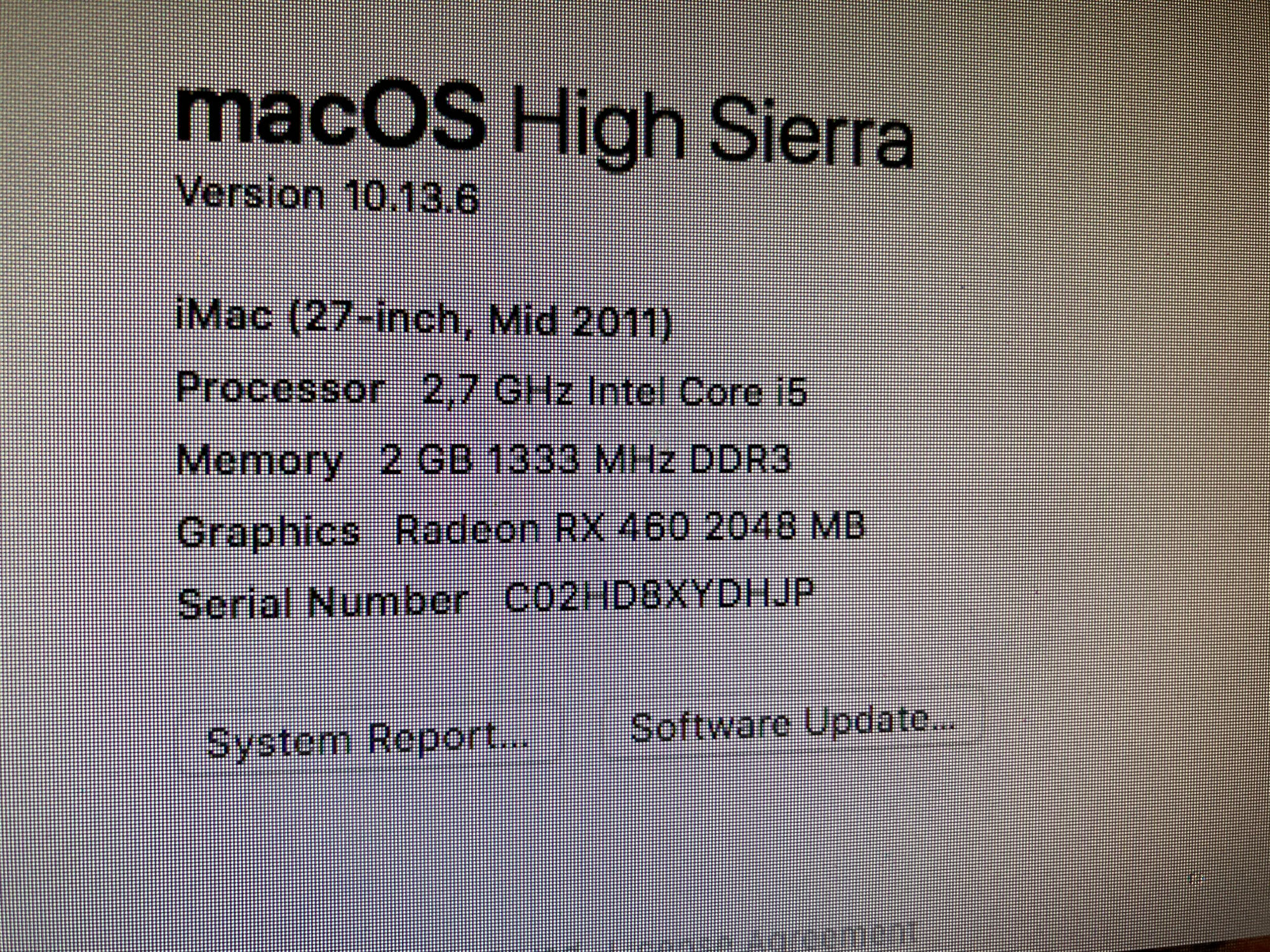

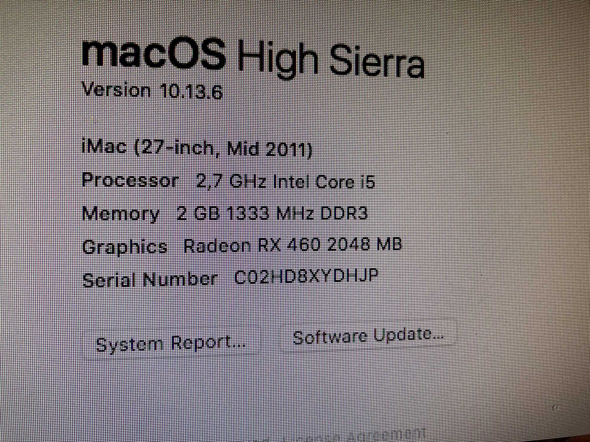

So i flashed with the 2gb rom and it does boot now. Shows up as an RX 460:
Is there any bios i should try that could utilize the remaining 2gb of memory? I think it is a 4gb card, because the flash tool indicates this:

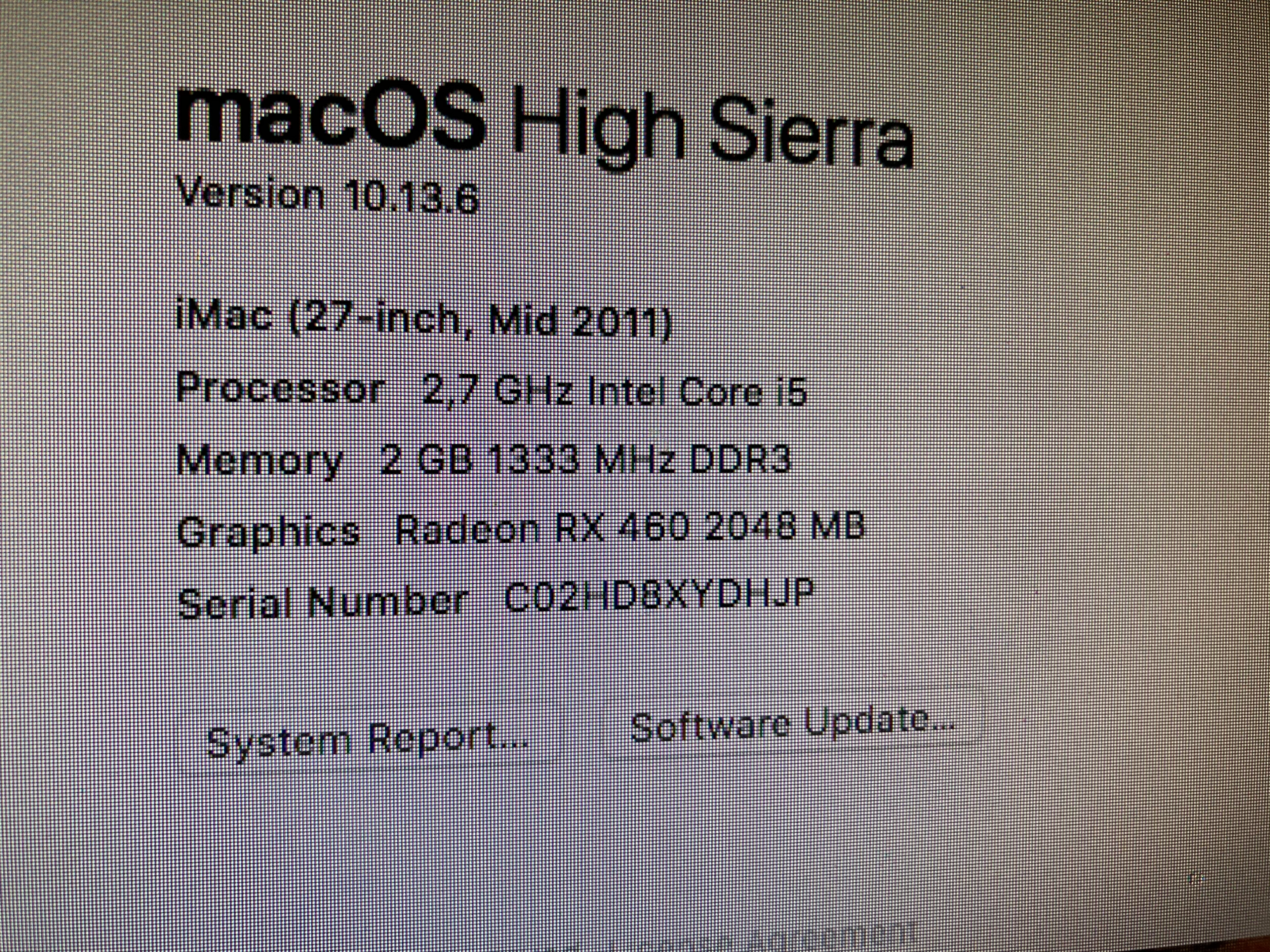

No opencore yet, just flashed the card with the 2gb bios and booted up into high sierra just fine with an external screen(i didn't tried it with an internal yet).
Code:
Old Product Name: Dell/Compal Crane 15 BaffinM GL Pro A1 GDDR5 4GB 300e/300m
I've many times seen that string containing wrong information. In this case for example 300e/300m is supposed to mean a base frequency of 300 MHz for both RAM and GPU, but the information in that string is wrong most of the time.
You'll know the capacity of your RAM by searching for the exact type printed on the chips. For example searching online for the datasheet of Elpida EDW4032BABG reveals that those are 4 Gbit chips. So it's four times 4 Gbit, giving 16 Gbit in total. 8 Bits are one Byte so four of those chips have a capacity of 2 GB.

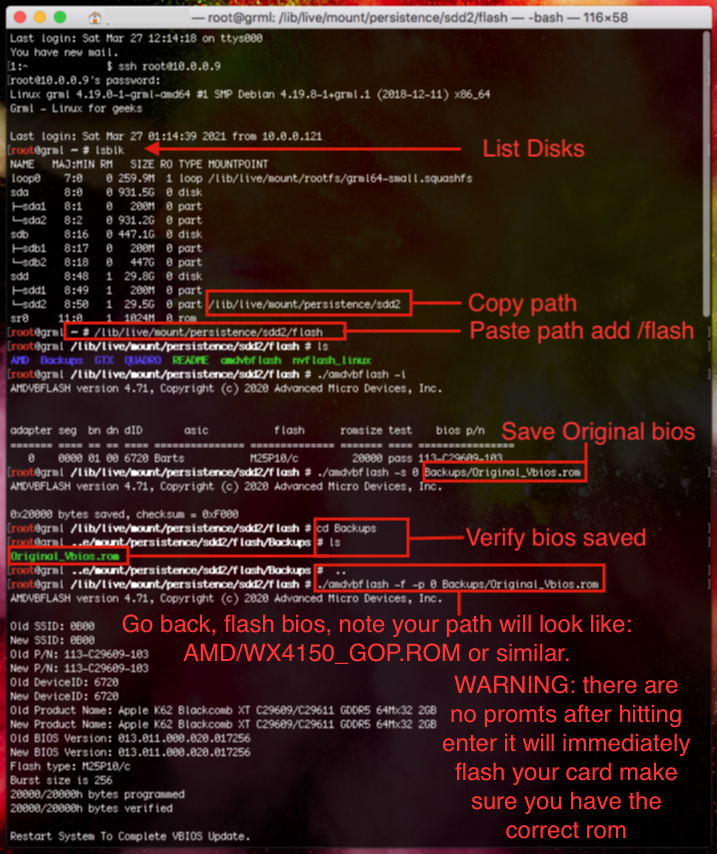

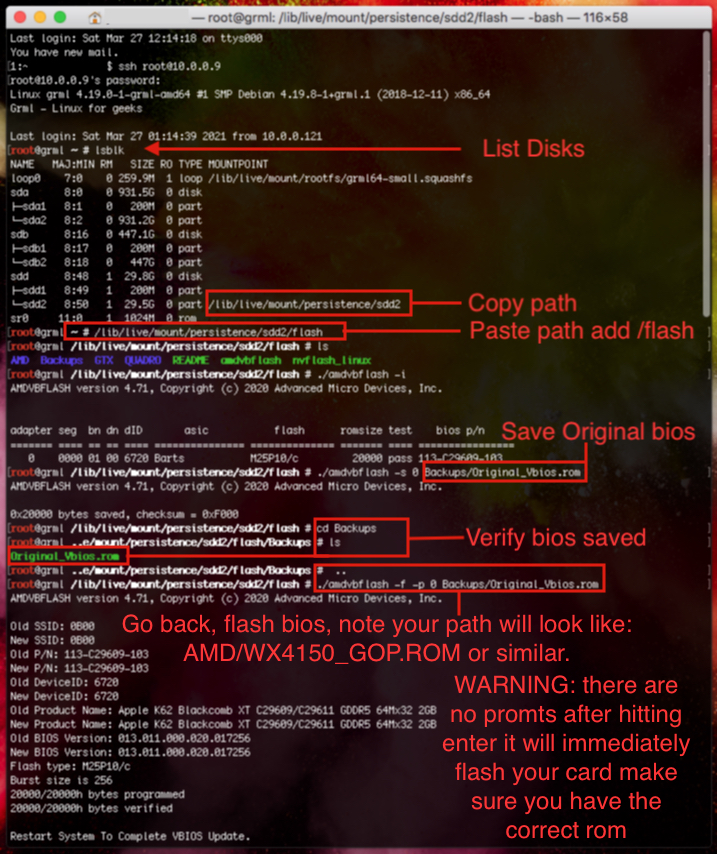

If anyone is interested I have updated and modified the awesome grml-linux vbios flash boot disk that @xanderon shared with the macrumors community.
The changes include adding amdvbflash, thanks to @Ausdauersportler add-on, all the current ROMS from post 1 and a local Backup directory to store your backed up original ROMS directly on the Bootable USB using the persistency function in grml as default.
By doing this the directory structure has changed so please see the detailed guide below on instructions for using this modified bootable USB.
Create your USB using my modified @xanderon boot disk and connect to your target machine via SSH as outlined in @xanderson post HERE.
At root type:
Code:
lsblk
This will list list your mounted disks and is important as this disk order may change, sda/sdb/sdc, depending on what disks you have connected, how fast they are loaded by GRML etc, therefore the path to your working directory may change. You will see a example of this if you look at my terminal.txt file, I flashed 1 AMD and 1 NVIDIA GPU on seperate Macs.
In terminal copy the path to the root of your Flash USB, Example:
Code:
/lib/live/mount/persistence/sdd2
cd paste and add /flash to get to the directory:
Code:
cd /lib/live/mount/persistence/sdd2/flash
Press enter, you will now be in your working directory.
Code:
root@grml ~ # /lib/live/mount/persistence/sdd2/flash
In this example I will be using amdvbflash to backup and flash my stock AMD apple vbios.
1st - lets look at the working directory:
Code:
ls
2nd - Verify your adapter is recognised:
Code:
./amdvbflash -i
3rd - save a backup of your original bios to the Backup folder on your USB.
Code:
./amdvbflash -s 0 Backups/Original_Vbios.rom
4th - Verify the bios is saved to your Backups folder:
Code:
cd Backups
ls
Now if your paranoid that when you shut down your bios will be gone you can stop, shutdown and actually check the USB drive Backups folder.
5th - flash new bios for example:
Code:
./amdvbflash -f -p 0 AMD/WX4150_GOP.ROM
WARNING: There is no pause asking you if you wish to continue as in nvflash so make sure you have your backup and are flashing the correct ROM.
You will be greeted with some code similar to this verifying the process is complete:
Code:
AMDVBFLASH version 4.71, Copyright (c) 2020 Advanced Micro Devices, Inc.
Old SSID: 0B00
New SSID: 0B00
Old P/N: 113-C29609-103
New P/N: 113-C29609-103
Old DeviceID: 6720
New DeviceID: 6720
Old Product Name: Apple K62 Blackcomb XT C29609/C29611 GDDR5 64Mx32 2GB
New Product Name: Apple K62 Blackcomb XT C29609/C29611 GDDR5 64Mx32 2GB
Old BIOS Version: 013.011.000.020.017256
New BIOS Version: 013.011.000.020.017256
Flash type: M25P10/c
Burst size is 256
20000/20000h bytes programmed
20000/20000h bytes verified
Restart System To Complete VBIOS Update.
Shutdown and hope for the best 🙂
Code:
shutdown now
For NVIDIA cards the process is the same but the nvflash_linux commands will be different see my attached Terminal example.txt if you need more info. Also attached a quick visual guide and both Nvidia/AMD flash tools help text.
Enjoy.
