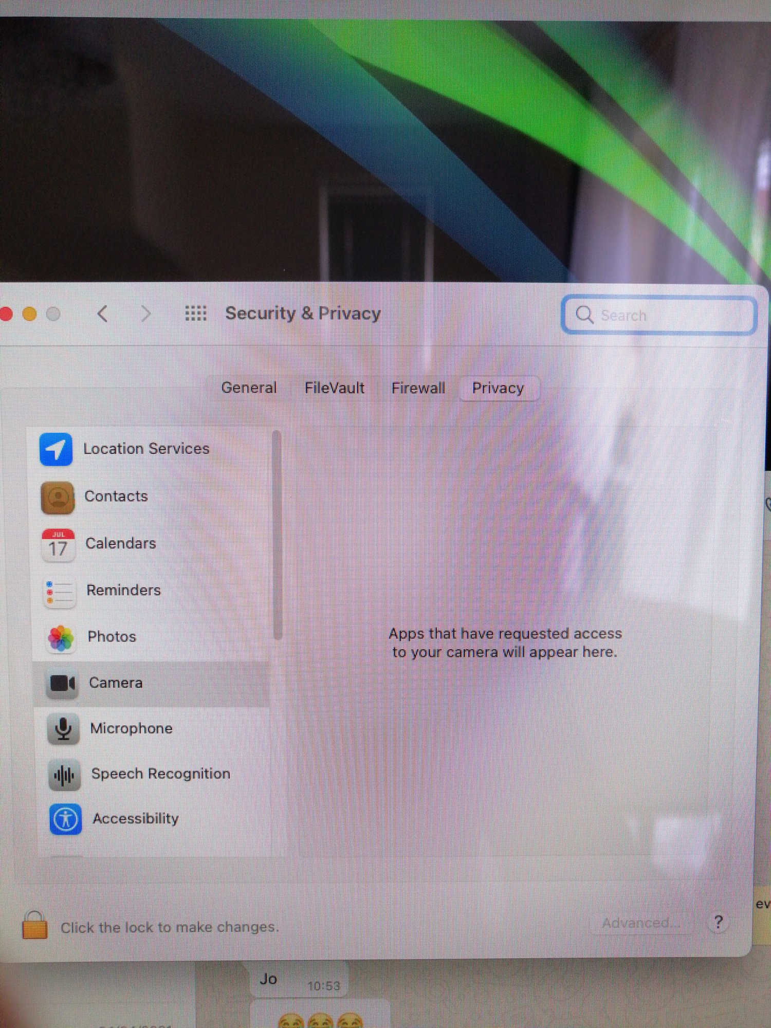

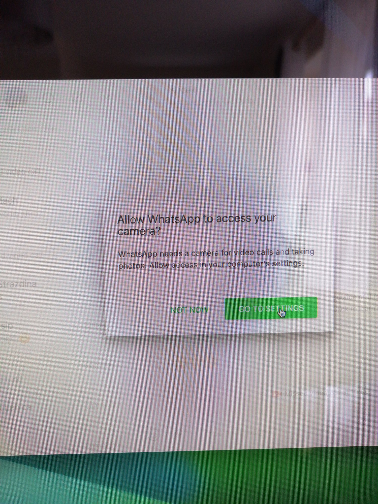

Hi can someone help please just installed opencore legacy patcher big sur on IMac mid 2011 everything works good but if I wanna use messenger or what's app or other apps that need camera or microphone access it won't let me do it. The apps don't show up in privacy.

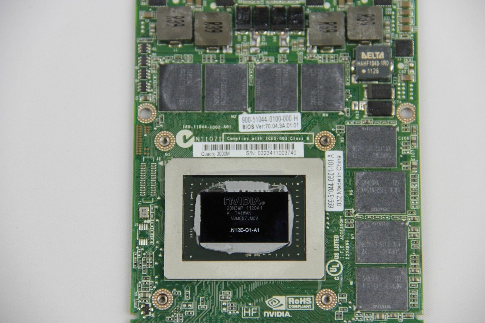

Hey there. Here’s my contribution to the thread.. hopefully lol.
I bought two cards to test out on my iMac, a Quadro K4100M and a FirePro M6100. Both cards work on the iMac albeit with a couple caveats.
The FirePro boots up with no bootscreen, however give it some time, High Sierra eventually boots and we get an image on the screen. Apparently the drivers are already baked in as the card gets detected as “Radeon HD 8xxx”.Haven’t gotten a chance to test in Catalina.
I have the Quadro in another machine with a Catalina install. No bootscreen, and the screen doesn’t turn on at all. However, I was able to remote into the Catalina install and it detects the card as a Quadro. However it doesn’t detect a display. I suspect I have to edit the dcb table, but hopefully someone can point me in the right direction for that.
other than that, both cards under windows will not run. Boots into code 43 I think it was. Again I didn’t really go that deep into testing. I’d like to continue to contribute so just tell me what to do and if it’s within my scope I’ll do it.

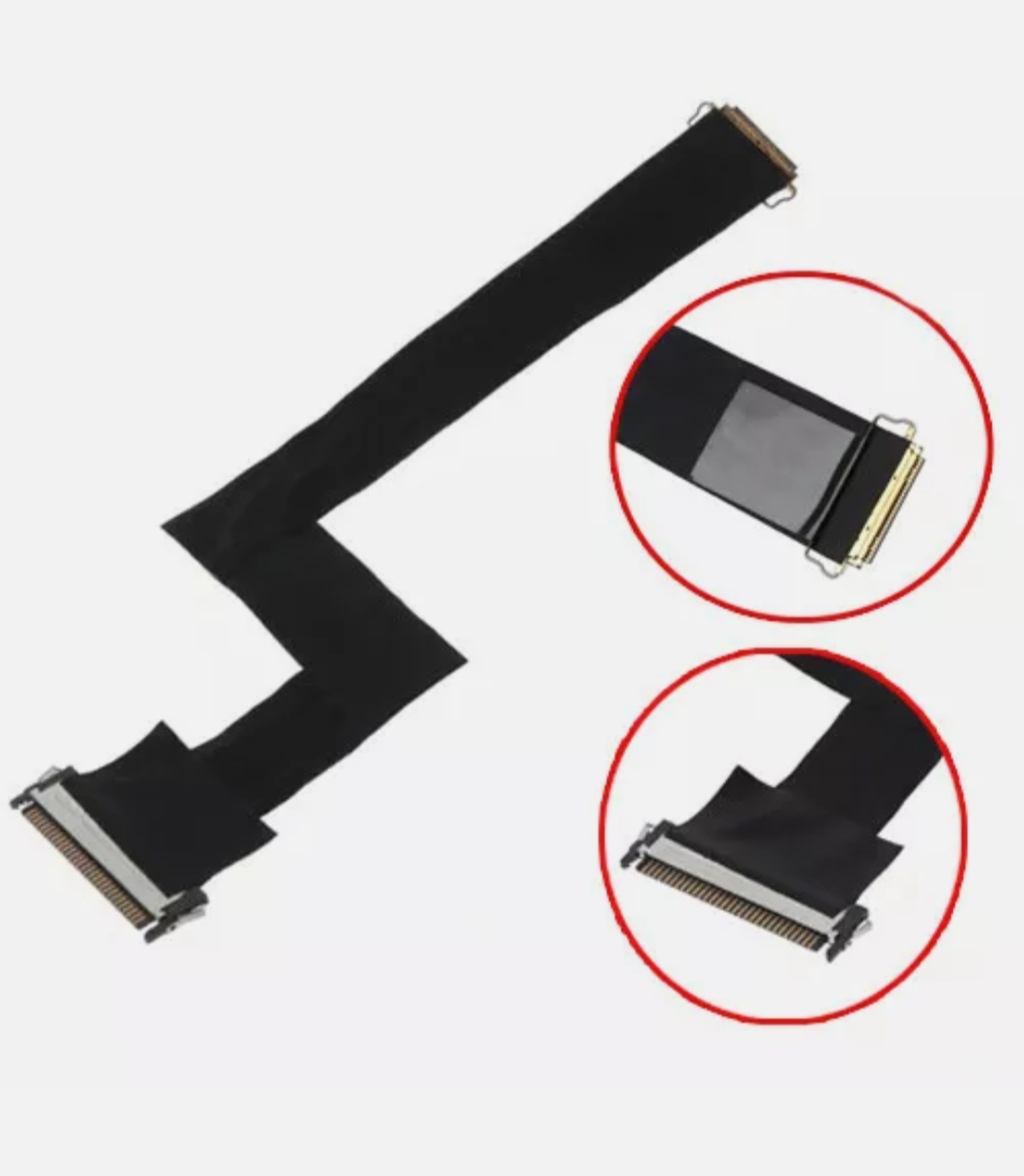

I've always wanted to try a 21.5" (09/10) LVDS cable to test this on a 27" 2009-2010 lcd to 2011 logic board without any disassembly or swapping boards.
Don't know if it would be long enough though.

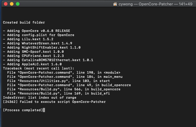

Hi guys... I have been using Patched Sur since 11.0.1 until now (Im in 11.2.3) in my mid 2011 27inch imac with NVIDIA K3100M, but I will now dive into the OCLP greatness. 2 Things drove me this path; OTA and Security. I am now building the bootable installer. Wish me luck brothers!
As I tried to run OCLP Patcher 0.1.0 in Terminal, I encountered this error when building the Opencore EFI from option 1:
My iMac 2010 is running Catalina 11.5.7 unpatched.
Just want to share my own experience with OCLP that converted my dosdude patch to OCLP.
I hit this exact same error when preparing the USB stick for the actual iMac12,2 on my PC hackintosh.
In the end, I went to the actual iMac12,2 running Catalina using dosdude's patch to run OCLP Patcher to build the Opencore. It went through without any error. I was able to get the EFI part installed nicely to the USB stick (with Big Sur). I then boot up my iMac12,2 with the USB stick to install Big Sur without any problem.
No black screen, no nothing.
All went well.
All went well.
OCLP has included a hardware detection. It assumes to run on native Apple legacy hardware. If you fool the app on an hackintosh or sometimes even on a real Apple system using OpenCore (and hiding it’s real nature) this detection can fail. Using the CLI or setting all parameters according to the target hardware should always work, i.e. you can run it on an iMac11,1 to generate a iMac12,2 configuration and vice versa.
