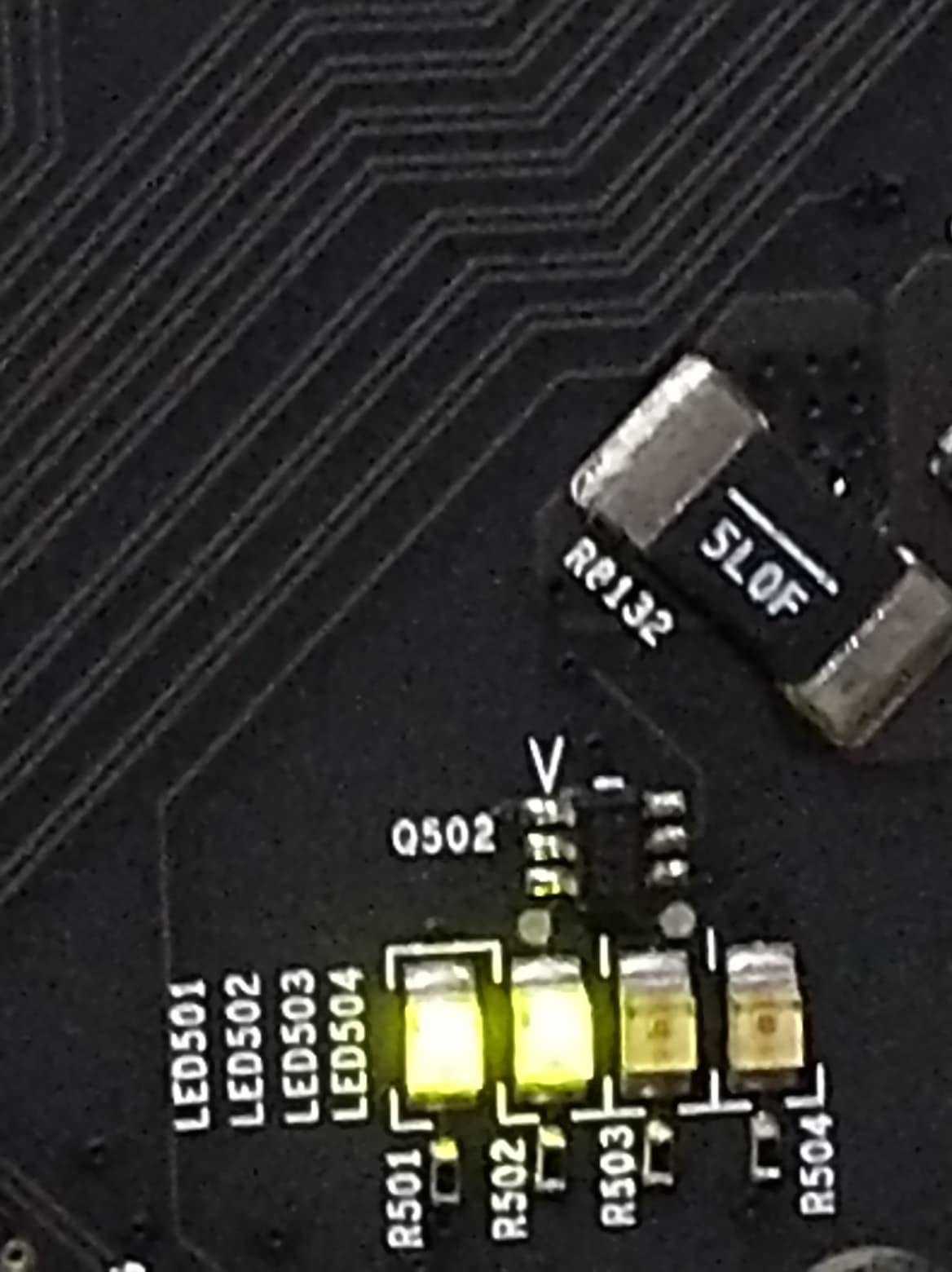

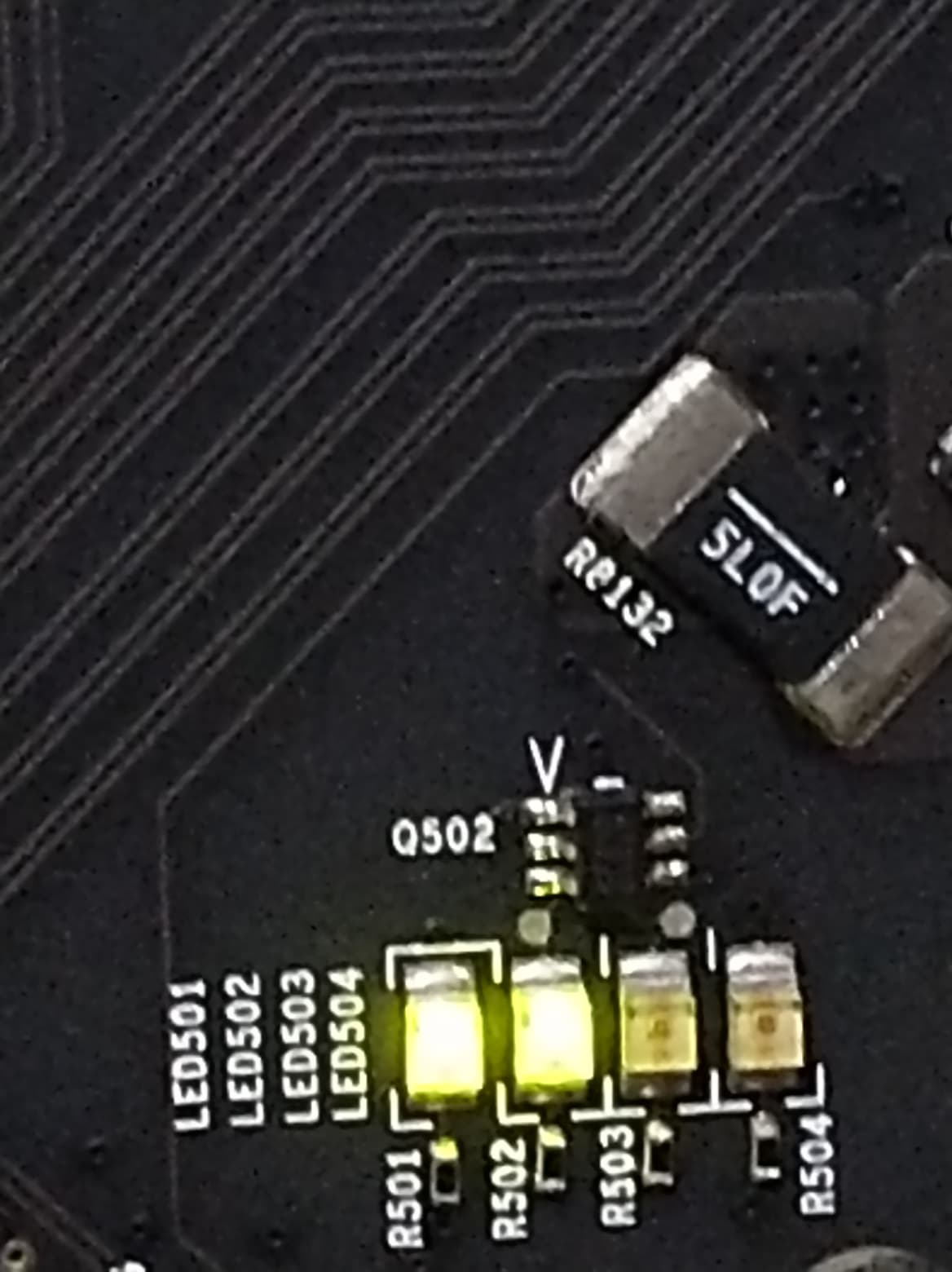

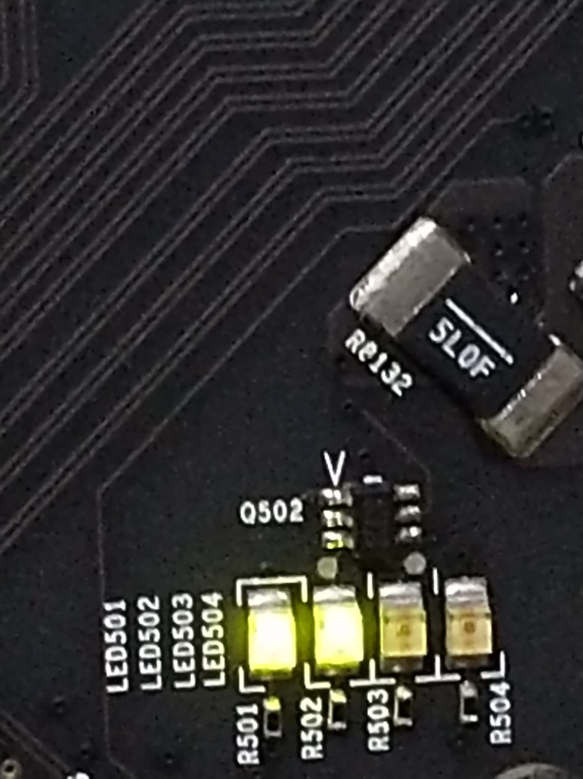

I bought it and installed the K4100M boot loop on iMac 2011 but it doesn't work.
Symptoms boot loop Loud fan noise Black screen I can't boot USB to flash ROM. And then turn off
I didn't remove the HDD cable. Why is it? How can I fix the problem?
Two LED on
Information on the card Nvidia K3000M HUNIX 2GB
Two LED on
Did you flashed the card with the modded vbios (ser post 1)?
Can you share a picture of the card chip and the vram?
