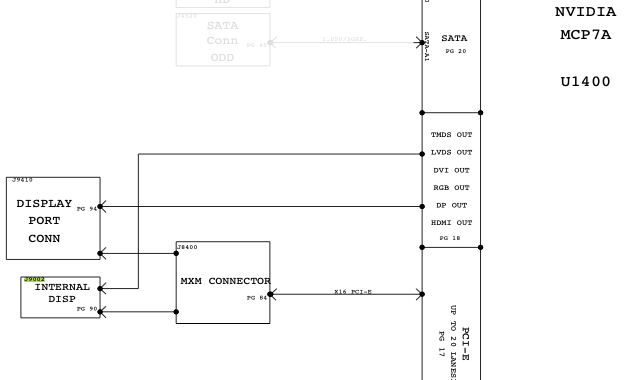

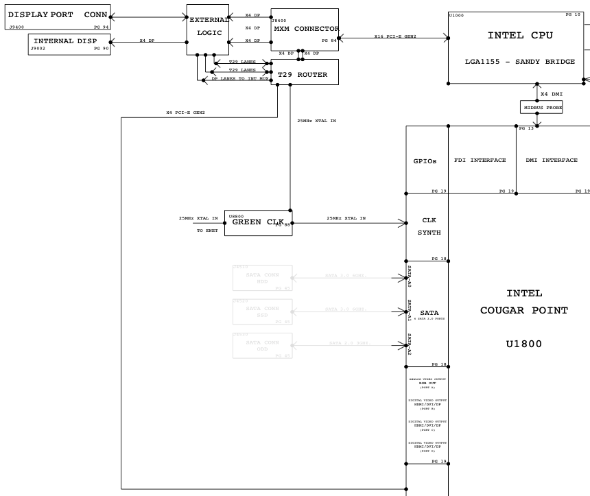

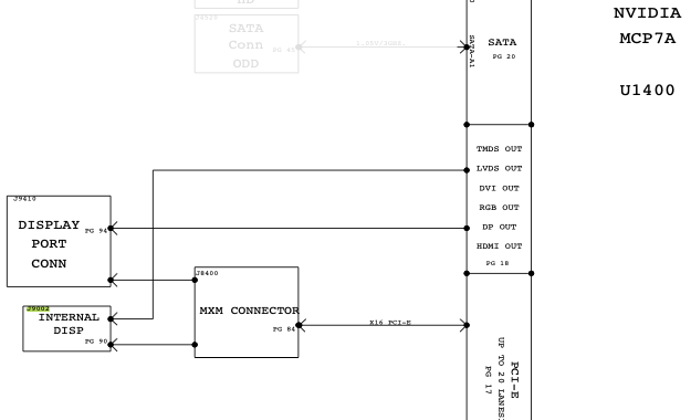

This post seems to hint on the fact that these older iMacs are using LVDS instead of DP for the internal display. Indeed we find LVDS entries in the VBIOS of the iMac9,1. Adding these to the VBIOS of another card might just work.
iMac9,1 uses LVDS, iMac10,1 uses DP!
I have no idea why the vbiosses supplied here are not working on the iMac10,1. A GeForce 9400M dump of an iMac10,1 probably holds the answer, but I have not acquired it yet.
So the question to investigate is: What did Apple change between A1311 (iMac10,1) and A1312 (iMac11,1)?

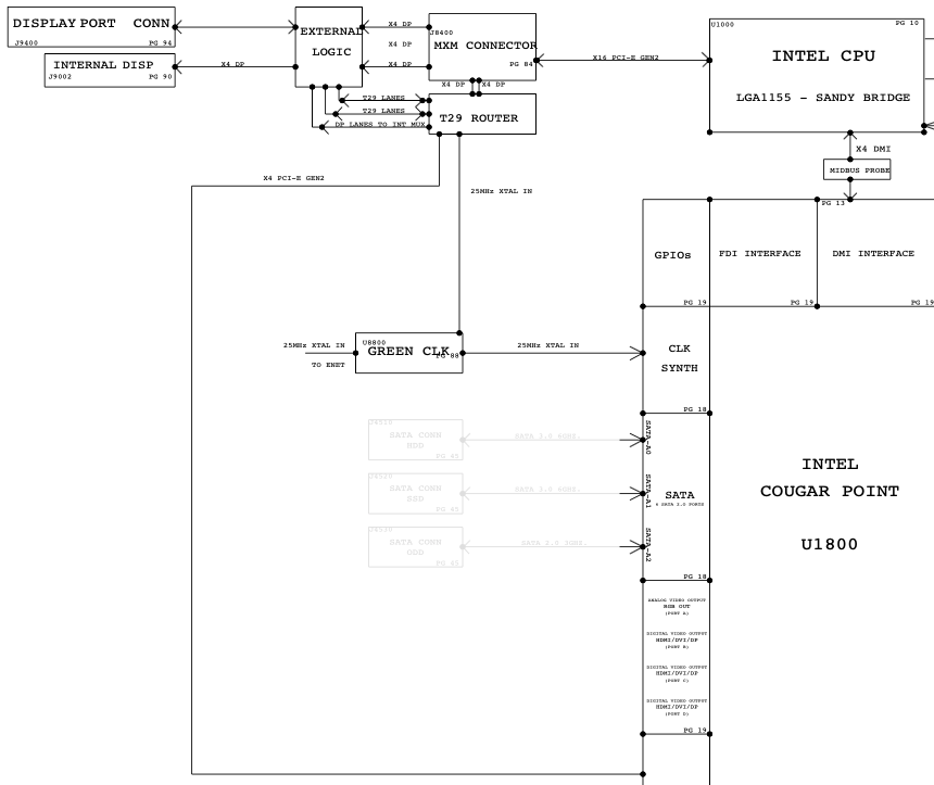

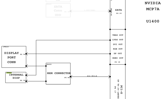

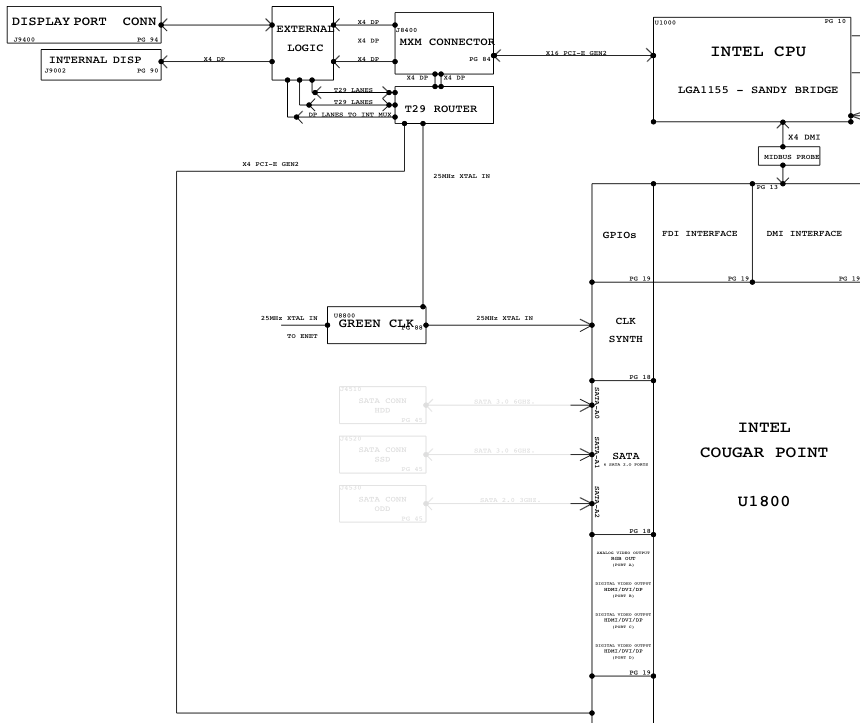

iMac10,1:
Something wrong here: the schematic says "Sandy Bridge" - might this one be from an iMac 12,x?
Something wrong here as well: this one has the Nvidia MCP7A, so might be an iMac 9,1 or 10,1 .
There seem to exist two different mainboards for the 10,1 : one with the Nvidia 9400M onboard (MB950xx/A) and another one with an MXM slot (MC413xx/A).
Yes, there are three different iMac10,1 models on the road. 21,5 9400, 21.5 MXM and 27 MXM - all core2duo. These have at least different board-ids….

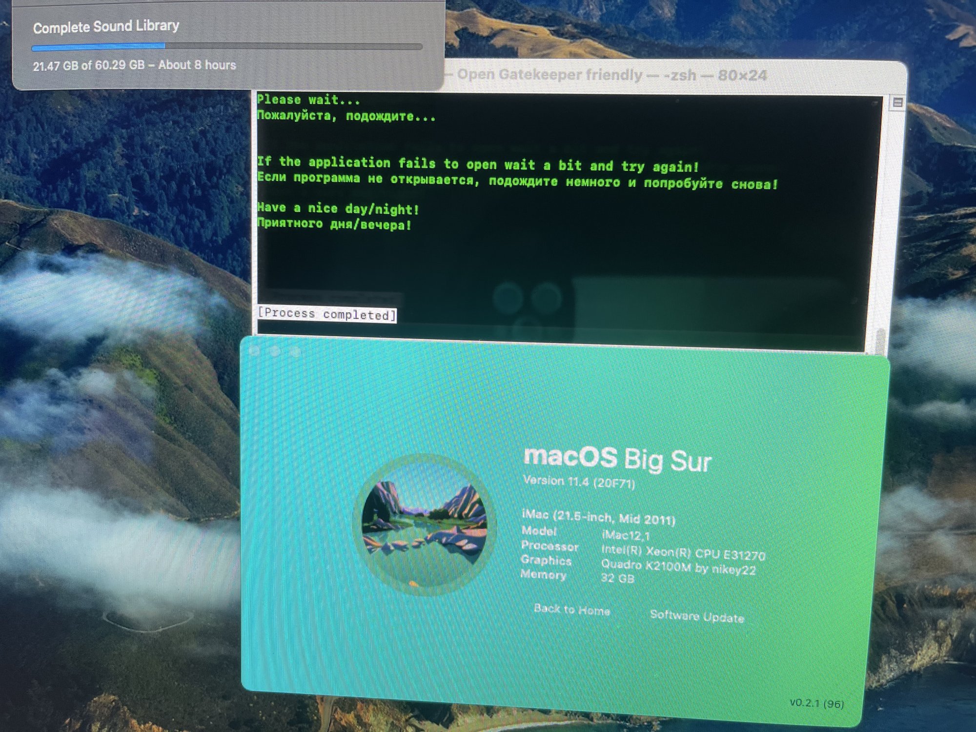

Massive Thanks to all those who have helped, given input and given me advise through my journey.
I now have a completed fully working, Nvidia K5100m 8gig card running, Mojave on my 2011 27" iMac, Im now getting messages to upgrade to Big Sur,
I am happy that I can be running Mojave after 2 years of not having my iMac working at all and fighting with the previous carrier who sent me a card that I returned it to and never got my money back on because they say it was lost in the return I was out 300 dollars for the graphics card as the insurance on the card was only 10 dollars, from now on I'll only return and insurance will be for the whole value of the card so if china loses the return the us postal service can pay for the lost package or something.
I have 2 additional cards that I received untested and unused that are for the 2011 iMac if anyone needs a card I have it in the USA and willing to sell them if anyone needs.
the K3100m 4 gig card and the 5000m 4gig card
Happy building to everyone
Anyone having advice on if Big Sur and Monterey works on the 2011 or to point me to the advice or support pages would be appreciated too.
Thanks John

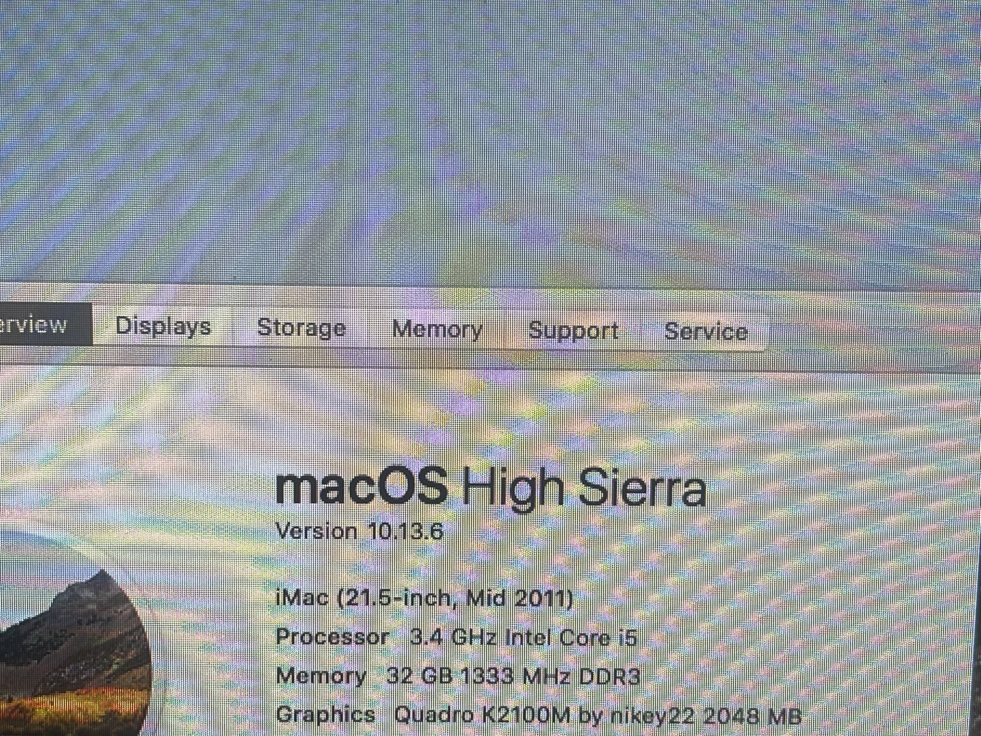

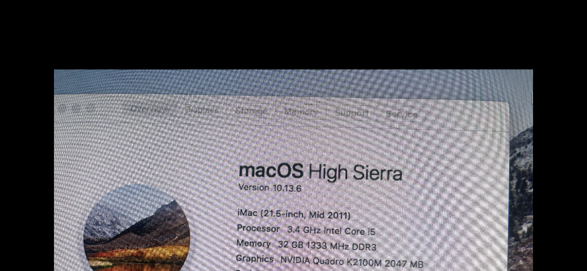

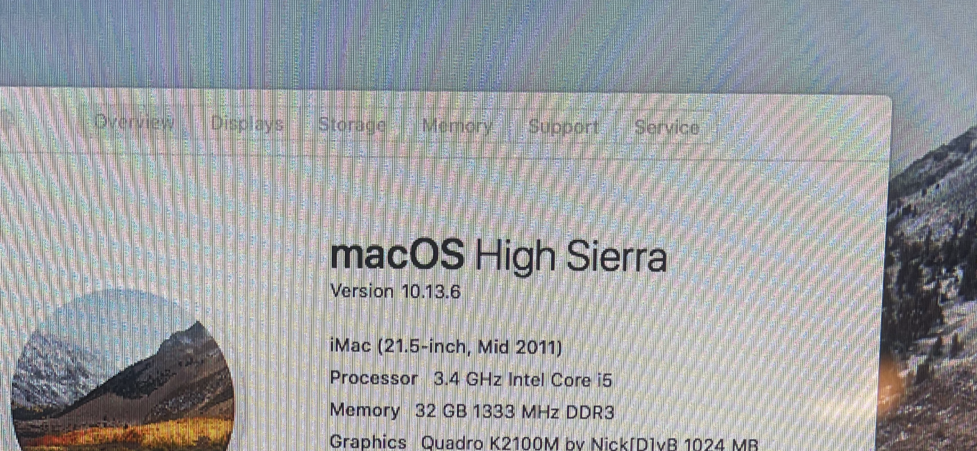

Unlike AMD cards, the vram in Nvidia cards is calculated dynamically at runtime (2047MB instead of 2048MB). The GPU controller code is addressing only 1/2 the ram. Your card is indeed 2Gb.
The following vbios should unlock the additional internal banks.
