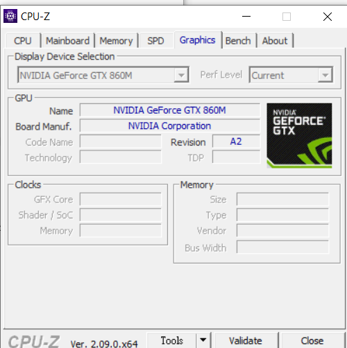

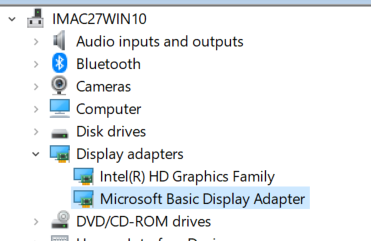

My Imac is 27 MID-2011
I install Ventura by OCLP, my graphic gard is GTX860M by Nikey22, Ventura runs pretty well.
but as I installed the window 10, the GTX 860m driver can't be found, It always shows "Microsoft basic Dispaly"
I try different N's drivers, it didn't work, How could i Fix this problem, Many Thks.

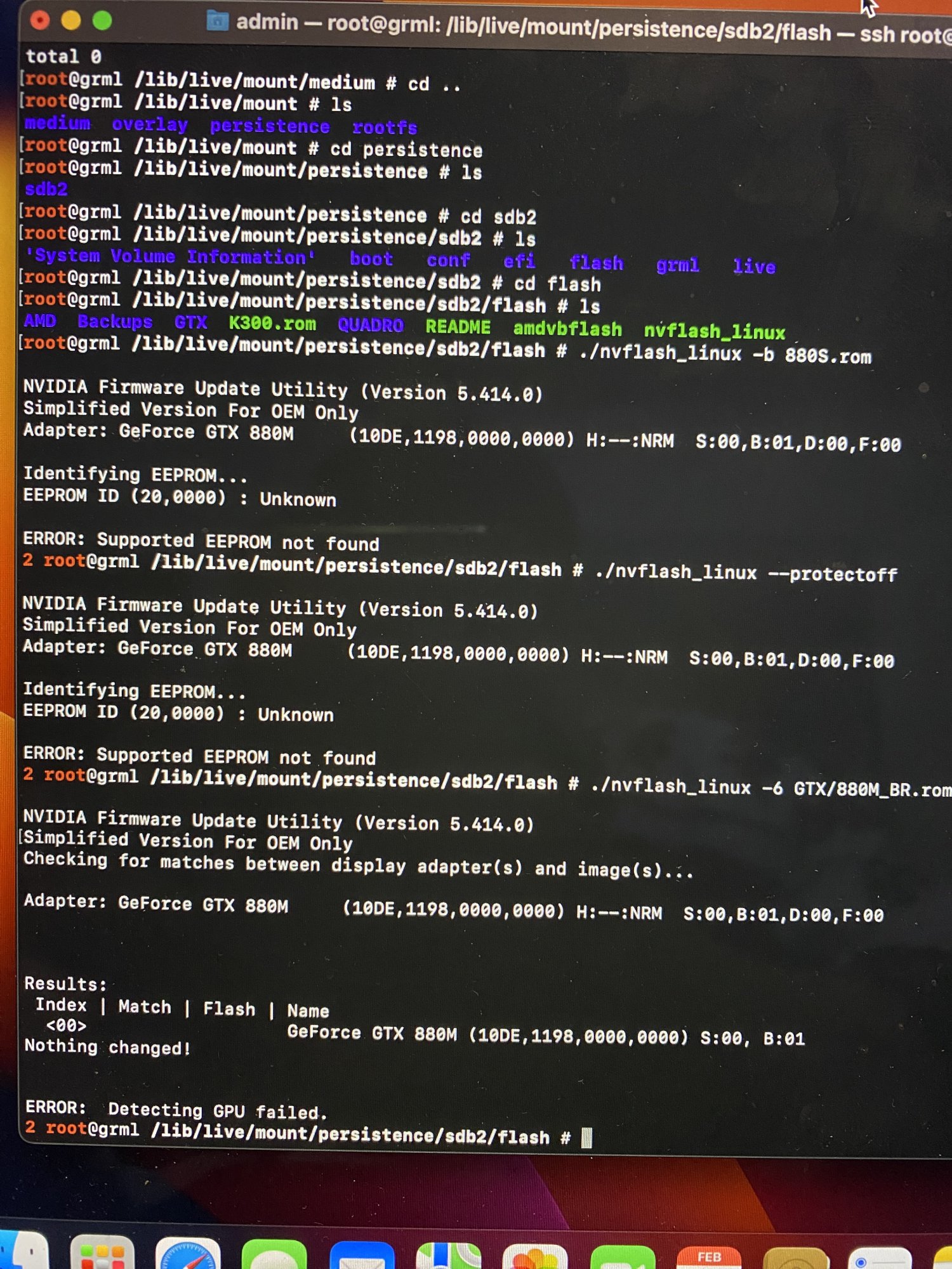

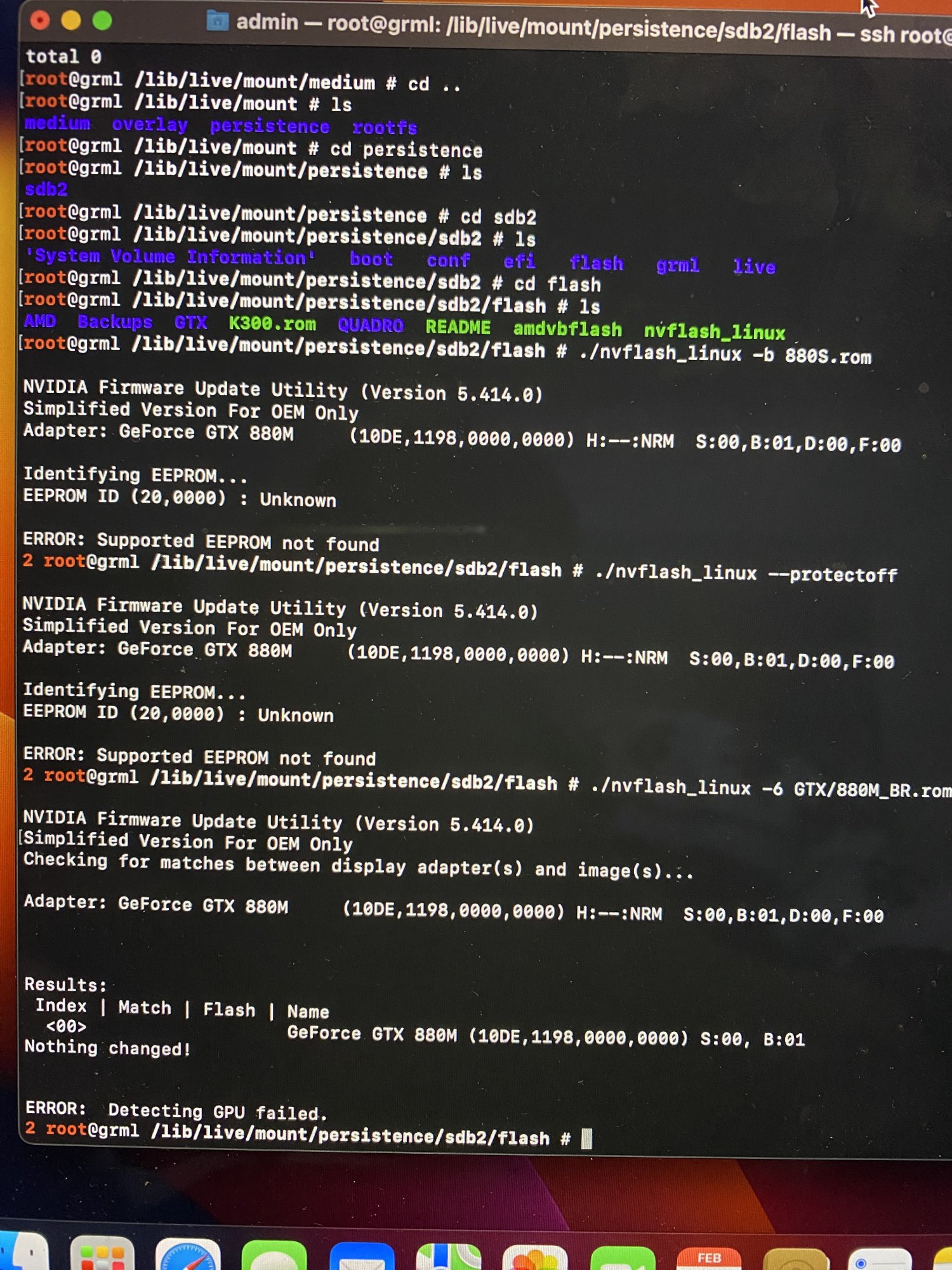

Good morning i try to flash this 880m and not work,

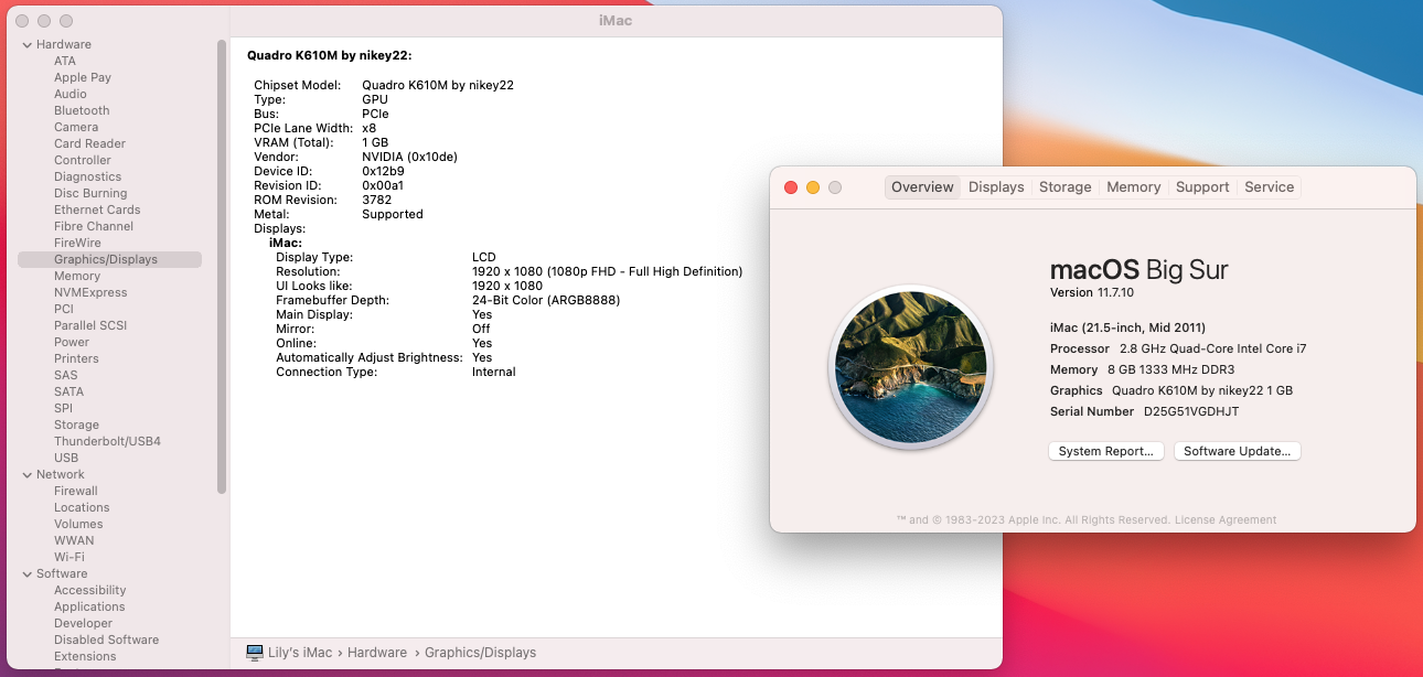

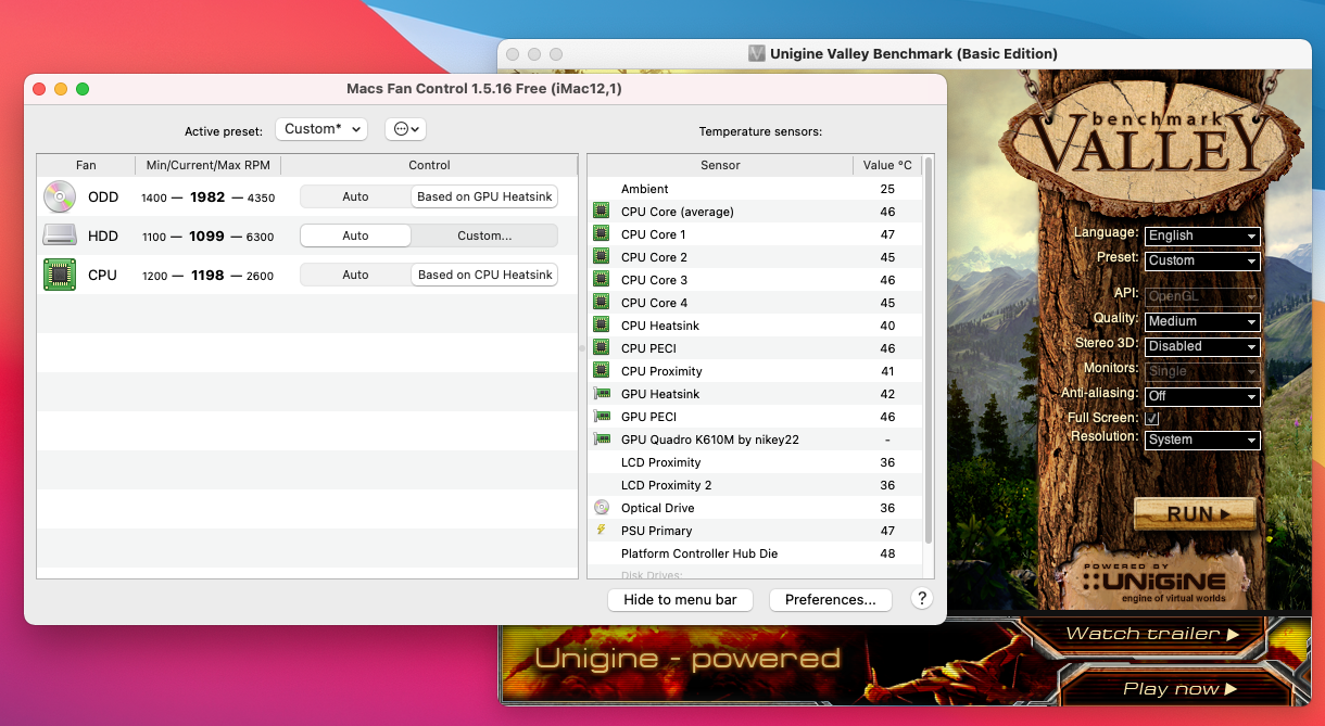

iMac 12,1 + nVidia K610M + macOS Big Sur success
Attempted AMD M4000 + macOS Sonoma (5% of sleep/wake encountered problems)
Identical Process as prior 11,x+M5100 install here
vBIOS
Flashed vBIOS link from post #1 with a 3.3v modified CH341A clip. Have seen 2 different 2Mbit BootROM chips
Saved original ROM size identical to nikey22 vBIOS so no size padding adjustment effort required.
Brightness worked fine post install, didn't need to do the tweaks in the vBIOS link. I guess everything integrated into OCLP now.
1 of 2 MXIC ROM failed to flash with CH341A due to some issue on the card preventing write enable (pin 3 is Write Enable and maybe that circuit has failure. Was able to remove flash ROM (require hot air soldering station), put on another K610M card, flashed, and put back on original card. Then worked fine.
GPU Install
Checked the heatsink clearance carefully and no shim was required on a 12,1. In fact a couple of voltage regulator had thermal pad on it from prior usage that didn't touch the heatsink so had to use thicker layer of K5 Pro thermal paste to bridge the gap
SSD Install
Jumpered pin 6+7 of SATA power supply header ( link ) to eliminate high fan spin from lacking thermal sensor inside SSD.
Logic Board Install
21.5 iMacs are quite tight and tricky. I encountered 3 problems (rip cable from logic board standing stud, knock off USB board components, knock off cable routing guide) and would guess likely common
https://sites.google.com/view/imac-metal-gpu/imac-hw-tips#h.nd734s60o4qg
OC Setting
macOS + 20min Valley Benchmark Thermal Test
Screen Shot 2024-03-05 at 2.25.10 PM.pngScreen Shot 2024-03-05 at 2.37.38 PM.png
AMD M4000 Effort
As of OCLP 1.4.0n macOS 14.3.1, sleep/wake issue noted in Post #1 is still present. However, the failure frequency was 5% (1 out of 20 sleep/wake cycles) in my 2 days of testing running with Samsung EVO 850 SSD.
PMed @madvinegar and he has similar results on 12,x + GCN v1-3. He noted GCN v1-3 cards improved quite a bit with latest OCLP + Sonoma/Ventura including faster Geekbench GPU scores from Monterey.
Anyway, if you disable sleep, will run quite well. If not, may have to live with daily reboot+PRAM resets.
Reactions: Nguyen Duc Hieu

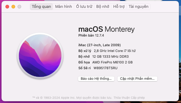

iMac 2009 (iMac 11,1, 27" A1312, core i7-870, edP GPU)
Firepro M6100 (flashed, Red Dell card)
Runs fine in High Sierra (Opencore 1,4 pre-install, but no OC boot screen, it gets to High Sierra desktop pretty fast)
Issue: I can't boot the Monterey USB Installer (OCLP pre-installed) while the High Sierra disk is still inside.
The Monterey SATA Installer (OCLP pre-installed) will boot with artefacts. I booted it and install to a external USB box with SSD disk inside. But after 20min, the screen went black, I left it cooked for another hour, then full screen artefact and nothing else.
I power-off the machine and examine the USB SSD disk on another iMac, it's half done only. I installed OLCP on the EFI volume of it.
I removed the Monterey SATA Installer and put the half-cooked SSD inside the iMac on SATA interface and boot it up. But the screen went black and I couldn't see anything to know what's running.
I removed the internal SSD, plug in the GRML USB. The iMac booted and I managed to flashed the Overclocked version of vBIOS made by Nickey.
After this, I put a Windows SSD inside the iMac, booted up and still got black screen.
As the previous High Sierra SSD was formatted in the previous steps, I'm now trying to clone the High Sierra volume from another iMac to see whether it still boot-up with the new vBIOS.
If not, I'll try the third vBIOS made by @Ausdauersportler to see.
If you have any suggestions for my situation, please share. Thank you!.
