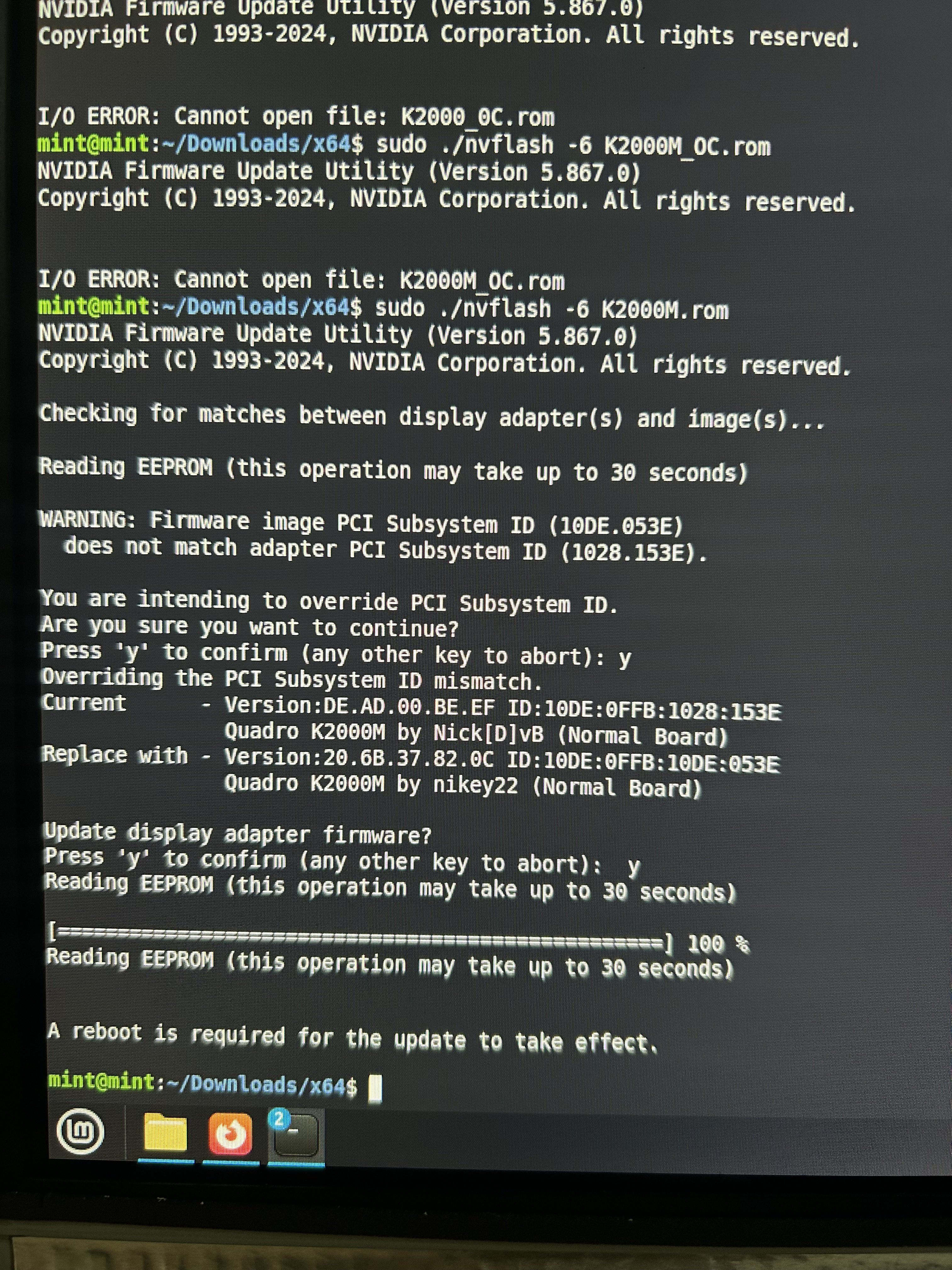

Hi guys, please help me. I'm a newbie.
I have:
1. 2011 iMac 27
2. SSD upgrade
3. Memory upgrade
4. Video k2000m with BIOS 3782 flashed. High Sierra works fine on this configuration and doesn't cause any problems, but I upgraded to install a newer system, and I need your help setting it up. The problem is: when I install a new OS version, everything works fine. But after installation, I boot in safe mode and patch OCLP, everything works, but Metal doesn't work. If I select the 13.1 model in OCLP, after a reboot, Metal works fine, but the network doesn't work, and OCLP complains about an incompatible EFI. Help me set it up. Maybe the card is flashed with the wrong ROM?
Guys, I solved my problem. I simply re-flashed the card with the correct ROM from the first post in this thread, and everything worked perfectly.

Hi,
This forum is a bit too long to go through, I'm looking for a specific VBIOS to upgrade a Late 2009 iMac, C2D 21.5in (10,1). I have a spare NVIDIA Quadro K1100M MXM graphics card from a Dell Precision M4800 and am looking to replace the 4000 series ATI Mobility Radeon card, so I could potentially install Linux or enable Metal in macOS Sequoia (it works fine as is with OpenCore Legacy Patcher, albeit slowly).
I found a VBIOS file on this forum that was supposed to restore the boot screen and work with OCLP, but it just leads to a black screen on the Mac, however long I wait (I don't mind losing the boot screen if it still works). I even wiped the cloned SSD from OCLP install on original HDD so I could force the Mac to boot from USB installer (High Sierra, Linux Mint). Nothing works, I'm happy to reflash the GPU again as I have 2 Dell laptops that have MXM slots and integrated graphics for this job.
Please let me know if anyone has K1100M Mac VBIOS that works will Dell version of the GPU.
Thanks!
