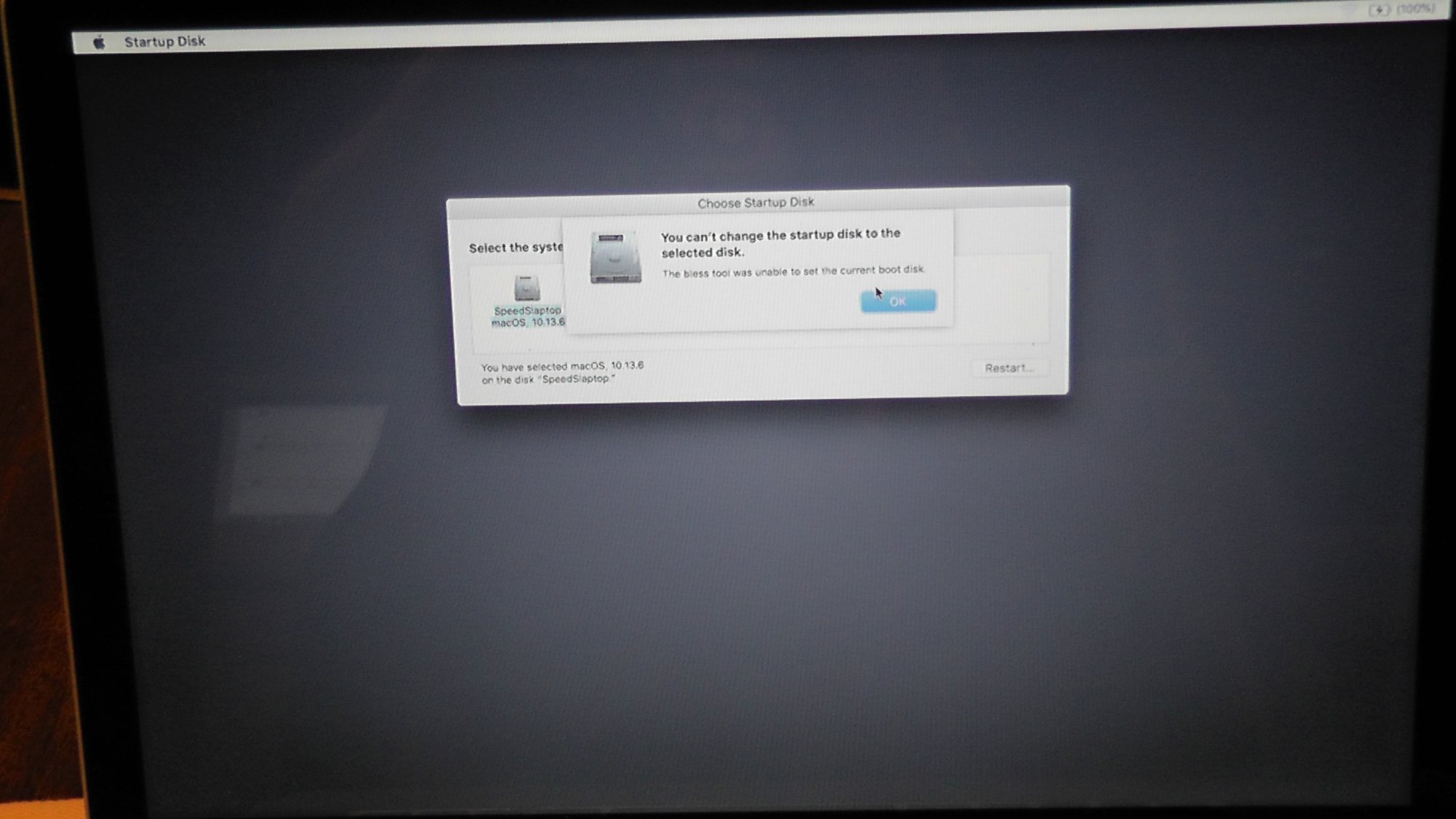

This is the error I get when trying to change the boot disk with the picker in internet recovery mode:
Are you certain that you are in internet recovery mode (you see the spinning globe when entering that boot mode, not just the normal Apple icon)? Apple extended that function to the 2010 models (which were one year back when that mode was first released in 2011.) So, it works, but perhaps not completely functional. I don't really know if that is result, but the 2010 models, in fact, had that function added later.
Anyway... "bless tool unable to set current boot disk" often means that the system install is either not complete, or not correctly installed.
Probably will be fixed by reinstalling High Sierra on that partition. Keep in mind that older, spinning hard drives are not optimized for use with High Sierra - mostly because the install will expect an APFS format, and High Sierra works best with an SSD. If you do not have an SSD in that MacBook Pro, then I believe you would make a good choice by replacing an old hard drive with an SSD.

It says that error for ANY disk I put in or attach, and it does the same for the original disk that was in there. I really couldn't care less what OS it has on there if it works at all. I won't be using the thing, and actually the HDD that was in there performed above expectations, so I don't need to go out and blow 30 bucks on a cheap SSD.

I cannot reinstall MacOS if the MacBook doesn't have an internet connection, which it doesn't, which is odd considering it's literally called INTERNET RECOVERY mode, which grabs from the INTERNET, ya know?
Not ethernet nor wifi do anything in this mode. I don't think it was like this when this MacBook worked last.
Also the number of disks I tried is around 10. Yes, I actually have that many laying around.
It also spits out the same error for any bootable flash drives, or anything else.
I don't know why the startup disk pane in Internet Recovery might do that (tell you that it can't change to the selected boot disk because of a supposed bless tool issue), but try the Option-boot manager this time, just to check that does -- or does not -- work. I would test two different drives that should be bootable (and that you know work on other Macs)
