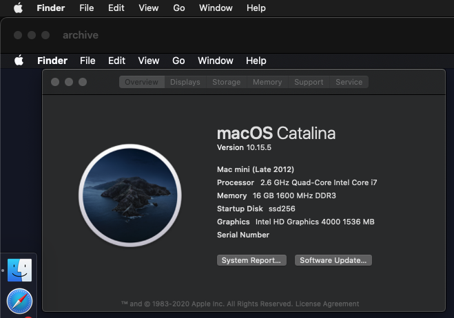

I was able to cancel my ebay order, and I opted for a better mac mini still 2012 but with 16tb and a fusion 1tb SSD/HDD(half and half) It was 220$ Canadian bought from someone so I got it the next day
Got it all set up and it works like a charm for infuse and I'm sharing with a cousin for plex.

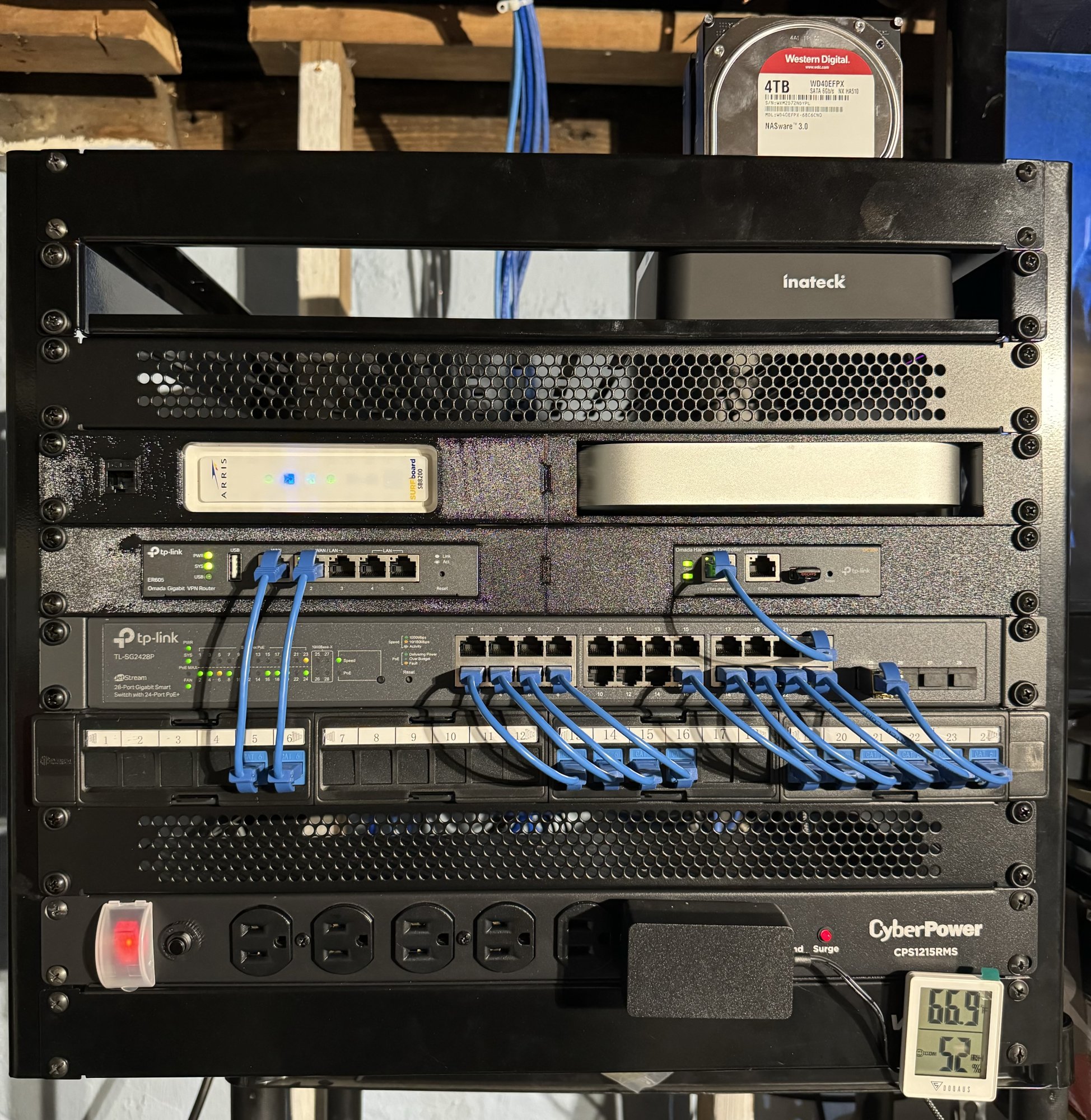

Mine opens right up in screen sharing. It runs (headless) 24/7 as a file server and time machine destination with four 5tb hard disks attached and MacOS on the original internal SSD. I have a base 2014 Mini that I use as a dedicated media server.
