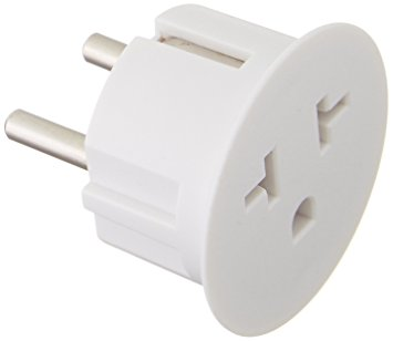

Yeah, i meant the detachable part that connects to the actual wall, and if you were using it with a US to EU adapter like this one:
Because those are AWFUL and you should never use it with something like a computer. Just get the right cable accessory, you can get the official apple one for €25, and see if that fixes the problem.

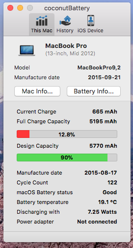

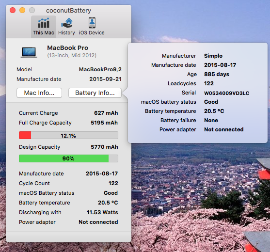

Here it is. But I don't think the battery is manufactured in 2015 (but somewhere I read that it's not too reliable in this case)
It's said it's in good condition, but I'm not getting more than (max) 4-5 hours, with normal using.

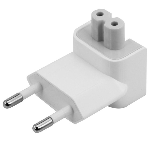

Regarding the plug, we're using this type in EU, so I had to replace this part anyway, because apple recalled these.

Talk about coincidence.
I just used Coconut Battery to check MY battery (2015 MBPro 13"), and it has a cycle count of 122 -- same as yours above.
Mine shows 95.1% of design capacity.
I try to recharge regularly around the 50% mark.
With the older-style MBPro's (I have a 2010), I don't think the 4-5 hours that you're getting is "out of line".
90% is nothing to worry about.
