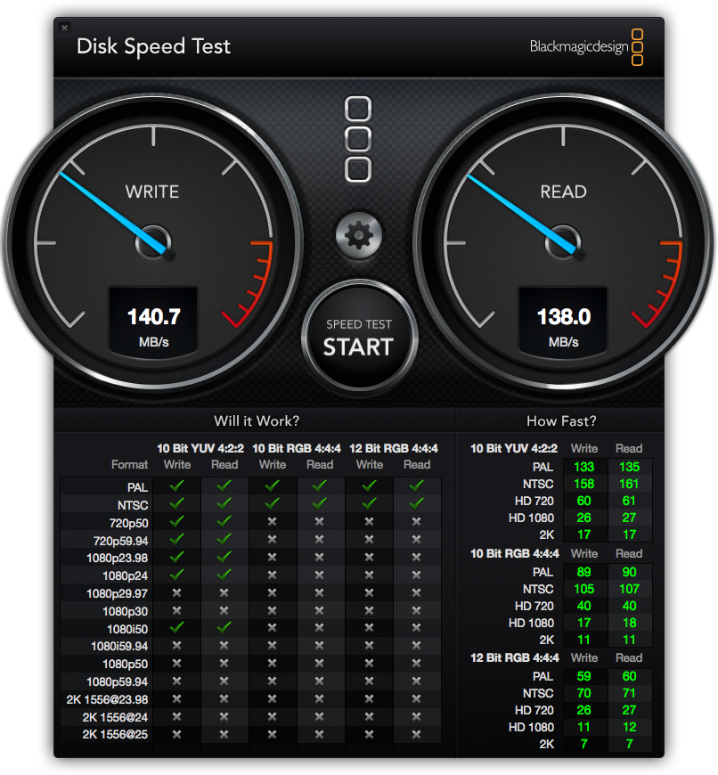

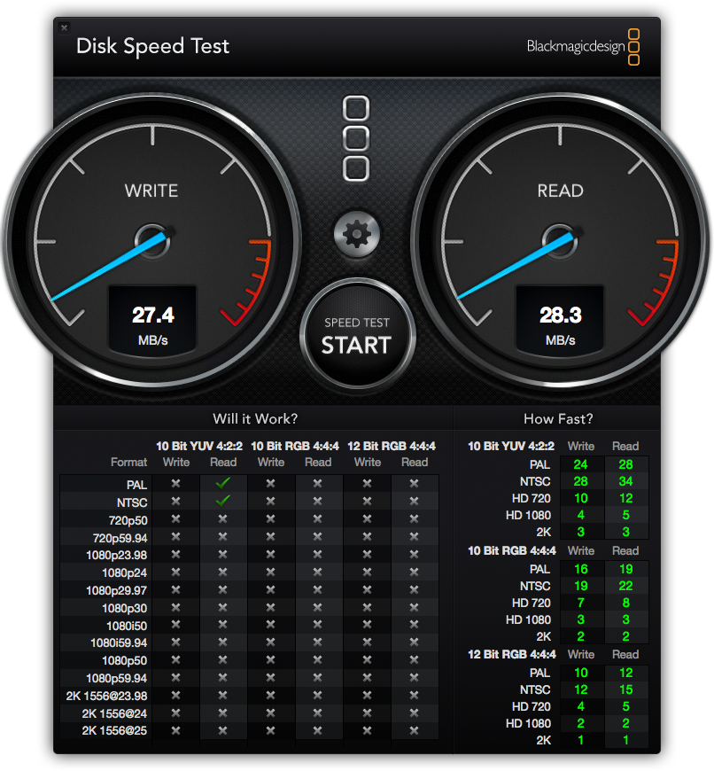

Internal SSD too slow
Anyone having issues with OCZ Agility 3
too slow for 550MBs drive
but, my WD Passport essentials USB 3 is also very slow.
So im about to erase external drive and run another benchmarking
Actually, I don't mind if they work slower than supports to work, as long as they fast enough for my tasks.
any suggestions
any suggestions

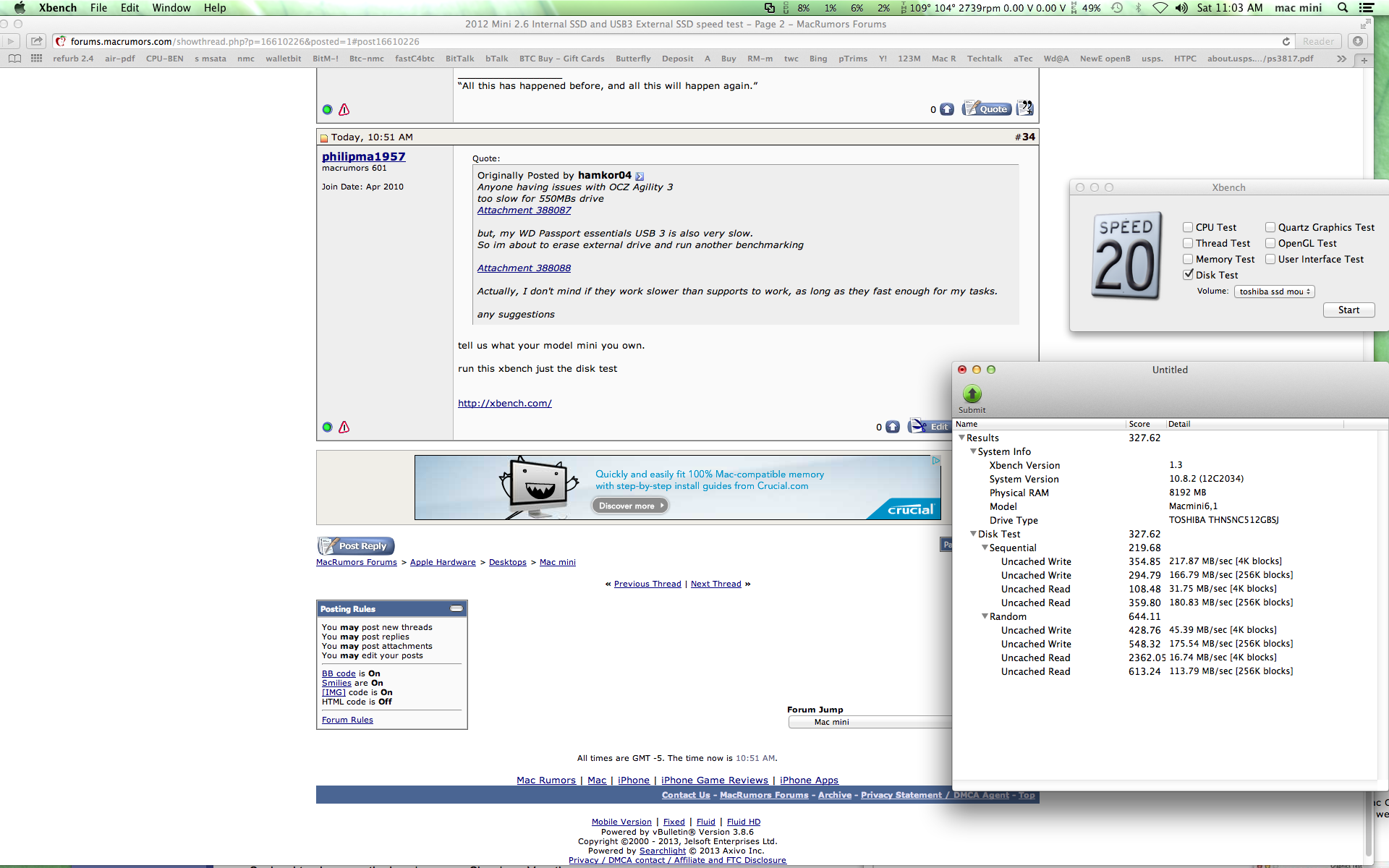

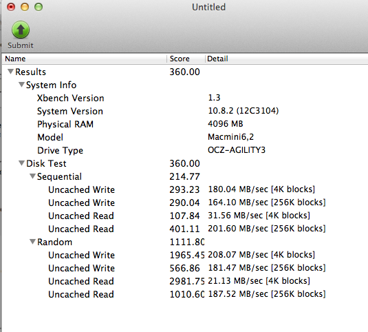

tell us what your model mini you own.
run this xbench just the disk test
http://xbench.com/
your results will be in this format see thumbnail. my ssd is a sata II with max read writes of 240/210 so my 220/180 is close. I am on a t-bolt connection which does lower speed a little.
http://xbench.com/

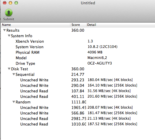

mac mini 2012 i7 2.3GHz
this ssd supposed to be 500/550 w/r
any ideas? :(

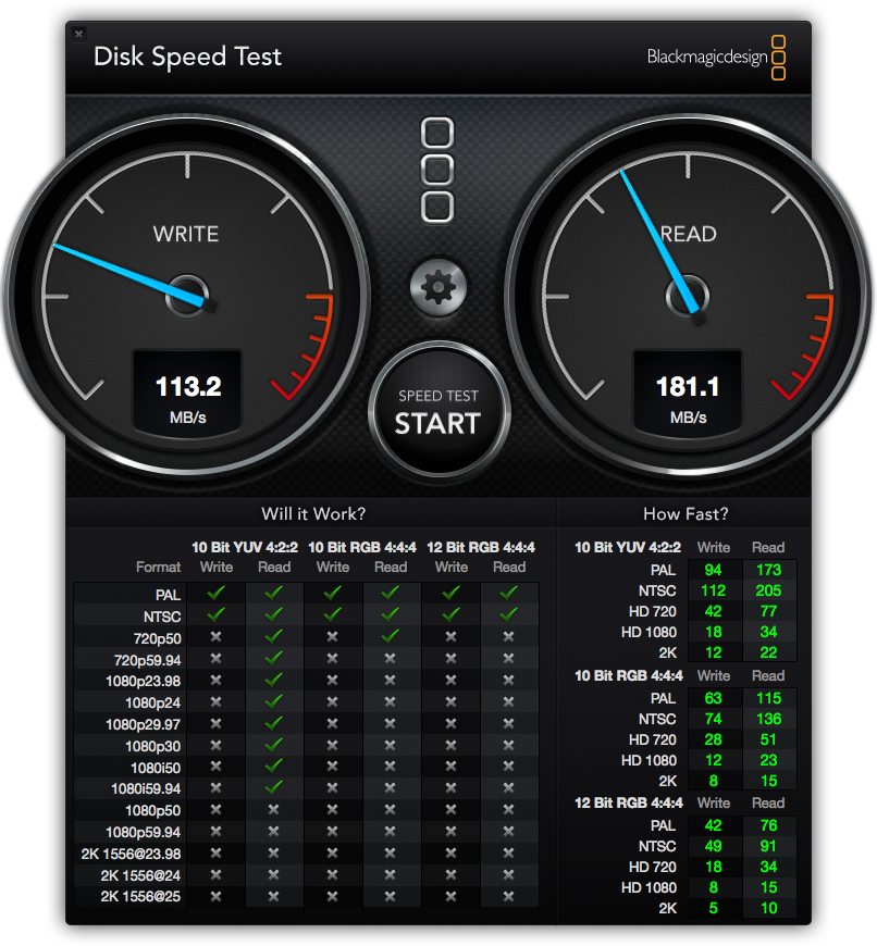

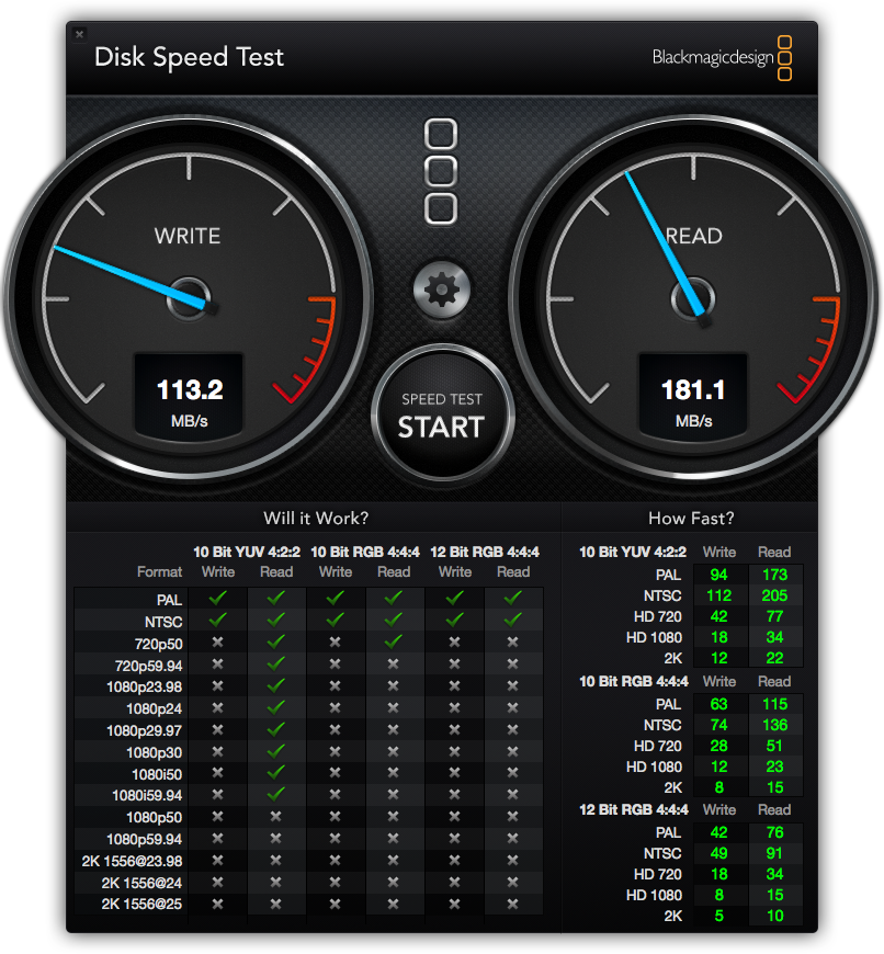

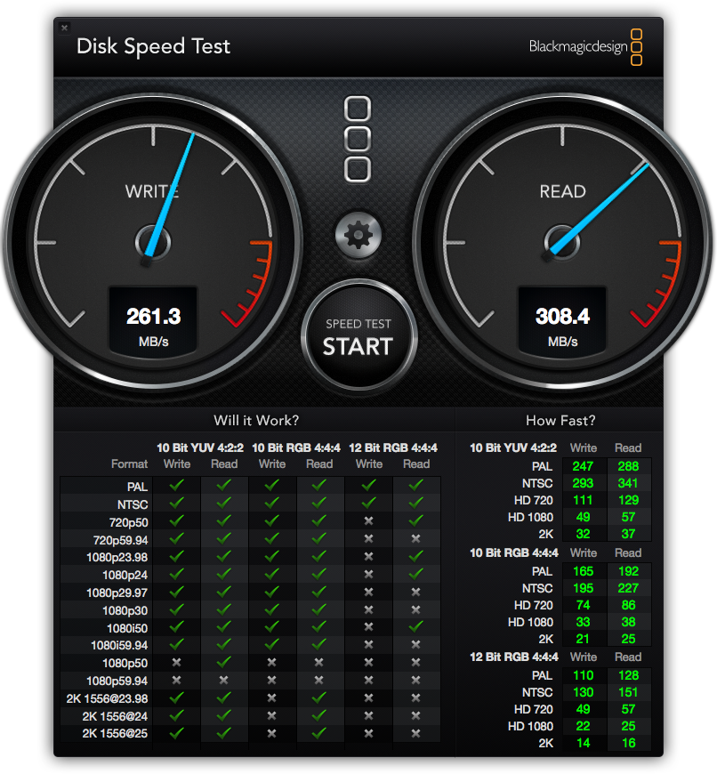

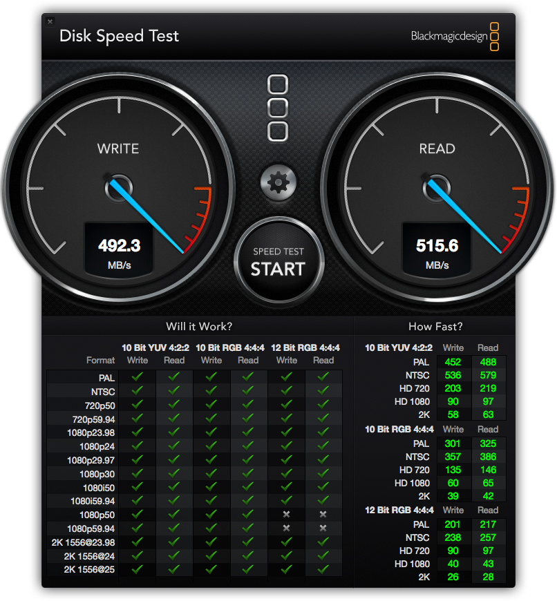

Thermaltake slow...
Hi.

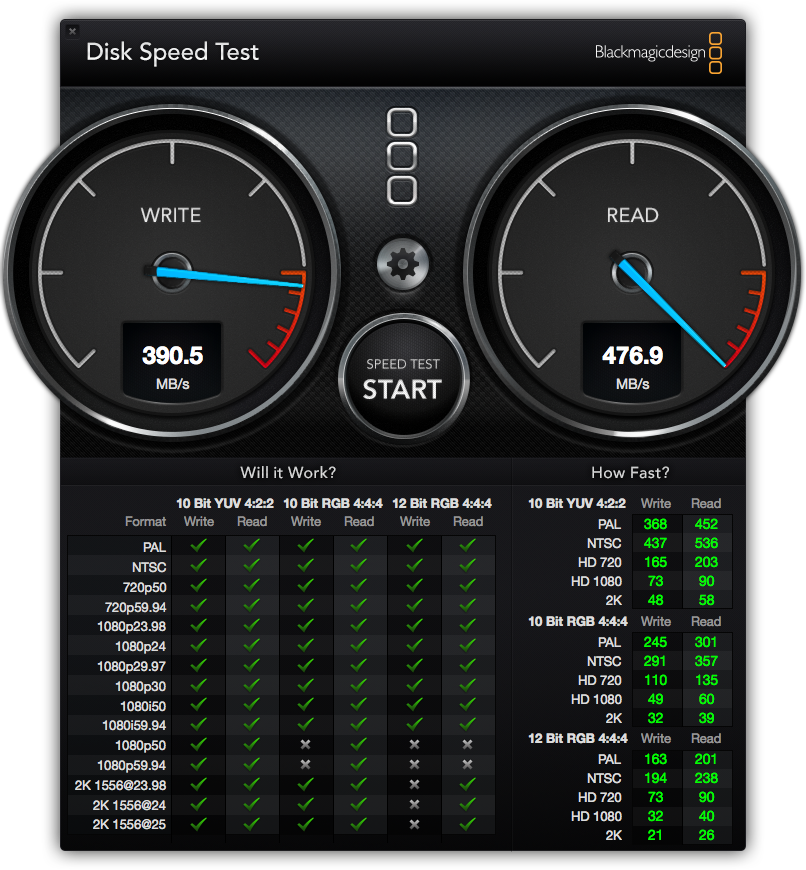

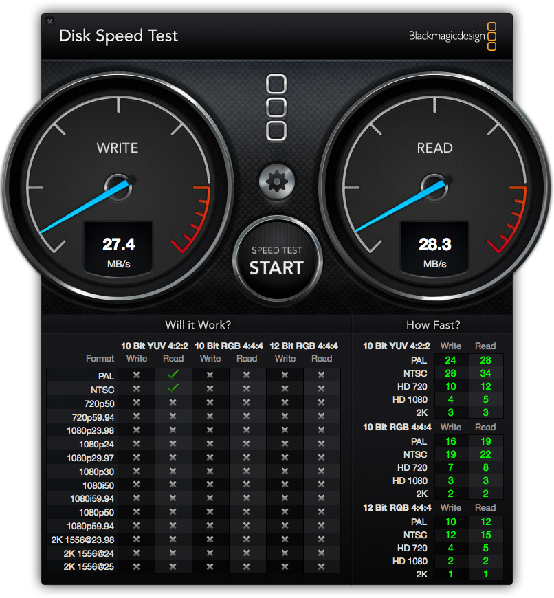

After reading what propower had reported, I purchased a couple of Thermaltake enclosures, but I am not getting the same speed readings.
The machine is a 2012 mac mini quad 2.6. I cloned the internal drive to a Samsung 840pro256 via thunderbolt goflex desk, took the mini apart and mounted the 840pro OS drive in the lower bay as well as a samsung 830 512 in the upper bay. The mini appears to run real fast with all of that plus 16GB crucial ram....
but,

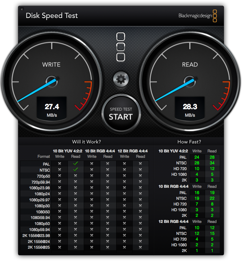

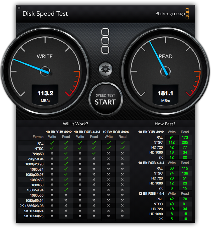

when i connect the thermaltake (with a samsung 840 500GB (non pro) just like propower) i get way slower speed readings. Here are the blackmagic screenshots, 840pro 256 internal (top left), 830 512 internal (top right), 840 500GB external/Goflex Thunderbolt and 840 500GB external Thermaltake USB3.
The system shows USB3 as super speed btw...
Anyone have any idea why this could be..? Thank you all.

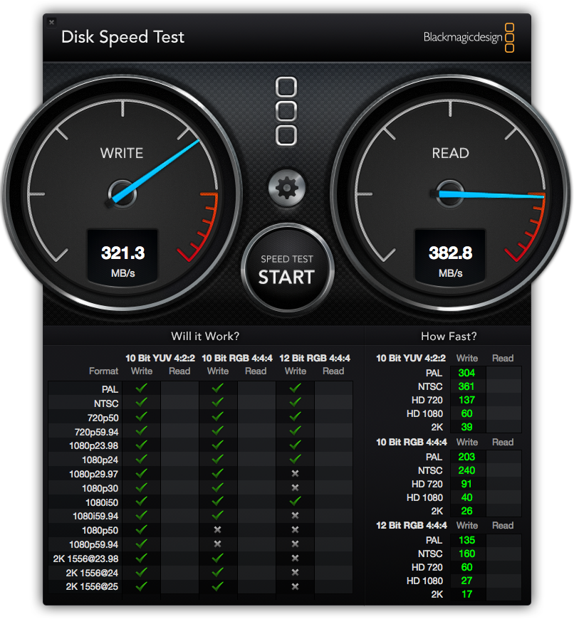

just reran my test - performance is the same
just reran my test and taking the default 5GB file size in BlackMagic gives about the same result
Write = 320
Read = 430

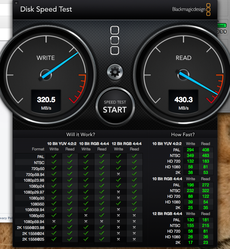

Thermaltake Silver River 5G case
From System Profiler
AS2105:
Product ID: 0x5106
Vendor ID: 0x174c (ASMedia Technology Inc.)
Version: 0.01
Serial Number: 00000000000000000000
Speed: Up to 5 Gb/sec
Manufacturer: ASMedia
Location ID: 0x14b00000 / 1
Current Available (mA): 900
Current Required (mA): 36
Capacity: 500.11 GB (500,107,862,016 bytes)
Removable Media: Yes
Detachable Drive: Yes
BSD Name: disk1
Partition Map Type: GPT (GUID Partition Table)
S.M.A.R.T. status: Not Supported
Volumes:
disk1s1:
Capacity: 209.7 MB (209,715,200 bytes)
BSD Name: disk1s1
Content: EFI
Sam_500G:
Capacity: 499.76 GB (499,763,888,128 bytes)
Available: 131.83 GB (131,829,665,792 bytes)
Writable: Yes
File System: Journaled HFS+
BSD Name: disk1s2
Mount Point: /Volumes/Sam_500G
Content: Apple_HFS

i also tried all the USB ports even if i knew it wouldn't make a difference, and of course it didn't....
i mean, 260/310 is still plenty fast for an external drive... but why so much difference between readings from two machines/controllers/drives that are practically identical...?
my mini is brand new and still empty. it is to be configured as a sequencing machine running primarily Logic and i would really like to sort this USB3 mystery out before committing to the process of installing/authorizing the s#itload of plugins and VIs needed.
ideas anyone..?
thank you all in advance

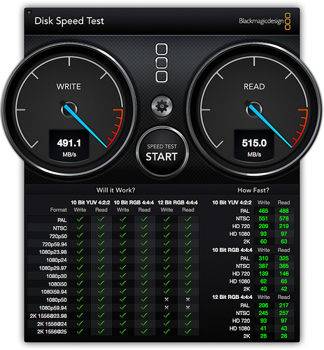

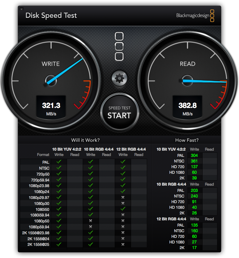

Just for comparison, here are the results of my Samsung 840 250GB (Non Pro) SSD installed in the 2.3 Ghz 2012 Mac mini...
is anyone else getting the same performance as propower with thermaltake silver river 5g USB3 and a Samsung 840 500gb?
yesterday I visited a friend that has a 2012 MacBook pro i7 2.6 quad and I hooked up the thermaltake/samsung in question. write and read speeds with blackmagic were around the same as what I'm getting with my 2.6 quad mini.
I also hooked up a crucial m4 to the thermaltake controller and got pretty much the same results with read speeds just a tad faster.
so, apparently the only thing that's different between my mini and propower's mini is that his came pre-configured by Apple with a 256 Sam 830 and mine is just a stock 2.6 quad that I upgraded myself.
wouldn't it be odd if it came down to that...?
I searched around the forum for other reports on the Silver River 5g but I can't find them....
any ideas? :(
I know this is an older post, but the problem is that the Agility 3 SSD's use very slow asynchronous memory that does not do well in Imcompressible benchmark tools like Black Magic. When it comes to Sandforce drives, only the ones that use Toggle Nand will do well in Black Magic (i.e. Vertex 3 Max IOPS, Patriot Wildfire, Sandisk Extreme, etc. etc.). Any of the others will do relatively poorly. The Agility line by OCZ is the slowest of their Sandforce drives.
