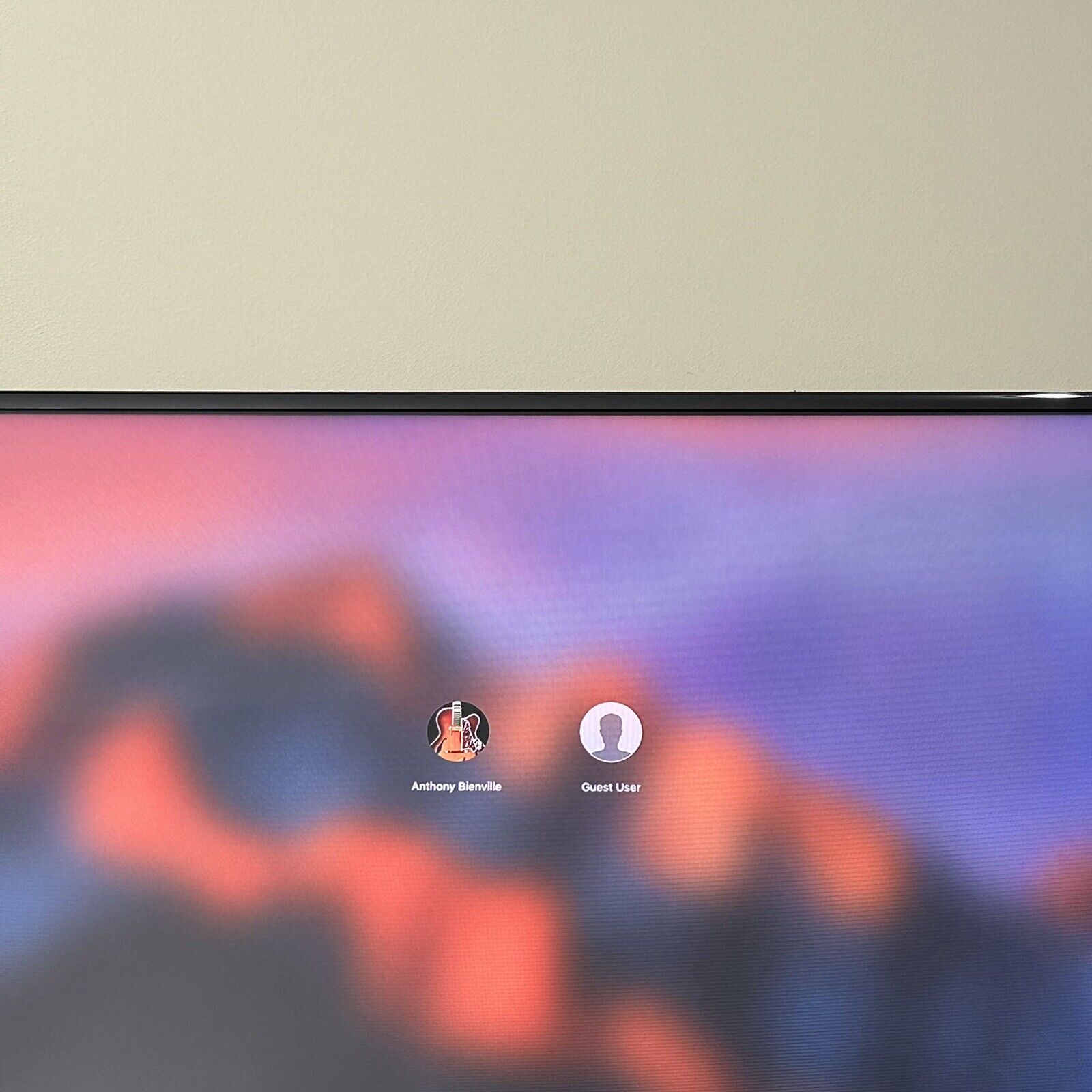

This is the picture he sent me on how far he can get too. so when i get it i going to try to install mac os 10.11 or even linux on it. thanks for the help i am getting. he told me he doesn't know to much about apple computers.
PaulD-UK
macrumors 6502a
Oct 23, 2009
557
264
That's the Mac OS user account password, which is removable during boot up I think.
But if Anthony Bienville has an iCloud Account/password set, which he hasn't cleared from his account on one of his other devices, then this Mac will not be iCloud 'clear'.
Reactions: _Mitchan1999
