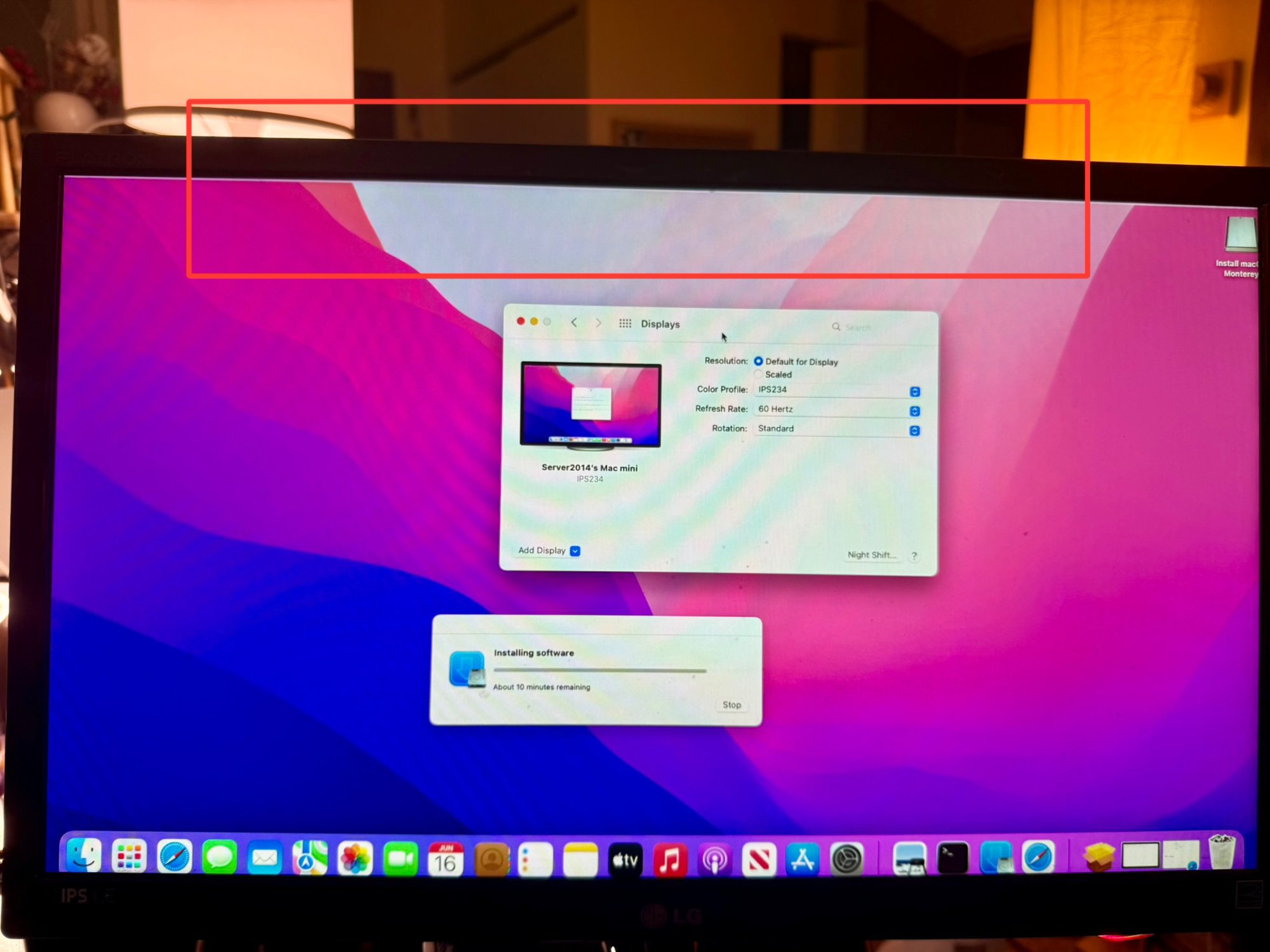

sorry for the phone pic but it's the only way to show you how cutoff the top menubar and some of the dock are:
This is called 'Overscan' on TVs.
Some monitors have it as well as a legacy feature, where it's controlled by an OSD setting, and is completely independent and unaffected by any computer setting.
Does you monitor have this set to 'Overscan ON'?
OMG HALLELUJAH!!! Thank you! I dont know why I didnt check this first - would have saved me hours of troubleshooting!! (Im still learning) Thank you it worked!!!!
