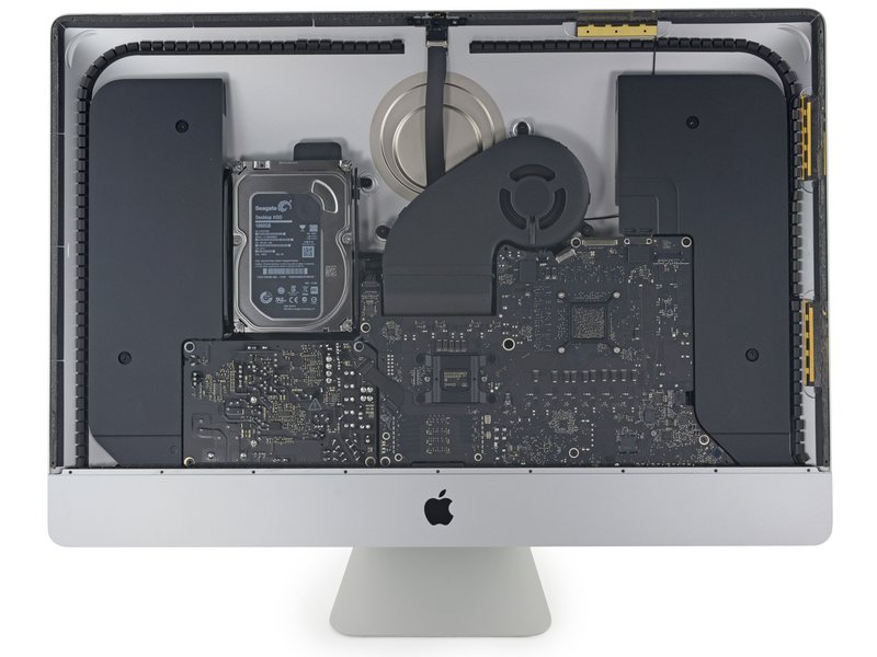

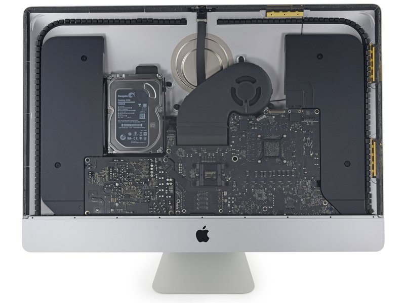

The thermal design of the Imac is upside down. Heat will rise but Apple fan tries to suck it down to leave the chassis at the bottom.
Thats not smart and I believe thats the design flaw. Heat will build up within the chassis. The fan is designed to remove the heat from the cpu and gpu. The remaining components (like power supply) will obviously also generate heat. Where will that go?
Look at the picture. At the top in the middle there is a gap between the "ribon" like insulator. Heat will be happy to go there and it will build up behind this insulator. Thats a very likely cause of the pink edge. Second, everything else will slowly heat up. There is no natural escape for the heat.
I am now looking into removing the apple logo as a test. It sould provide a natural path for heat to escape and avoid heat accumelation. If that works I will likely dril some holes into the back at the top to allow airflow and hence heat to escape.
I attached a picture i found on internet. From edge of the screen to the inside: First the sticky tape to hold the display, second the "ribbon" like tape, followed by the motherboard hardware.
