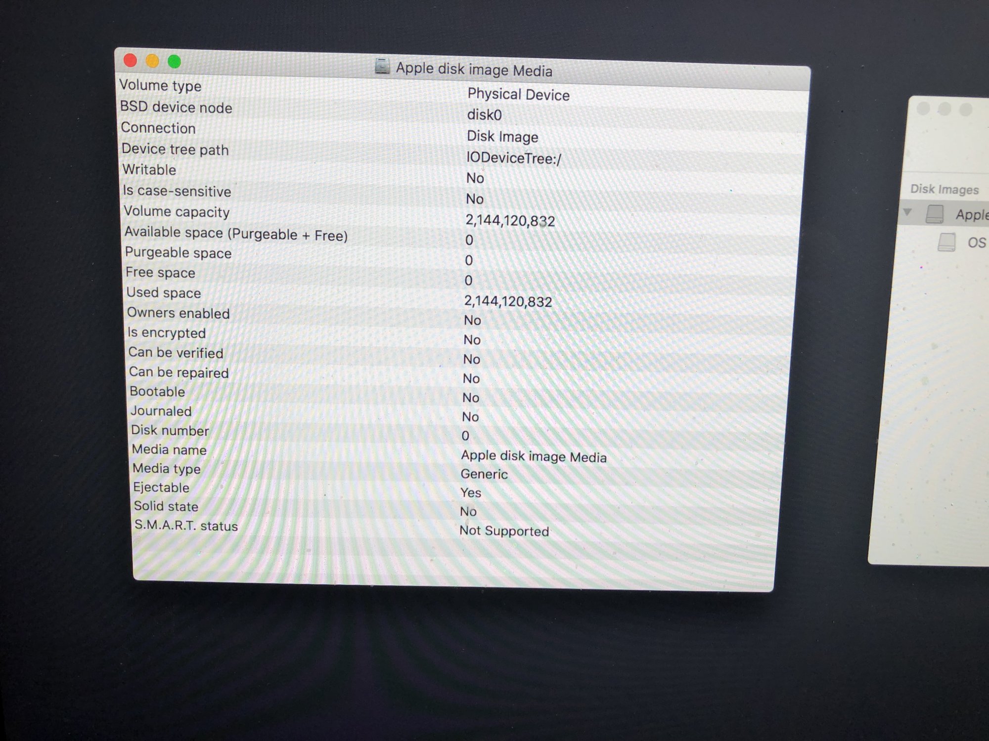

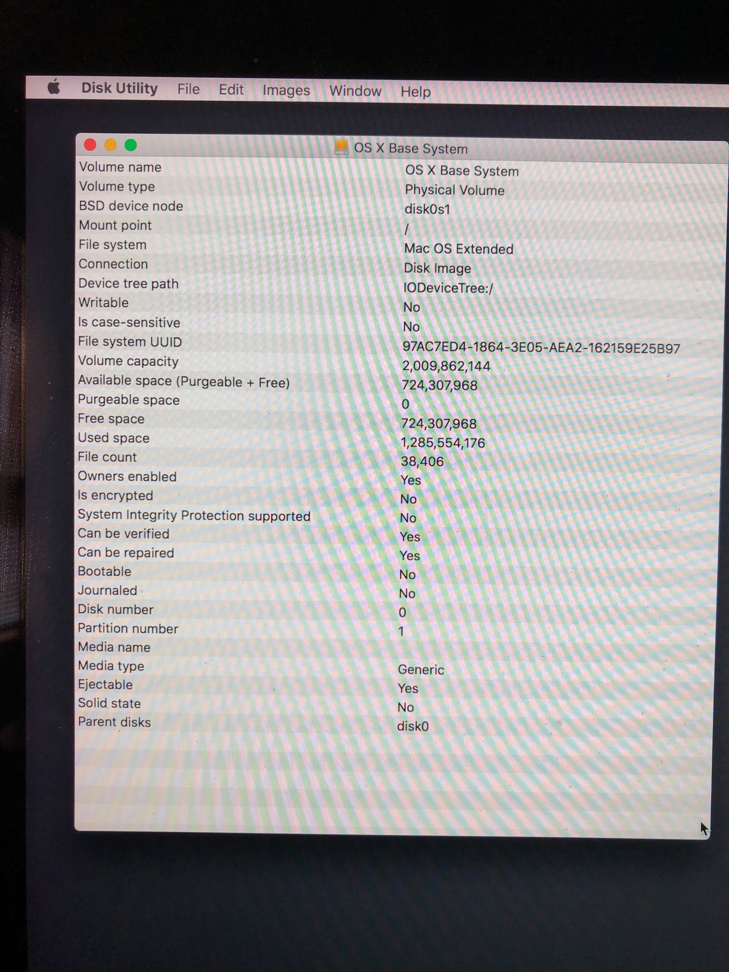

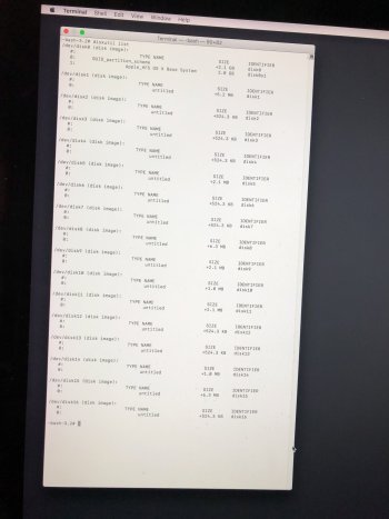

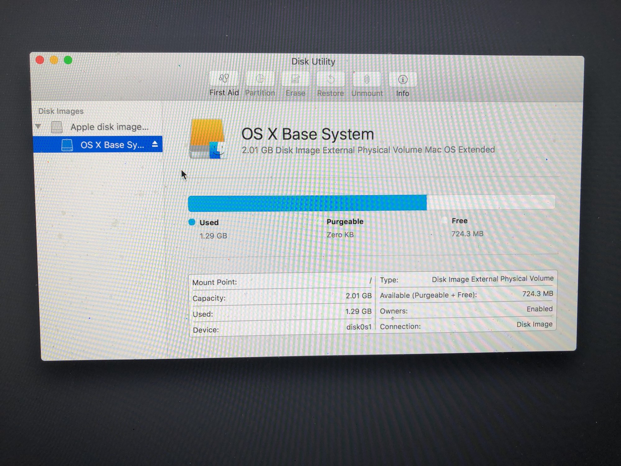

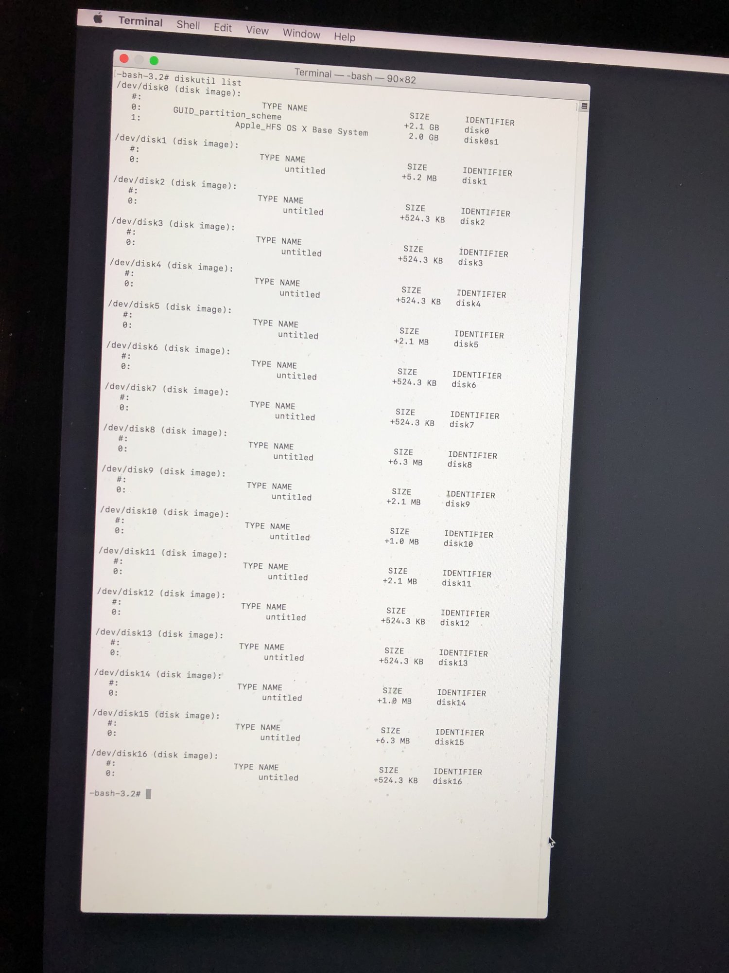

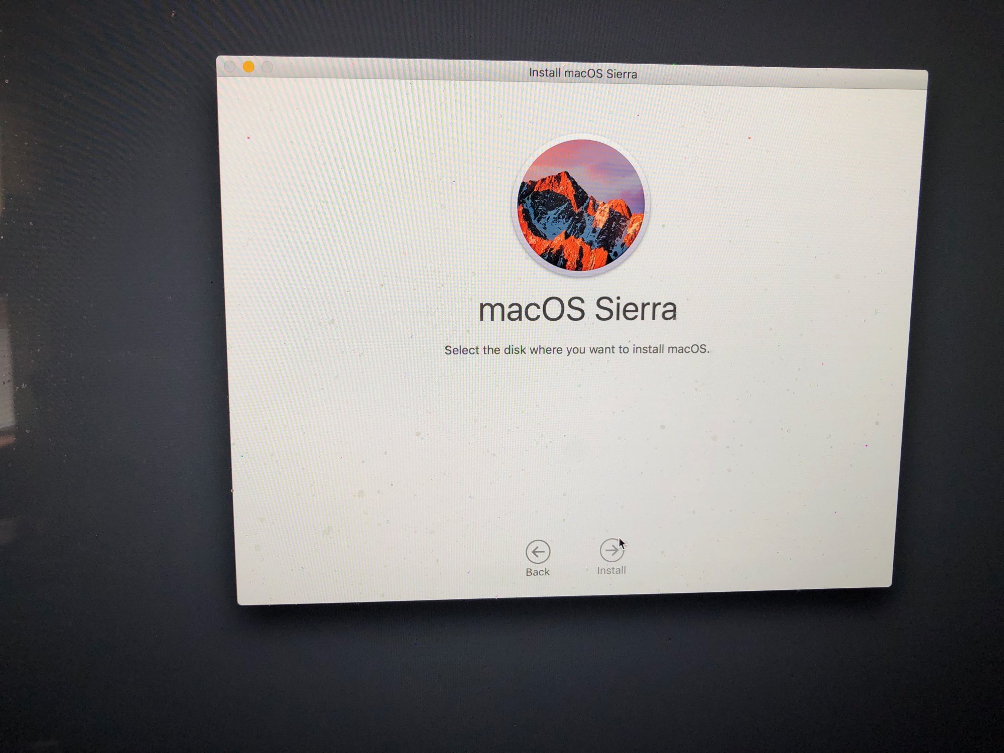

My parents have a Late 2015 27" iMac with a 512gb internal ssd that was running OSX Monterey. I can get it to go to recovery mode just fine, but when I try to reinstall osx (which is osx sierra) it doesn't see the internal hard drive.

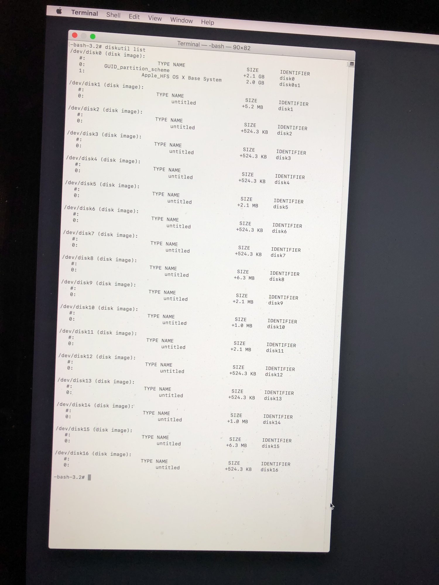

Using the terminal command in recovery mode I get this listing when I use diskutil list.....
I have a feeling this has something to do with the ssd being converted to APFS. There seems to be a lot of random disks showing in the list. I have seen videos on YouTube of people using the terminal command to clean up and manually reformat the ssd. i think that may be the problem here as the recovery portion is just fine.
Any suggestions on what commands to reformat the ssd so I can install a new osx on this?

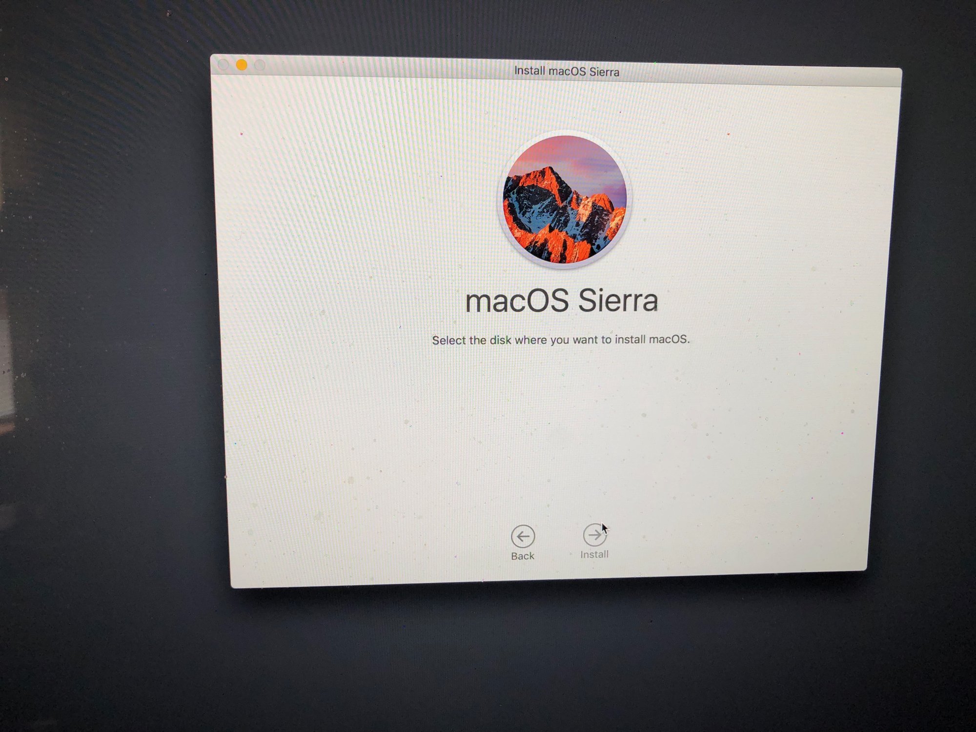

Also I was trying to run it through an external ssd, I managed to get a CCC external running, but when i try to connect a second external ssd drive to it and install an new version of Monterey, it never sees the external ssd.

Did the Monterey system have a problem?

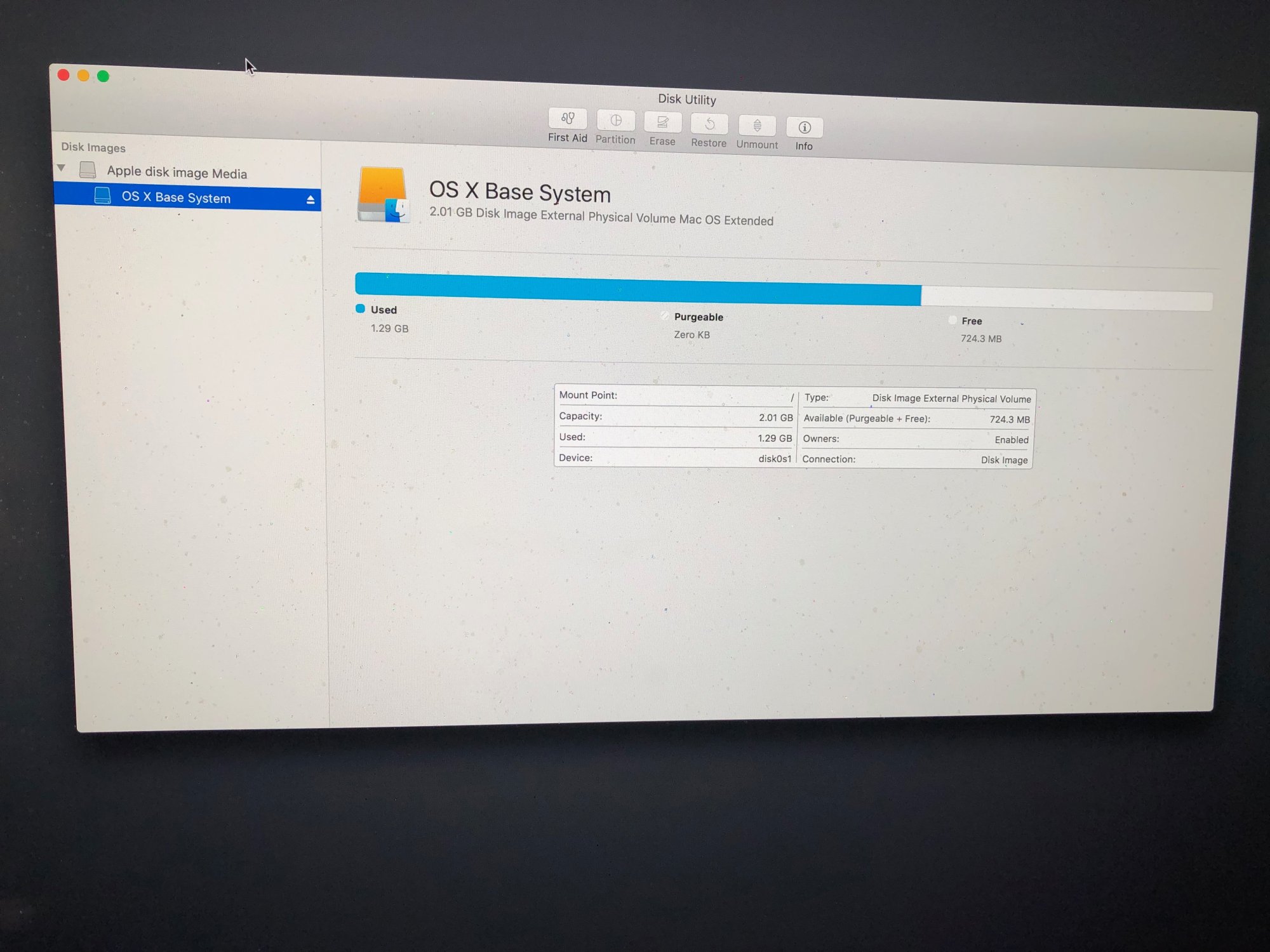

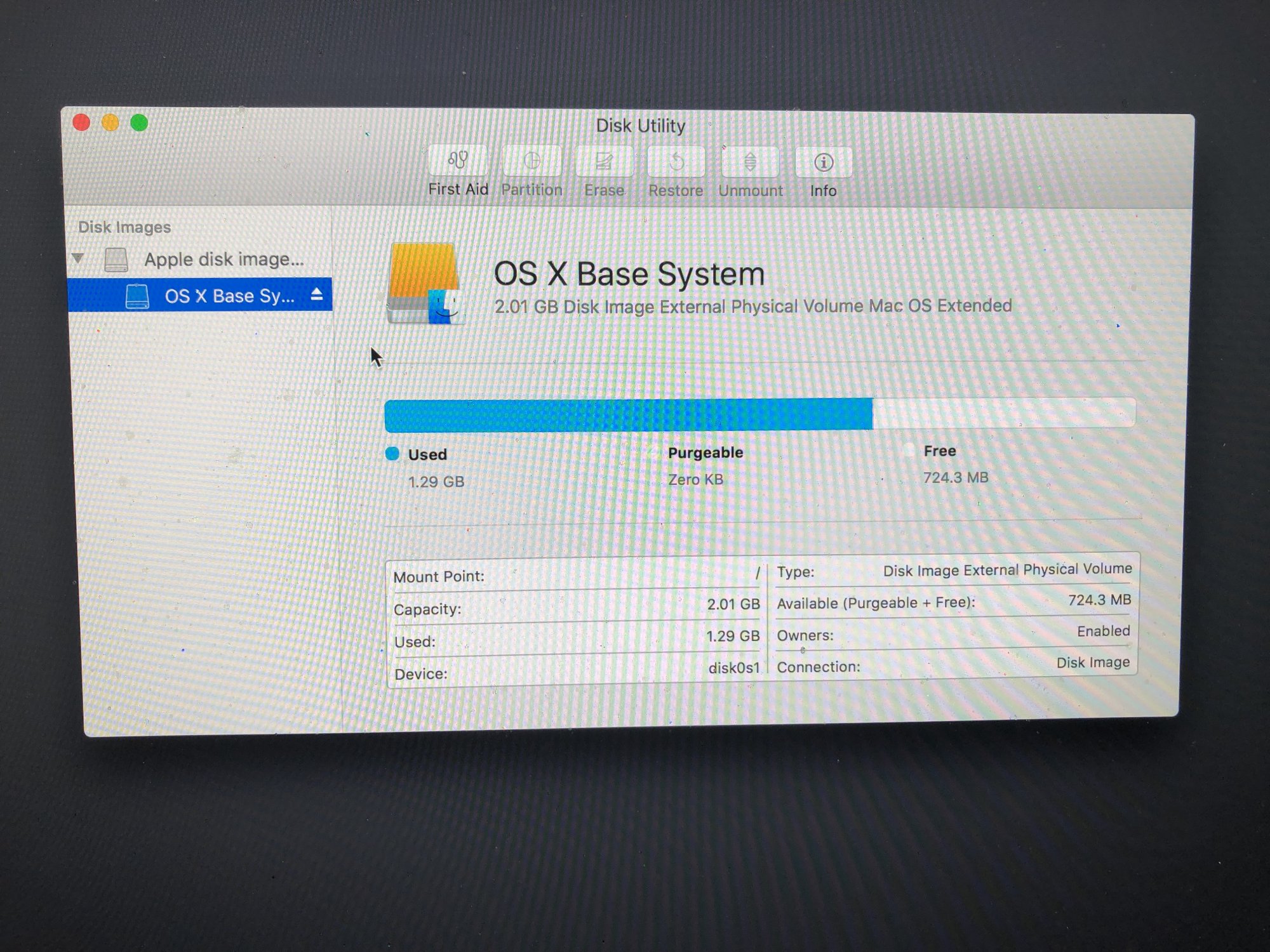

I think you need to boot to a system newer than Sierra, as it likely does not see the existing drive, as the Sierra install may not see the drive at all, when a much newer system is installed.
It does concern me when the drive itself is not appearing in the diskutil terminal window.
You see only the Base System, which is not on your iMac at all--it is just the system used to boot your iMac, and is on Apple's remote server
I would suggest making a bootable USB installer for Monterey.
Boot with that bootable installer, THEN open Disk Utility. Do you see the existing drive then?

Not seeing the volumes, etc on an APFS disk is expected with OS X Sierra's Disk Utility.
Booting with Command-Option-R will give Monterey disk utility, at which point you'll be able to verify (or if necessary, format) the disk & install Monterey.

The OPs Late 2015 iMac should boot (with Internet Recovery) to the oldest macOS that still supports that model, which should be El Capitan, or maybe Sierra.
Neither of those are likely to see the Monterey drive correctly, and both are too old to have the option to "Show All Devices"
However, the list on the left in Disk Utility, even on those older MacOS, should show that there is an internal device, even if the volumes are not displayed. (The "Base System" is NOT an internal drive, and not helpful to troubleshoot)
I also suspect that the OPs internal SSD has failed, but best chance to see the drive will be when booting from a newer system, such as a Monterey installer USB drive (or at least High Sierra or newer)
There are two ways to boot IR on a 2015 iMac. Command-Option-R will load the newest compatible version of macOS (Monterey). Command-Shift-Option-R will load the original version (El Capitan).

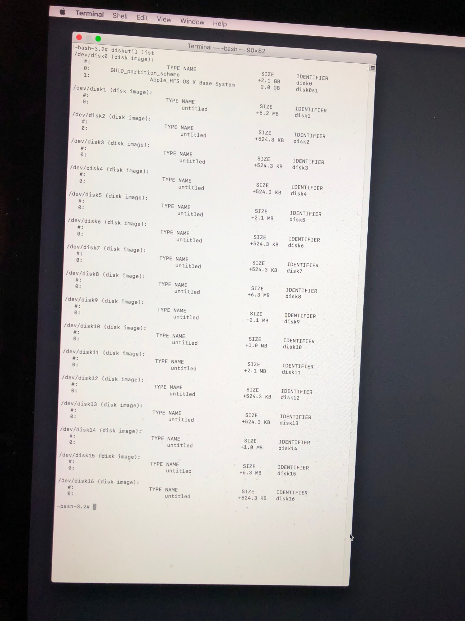

So looking through the replies, my question is.....
Where does the boot drive live?
Can the rescue disk be OK and the main SSD be bad?
That part of this I'm not understanding.

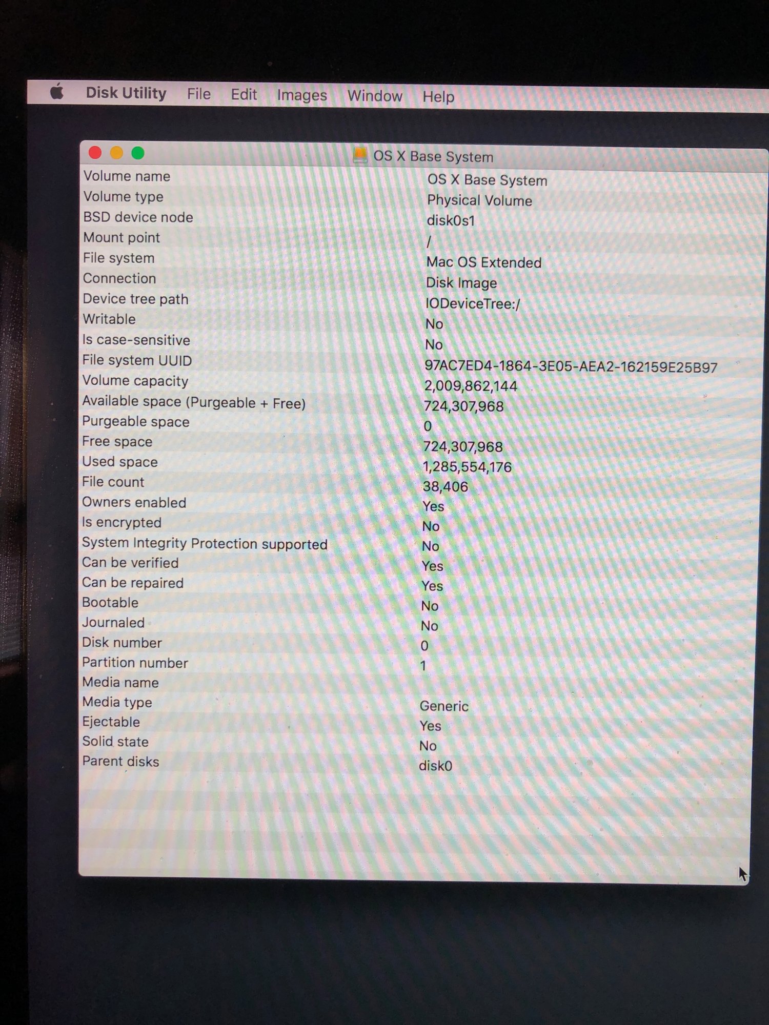

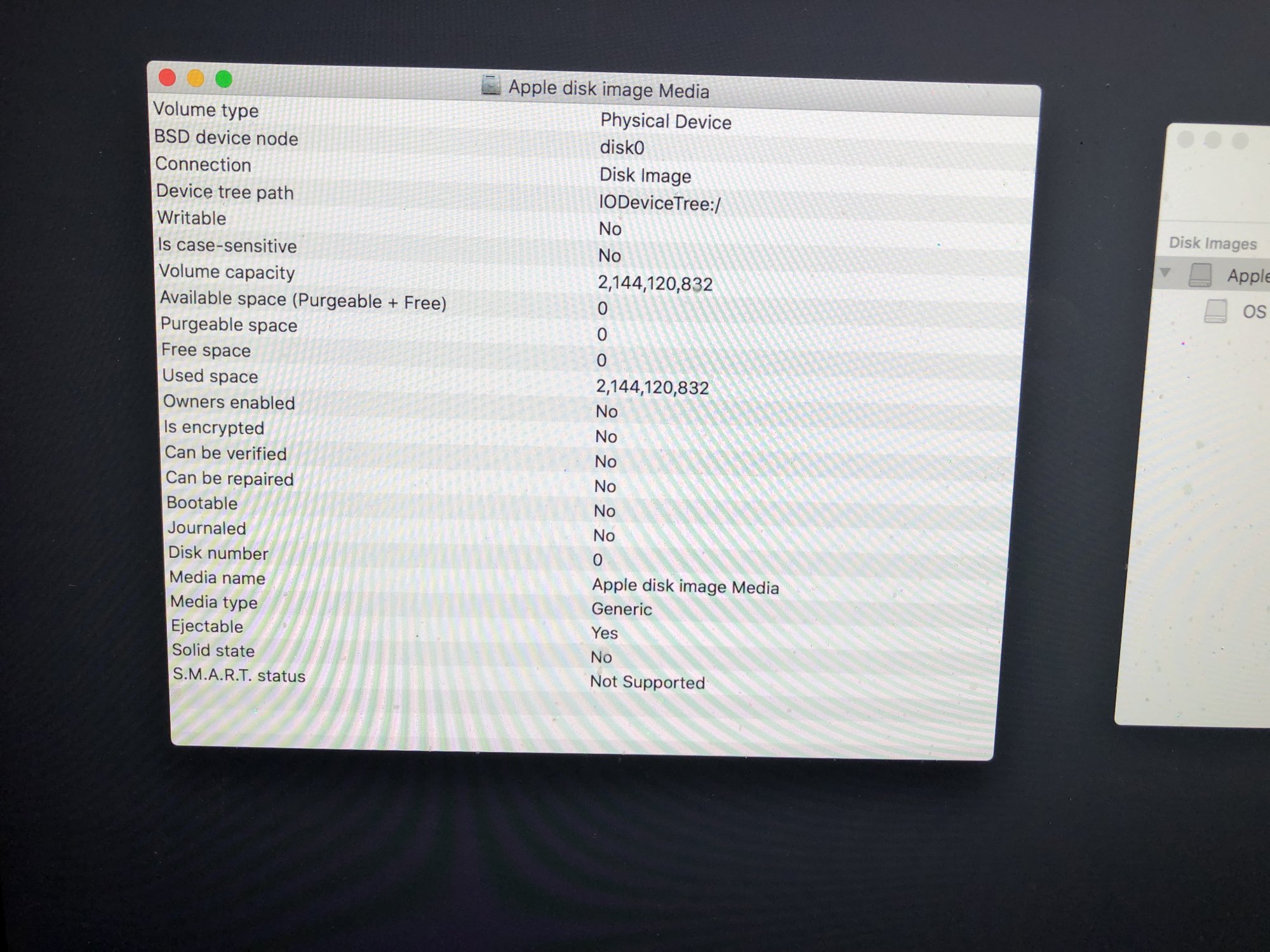

"Apple disk image media" and "OS X Base System" are virtual in RAM. They're not on any storage medium at all.
Totally possible that the SSD is bad.

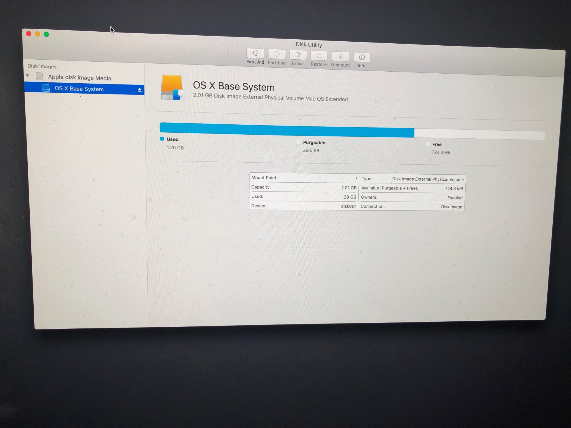

Thanks for the reply, this has been a learning process on the recovery disk. I believe the disk must be bad because when I do the internet recovery and start diskutil, the boot disk shows up as an external disk.
I am just confused why the diskutil list command shows a bunch of 500gb partitions that don’t show up in diskdoctor. Booting from a Monterey boot up disk with instal program doesnt show the internal drive in disk doctor.
what are my disk replacement options?

You know what Im a moron, I just looked through that "diskutil list" listing and I so wanted a sign life that the ssd didnt die I didnt notice the 512kb wasn't a 512gb, I didn't put two and two together. Add to the fact that I now know the rescue disk is in ram, I should have noticed that the 512 was in KB.
Sorry for wasting every ones time, its the first time i had a disk problem with one of the iMacs a reinstall didn't fix. I still hate the idea of just throwing this computer away.

Your screenshots from post #14 are the same that you posted in your #1 post, which is from a Sierra boot.
Can you show the same set of screenshots, but from when you are booted to the Monterey USB boot drive.
One major difference will be in the Disk Utility. Monterey Disk Utility will have the choice to change the View option to "Show All Devices"
