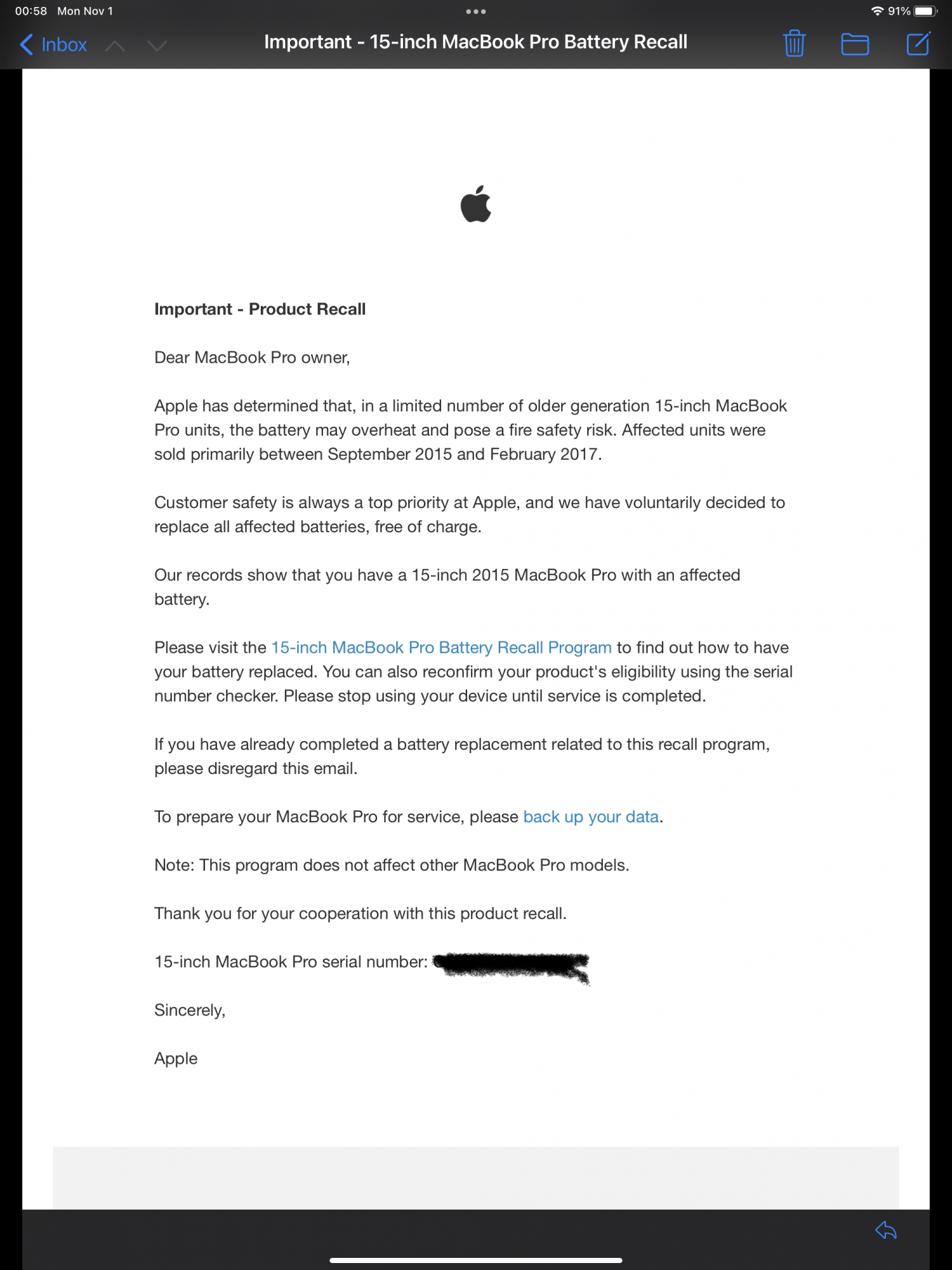

Hi Jony Five
I realize that your MBP might not meet this criteria and am writing this in case you might not have seen/received this notice.
I got this in late 2019 and had conflicts so couldn't immediately get it replaced, then COVID hit, etc. Anyhow, when I did later poke around to get the replacement process started, zero tech support folks seemed to have any idea about this recall.
If you think your MBP was from around this time, it might be worth it to dig around and see if yours has had a battery recall, as well,
Here's the link to the recall page: https://support.apple.com/15-inch-macbook-pro-battery-recall

Thanks, I vaguely recall that. I’ll check back in my email ‘late 2019’
You don't have to check your email.
On the link that KeniLF posted above:
You can just enter in your serial number and it will let you know if your 15" 2015 MBP is eligible or not.
If it is eligible then you just take your MBP to the Apple Store (or mail it in) and they will replace the topcase/battery/trackpad for free.
Reactions: KeniLF
