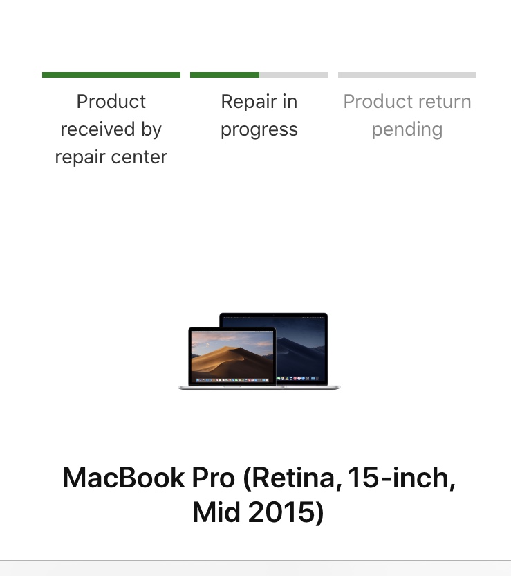

I took my MBP in last Wednesday for the battery repair. It arrived at the depot today. It went from diagnosing to repairing in one day, hopefully meaning that it’s quick. The genius at the Apple Store recommended that Apple replace the top case as part of the repair program as well. Is this common practice with Apple? If so that is good news.Hopefully it comes back next week.what has the experience been for everyone here?
