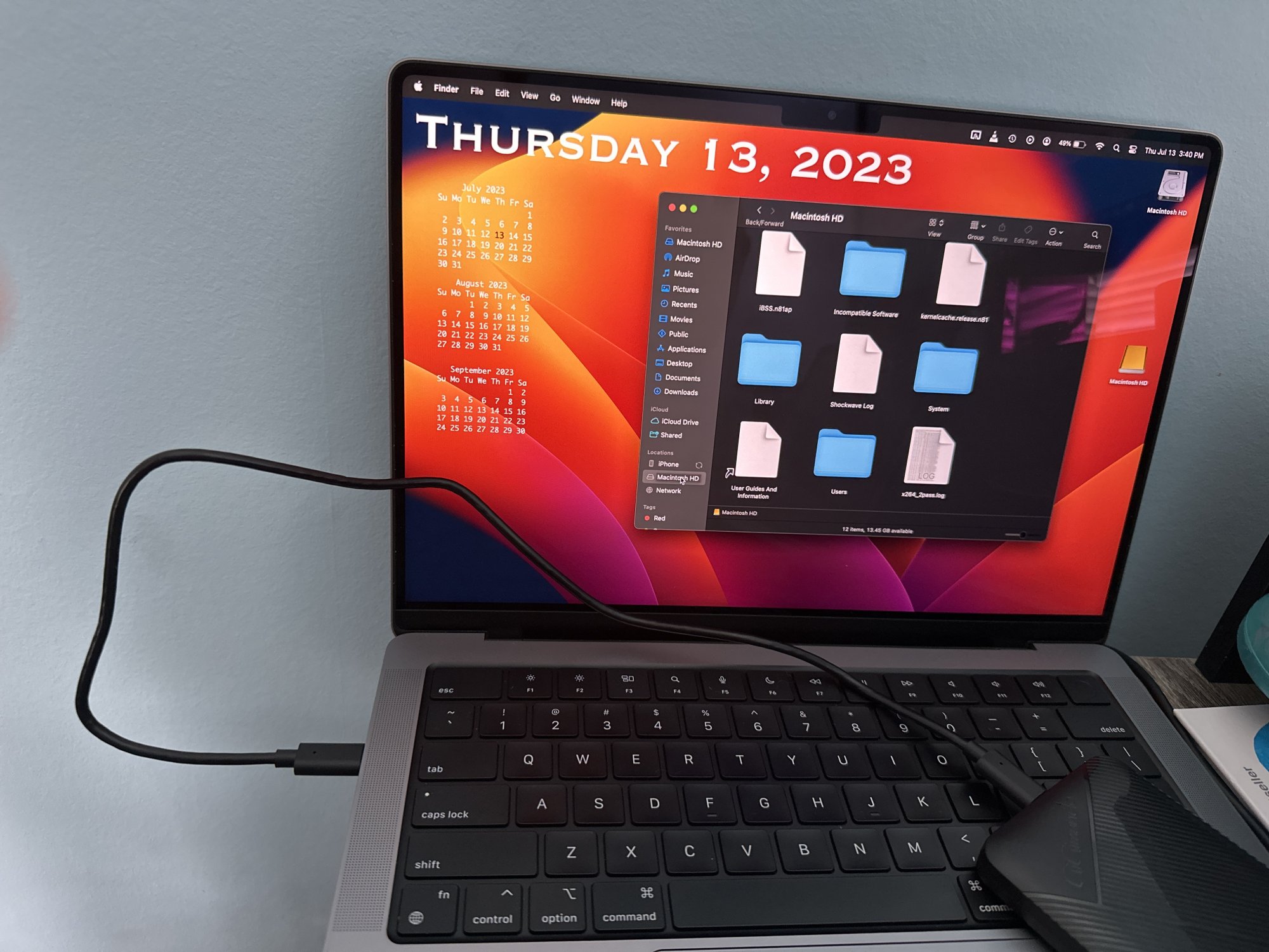

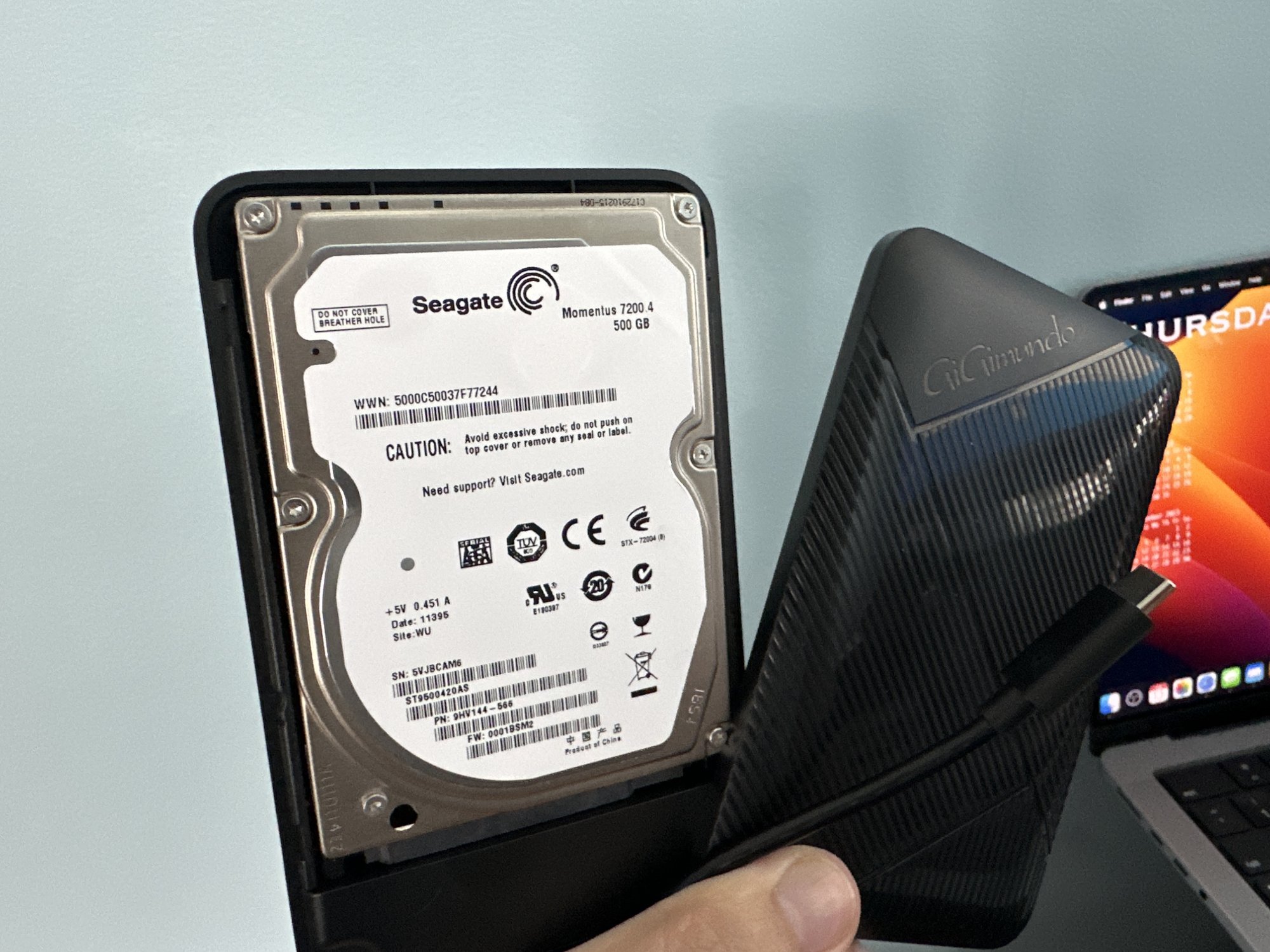

Thank you, can you link me to the drive you bought please?
This is what I bought. I assume your 2015 MacBook has a 2.5” drive in it? You would need to take the back off of your computer and take the drive out. I don’t remember if the 2015 MacBook do have these drives or if they are nvme drives :/
GiGimundo 2.5" USB C Hard Drive Enclosure, 6Gbps USB C 3.1 Gen 2 to SATA Adapter for 2.5inch 9.5mm 7mm SSD HDD with UASP, Compatible with WD Seagate Samsung PS4 Xbox (Black) https://www.amazon.com/GiGimundo-Enclosure-External-2-5inch-Compatible/dp/B0BPXKQJ92
It should show up like this when you plug it in:
I just clicked on the Users folder, then into my profile and everything was there.
Reactions: Christopher11
Really good of you, thank you.
