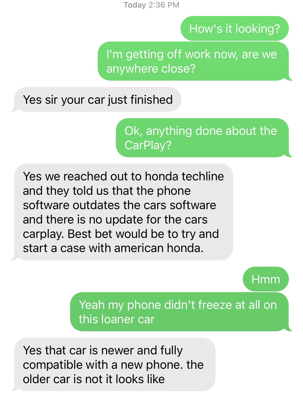

I took my 2017 Honda Accord EX-L to the dealership for them to diagnose why my CarPlay constantly freezes. They gave me a loander car for a few days(2021 Honda Insight Hybrid) Here’s the text exchange…
