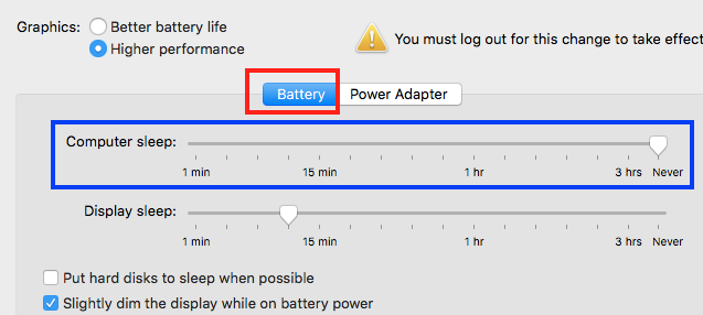

In power settings, have you verified that the system is set to automatically go to sleep? By this I mean:
With my system, even when on battery the computer is configured to turn the display off after 10 minutes, but it will never go to sleep. (it looks a little different with Sierra as this is El Cap)
The reason I ask is because your battery is draining so fast that it sounds like your computer is NOT going to the classic sleep mode. Rather, it sounds like only the display it turning off or a long period of time elapses between when the display turns off and the system goes to sleep - the MacBook has different 'sleep'/power preserve settings/modes such as: display off (uses most power), sleep, and hibernate.

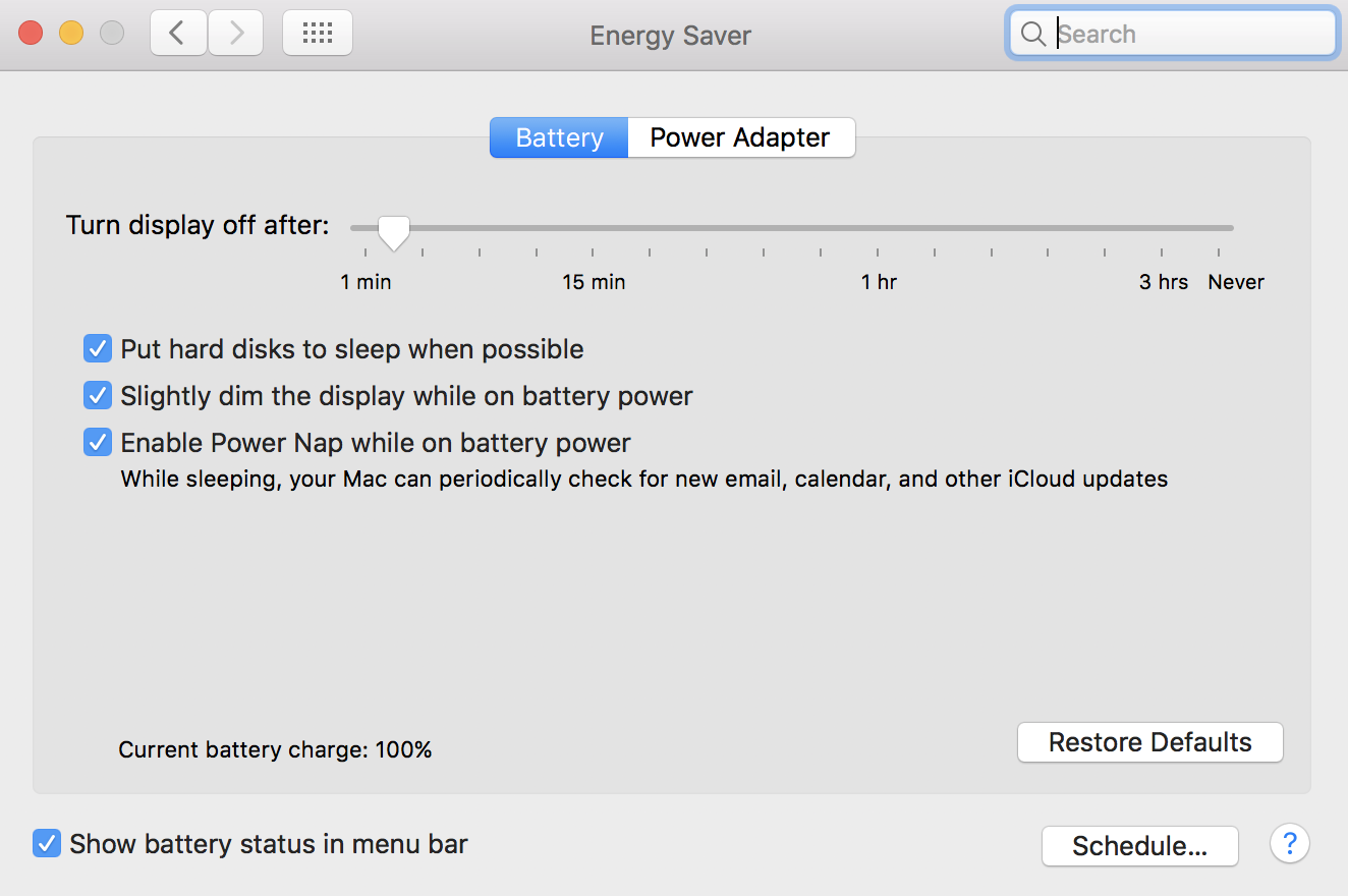

I did not have anything plugged in at all and typically just Chrome and iMessages open. I made the changes below and so far, all is good!
Don

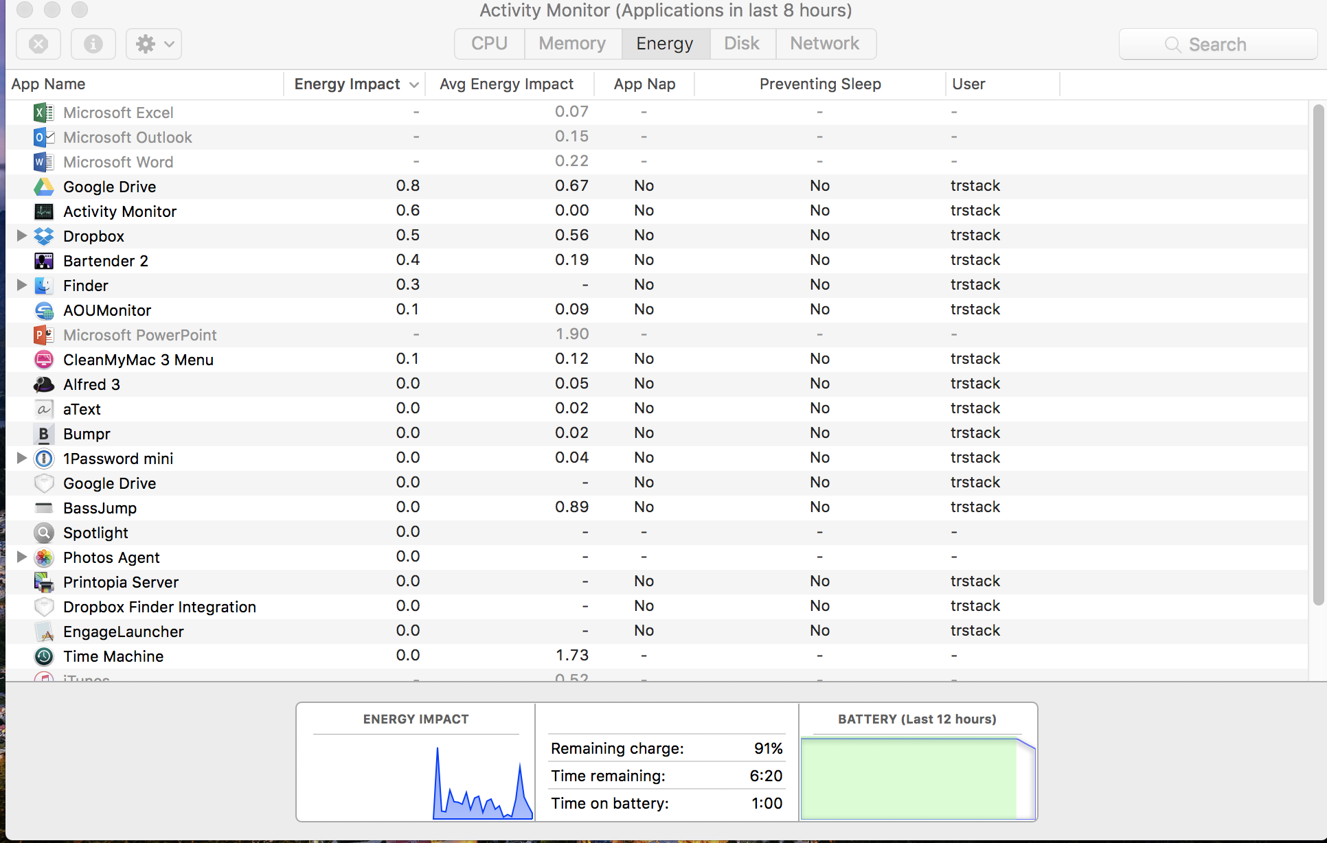

New 2017 MBP i7/16g/512g - 4 days in. Migrated from my 2013 MacBook Air. I know I have indexing and other new activities but after one hour or use (Outlook, Word and PowerPoint) my battery shows 91% and 6hrs 20min remaining. I'm hoping I get closer to 9+ hours. Otherwise, I'm happy I updated. Love the screen, the Touch ID and some touch bar functions which will get better with more software integration over time.

if your system is brand new, it will consume more battery till it indexes all data.
on my first day it went from 100 to 85 while sleeping. Now a week old it stays at 100% when sleeping.
i get mixed 5-7 hours of battery life with all my photoshop, web browsing and little video production.
Also remember, if you are a webmaster and have google analytics open all the time, the laptop will consume all battery in a matter of 2-3 hours. so any tabs who refresh automatically consume more battery.
