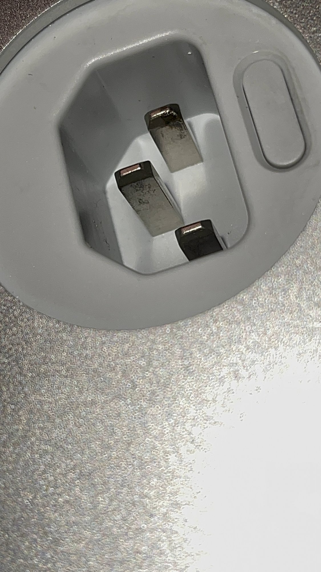

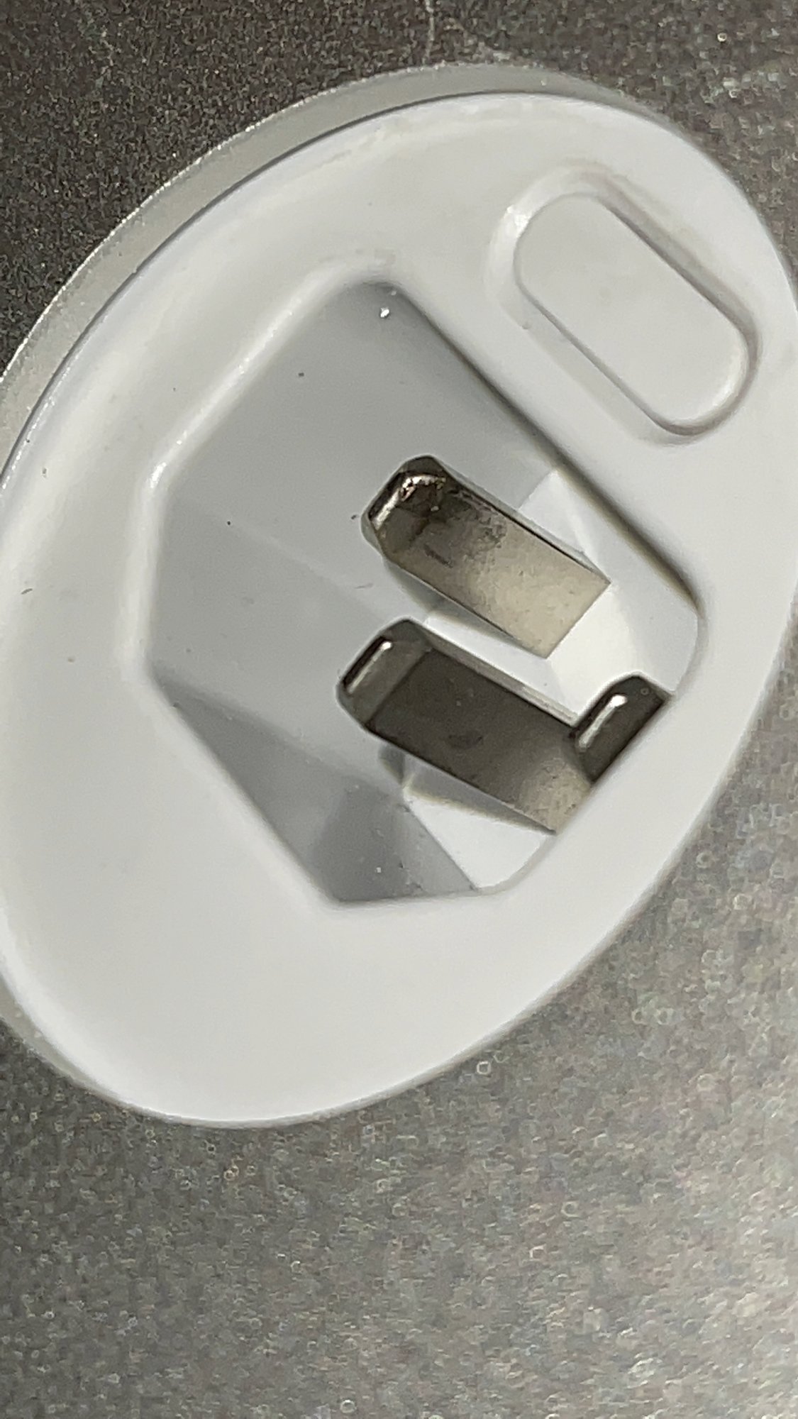

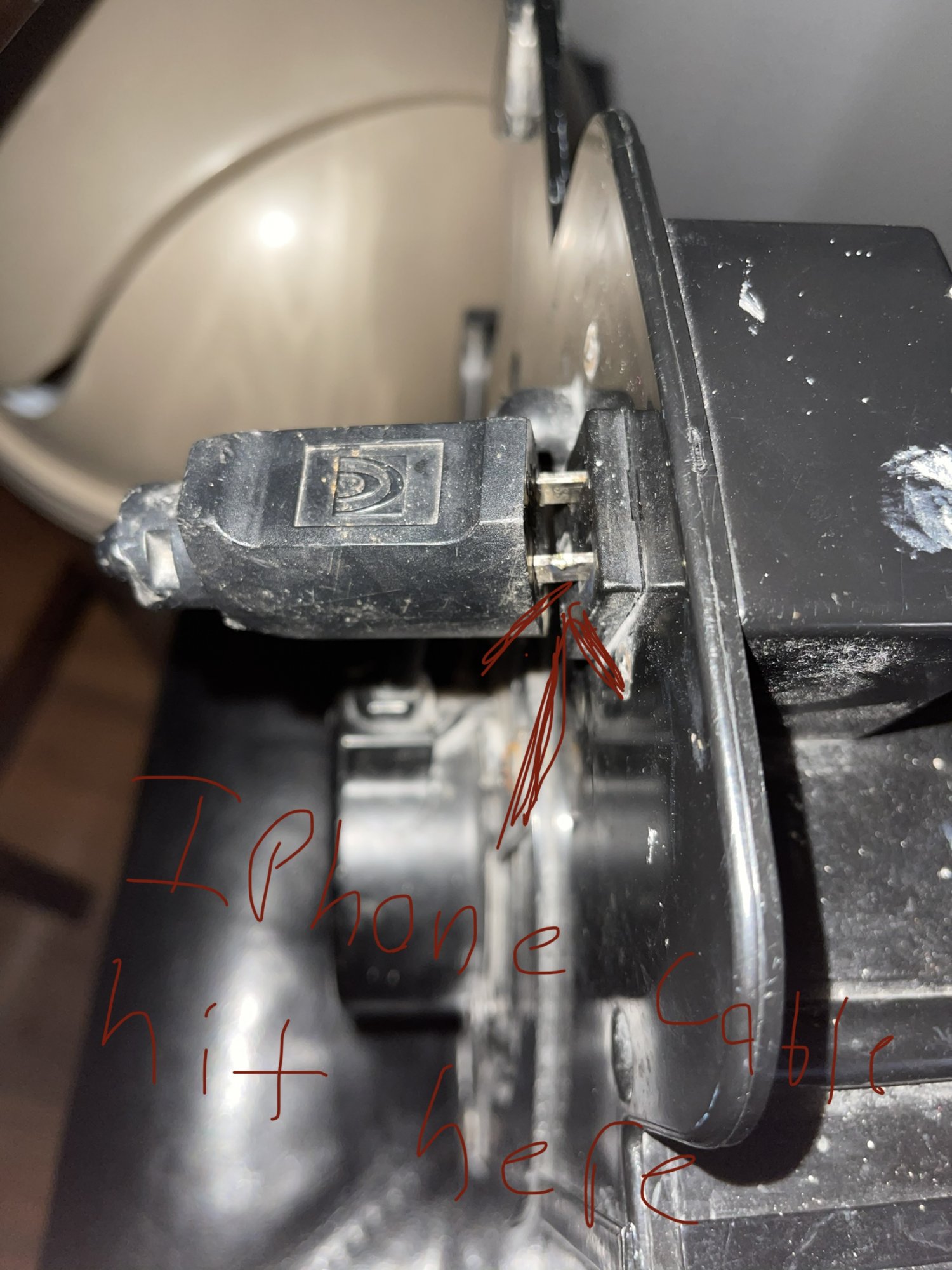

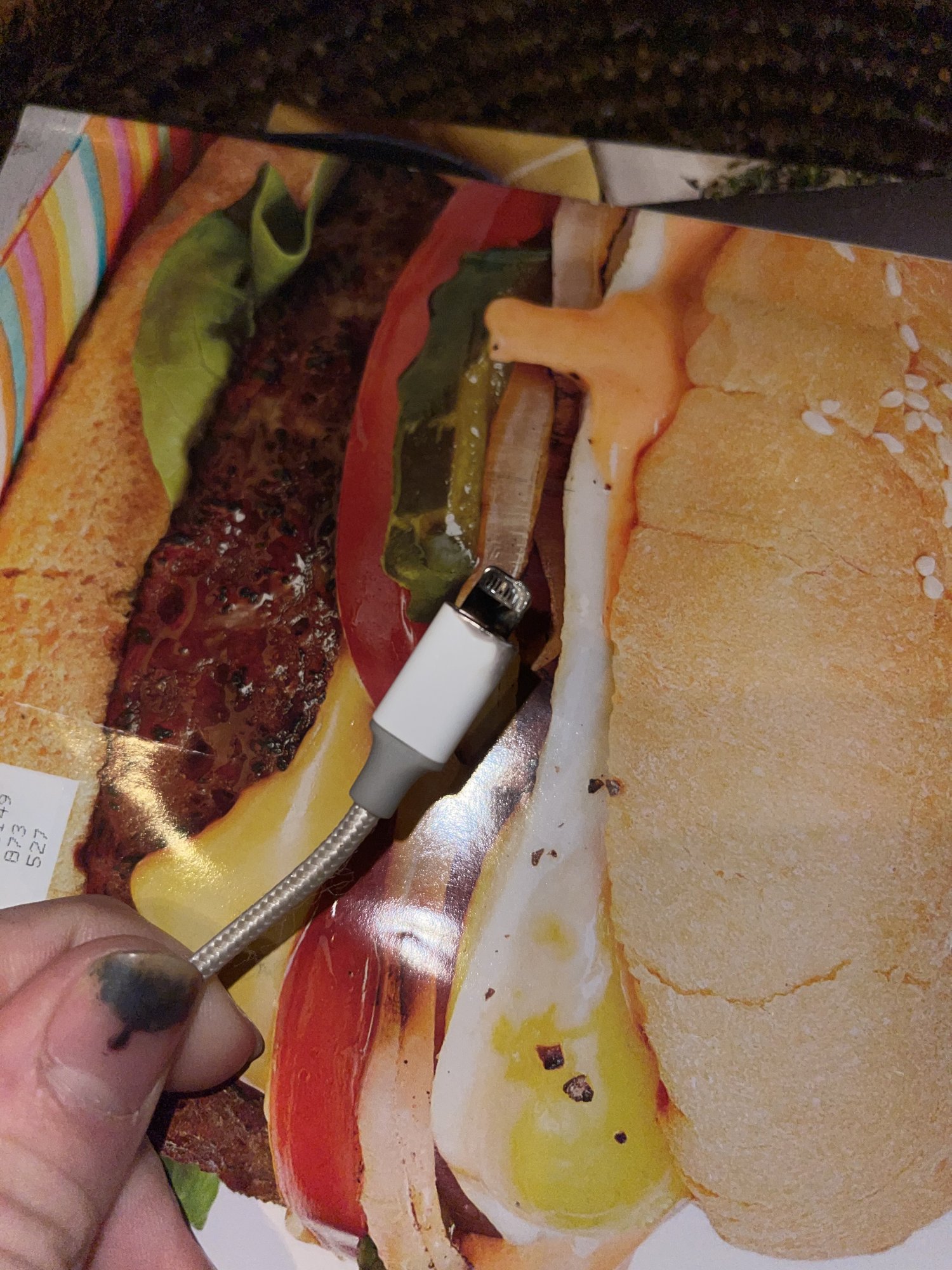

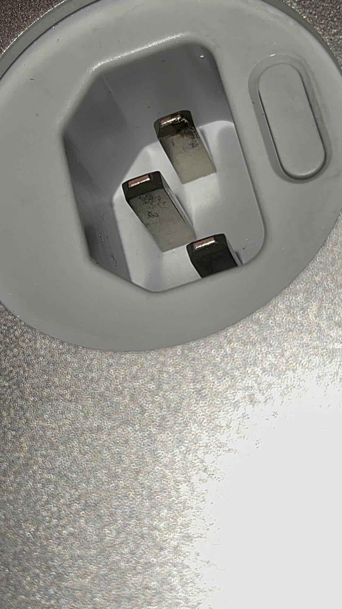

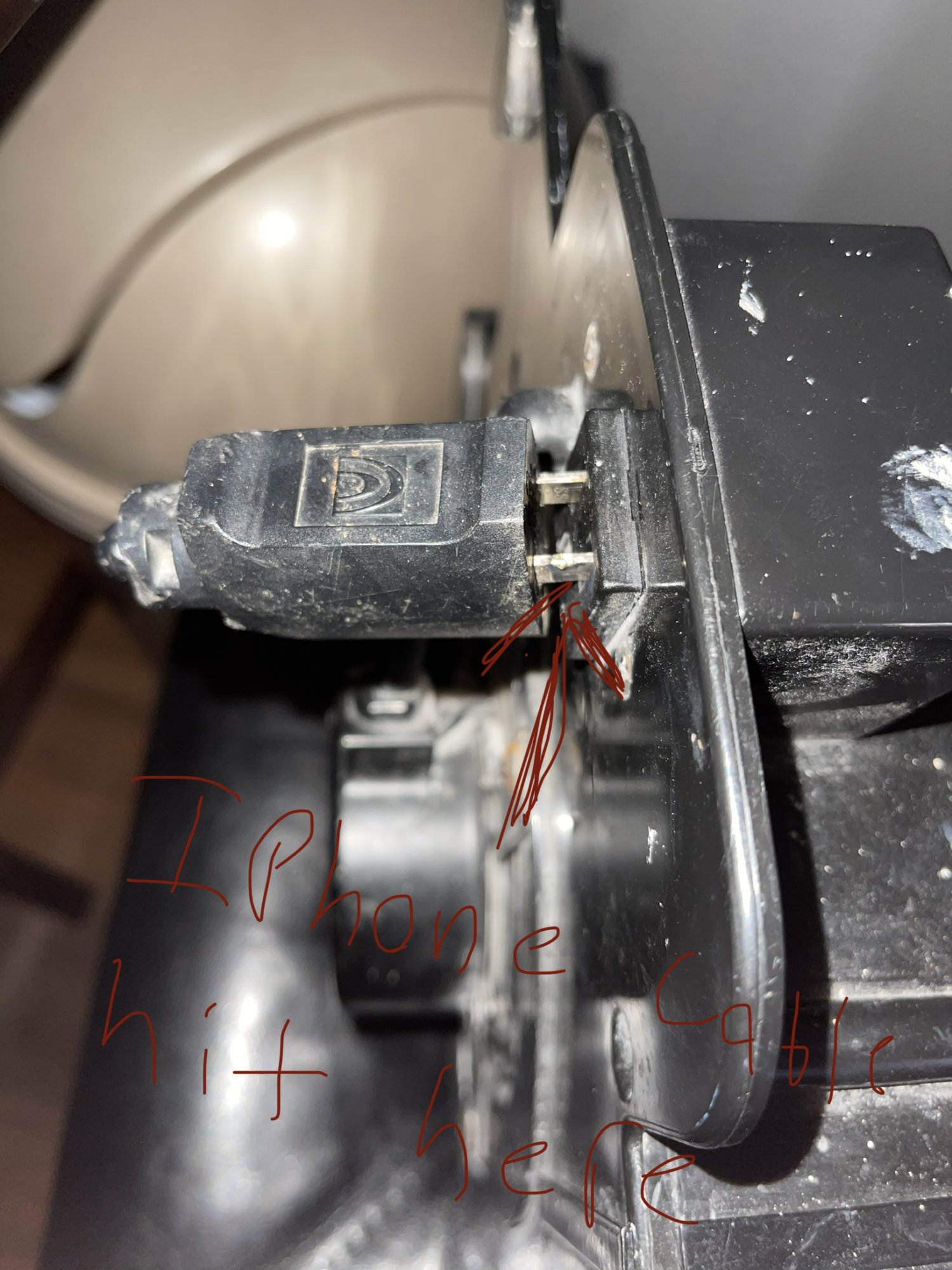

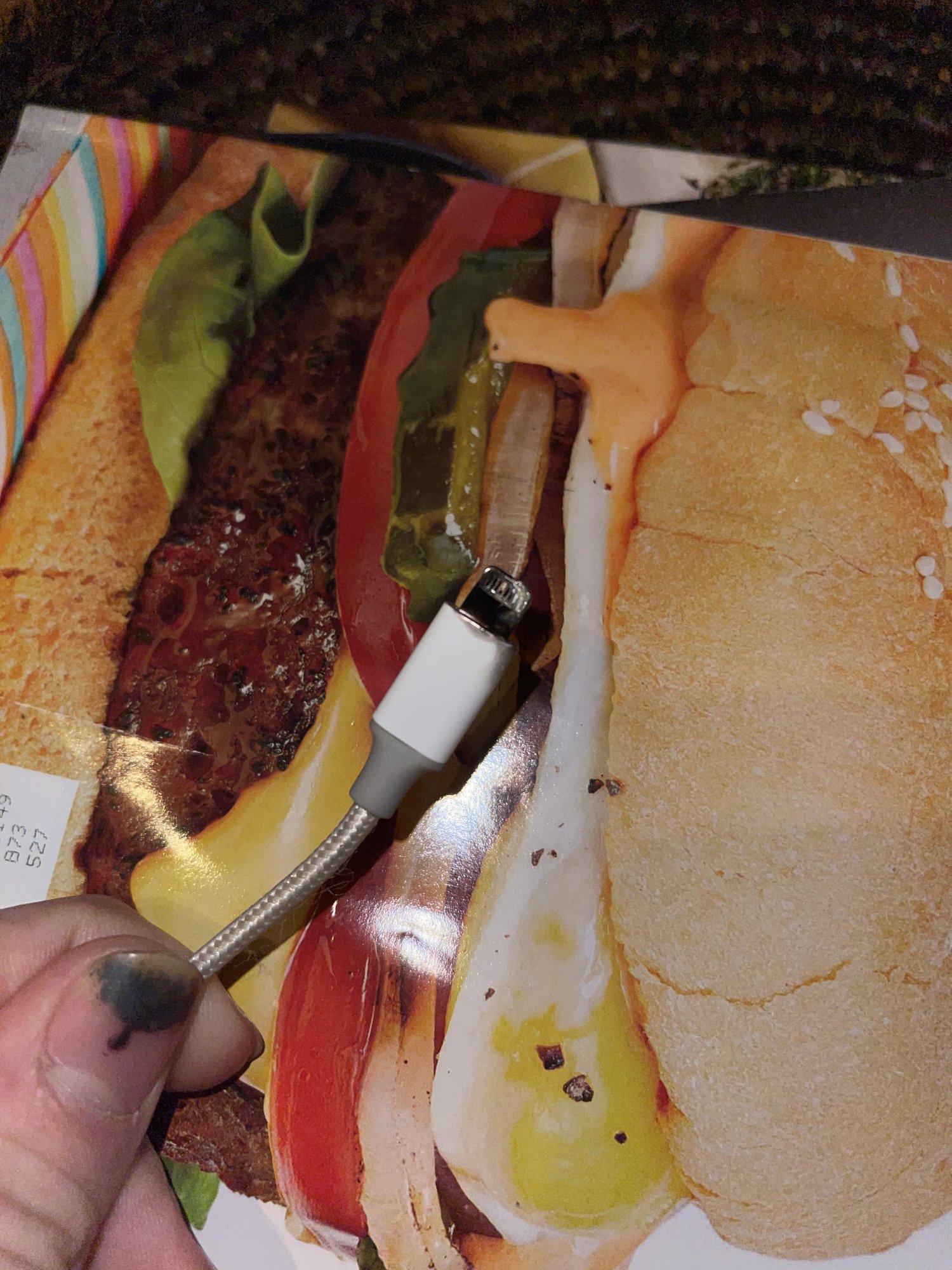

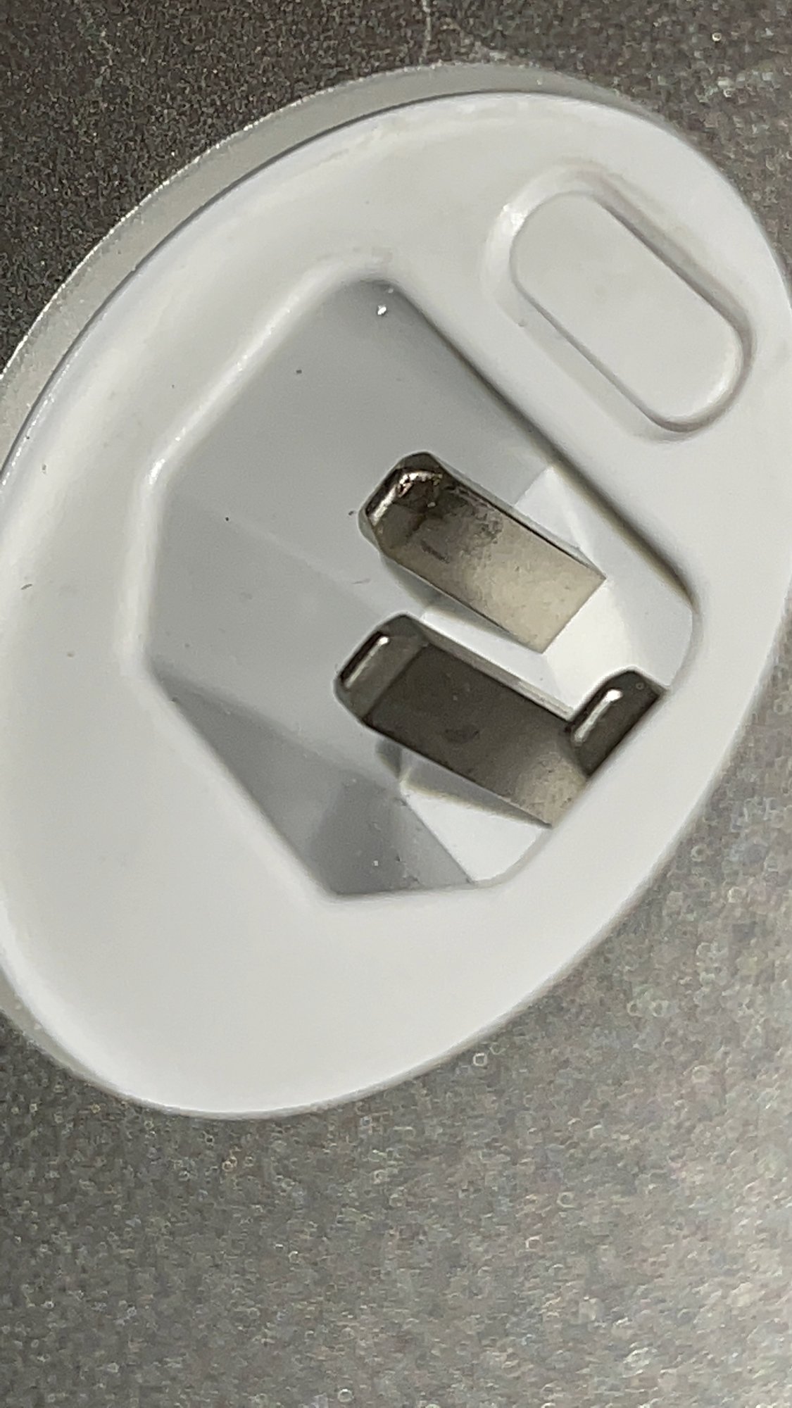

Hey, I’m not sure if this is the right place to post this question but today my 27” 2017 iMac encountered a problem, there was a iPhone charger plugged into the USB port and the computer powered on but in sleep mode and my fiancé went to grab the cable and it flung around and the tip that plugs into the phone hit a metal prong on our heaters power cable that was sticking halfway out the power supply.(if that makes any sense). Basically now the iMac won’t turn on at all, I’ve tried holding the power button for 5 secs etc, I’m just curious what would be the first parts to “fry” in an event like that, I was thinking the logic board or maybe the power supply, I do see a small arc burn on the power supply prong where you’d plug the power cord into the Mac, So Basically my questions are what would break in a situation like I explained above? , should I start with replacing the power supply since I see a small arc burn? ,and is there anything I could look for with the computer apart that would help diagnose the broken/fried parts? I’d really appreciate any help,I’ll attach photos to the post, thanks

Pretty sure there are a set of LEDs on the logic board that (I think) can be viewed from the bottom of the iMac. One LED should light up whenever the power cord is plugged in. Tells you that you have power available, and that the power supply "trickle voltage" is available. That tells you something about the health of the power supply, Press and release the power button should turn on a second LED. Third comes on when the display gets a video signal.
If you don't get any LED, even one, then likely the power supply would be your first step. (Again, be sure to verify the power cord)

OMG that was one crazy accident!
That placemat or table cloth threw me for a second. At first I couldn't figure out why you would want to add a charred cable to your burger (a Corded Power With Cheese?)...

worryingly because the surge of power would be travelled through the logic board, I’m to guess there would be an issue with the logic board itself.
might be worth taking the machine apart and looking for any burnt components on the board though.
Reactions: Thick1992
The tip of the USB-C cable is actually connected to the ground (mass) of the whole logicboard.
You guys have accidentally connected it with the hot wire of an AC outlet.
Considering that, I would say your logiboard was toasted.
If you are lucky enough, your data stored in the HDD may still intact, but the SSD might have gone already.
The LCD may survive, too, but chances are slim.
