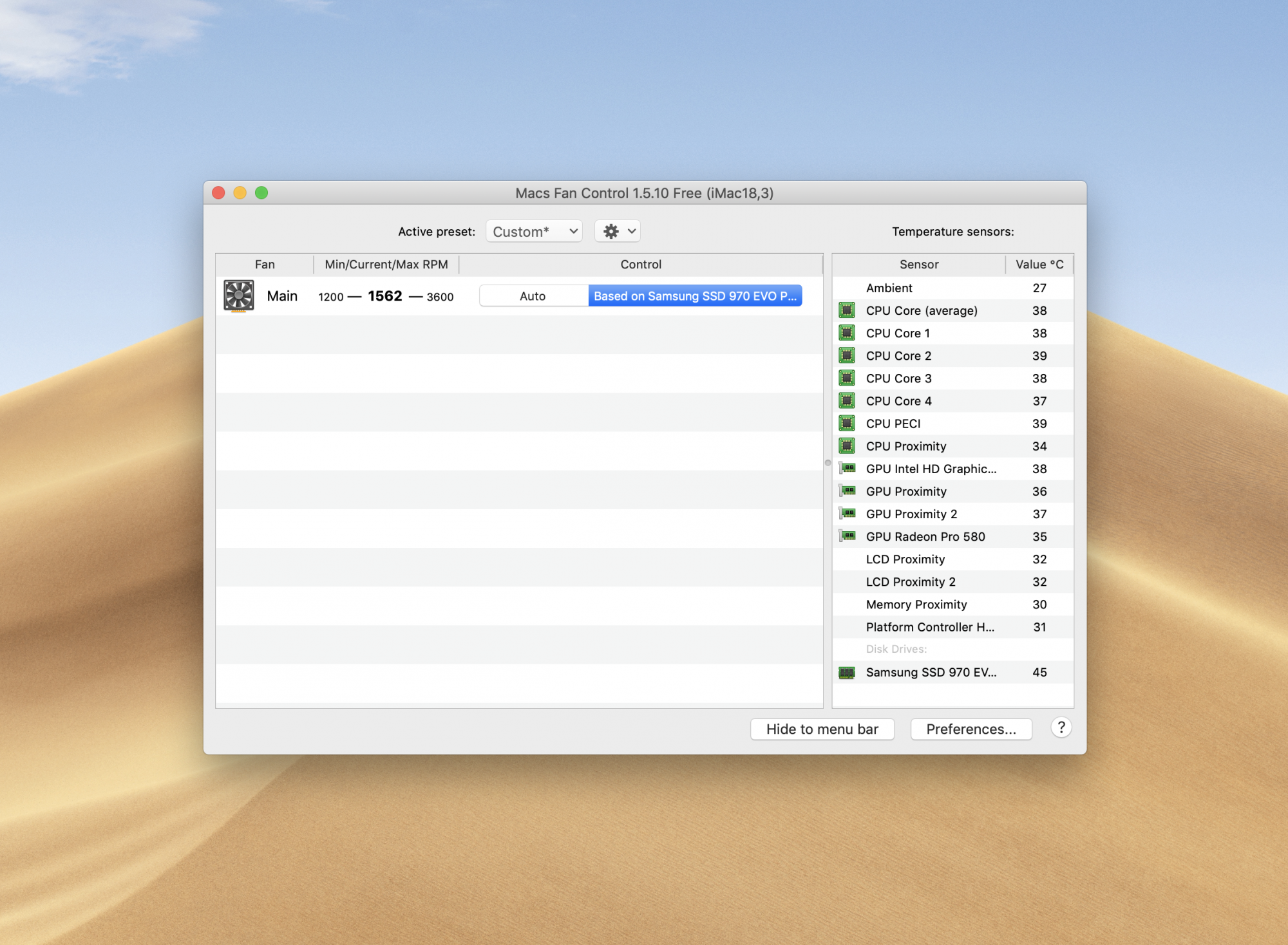

If possible - does Mac Fan Control show a sensor reading for the LCD? If not, this would be the main reason for most/all of your issues you're experiencing.
I think its recognizing it?
Yeah, LCD sensor is being read. There is still the slight possibility that re-seating the LCD cable will fix the sluggish issue.
I do notice there is a lack of PSU temp sensor on that list -- so it is possible that PSU could be the culprit on the fan ramping issue.
