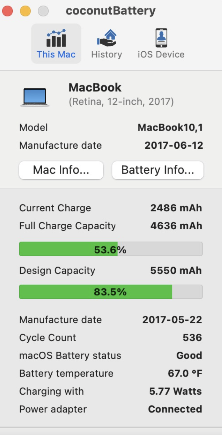

I have a 2017 12" MacBook which has been serving me very well until recently.
It typically charged from nearly empty to 100% within 2-3 hours.
Starting a few days ago, when I plug in the USB-C charging cable, the icon will show a battery with a superimposed plug, and when I click on the icon, it says "Battery not charging." But it IS charging, only very, very slowly; it can take almost an entire day to get back to 100%.
I've tried a different USB-C cable and a different charger, but the behavior remains the same.
Any ideas about what could be going on here?
Here's a screenshot of the output from coconutBattery, which seems to show that the battery is in good shape (albeit with only 82% of original charge capacity)
