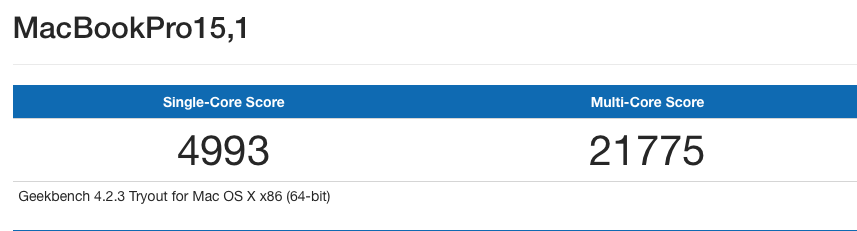

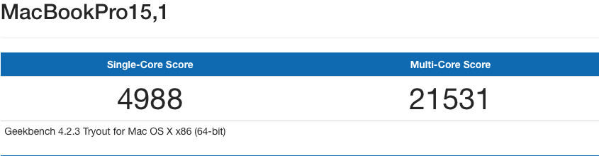

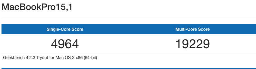

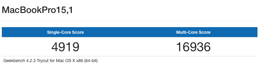

Here's my set of Geekbench numbers using a number of Volta various settings. What's odd is the relative closeness of all three.
So what this tells me, is that if running stock or even undervolting is producing higher temps, then the way to go is the power throttling with Volta as I'm getting similar results but without the heat.
Stock setup (not using Volta)
Volta with power limited to 30watts
Volta with power limited to 45 watts.
Geekbench with undervolting and no power lifts
