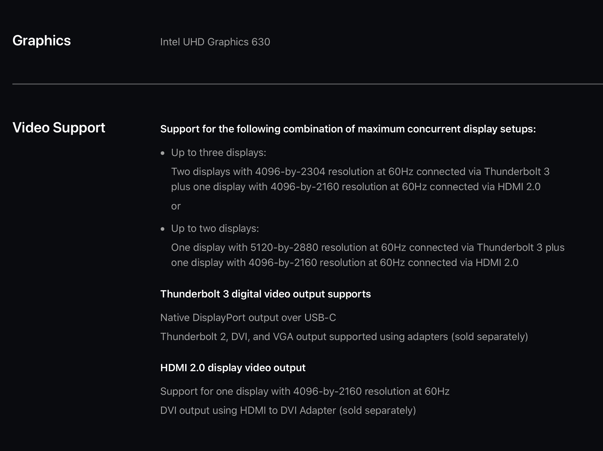

You should pay attention on ports the signal transferred following apple's introduction
