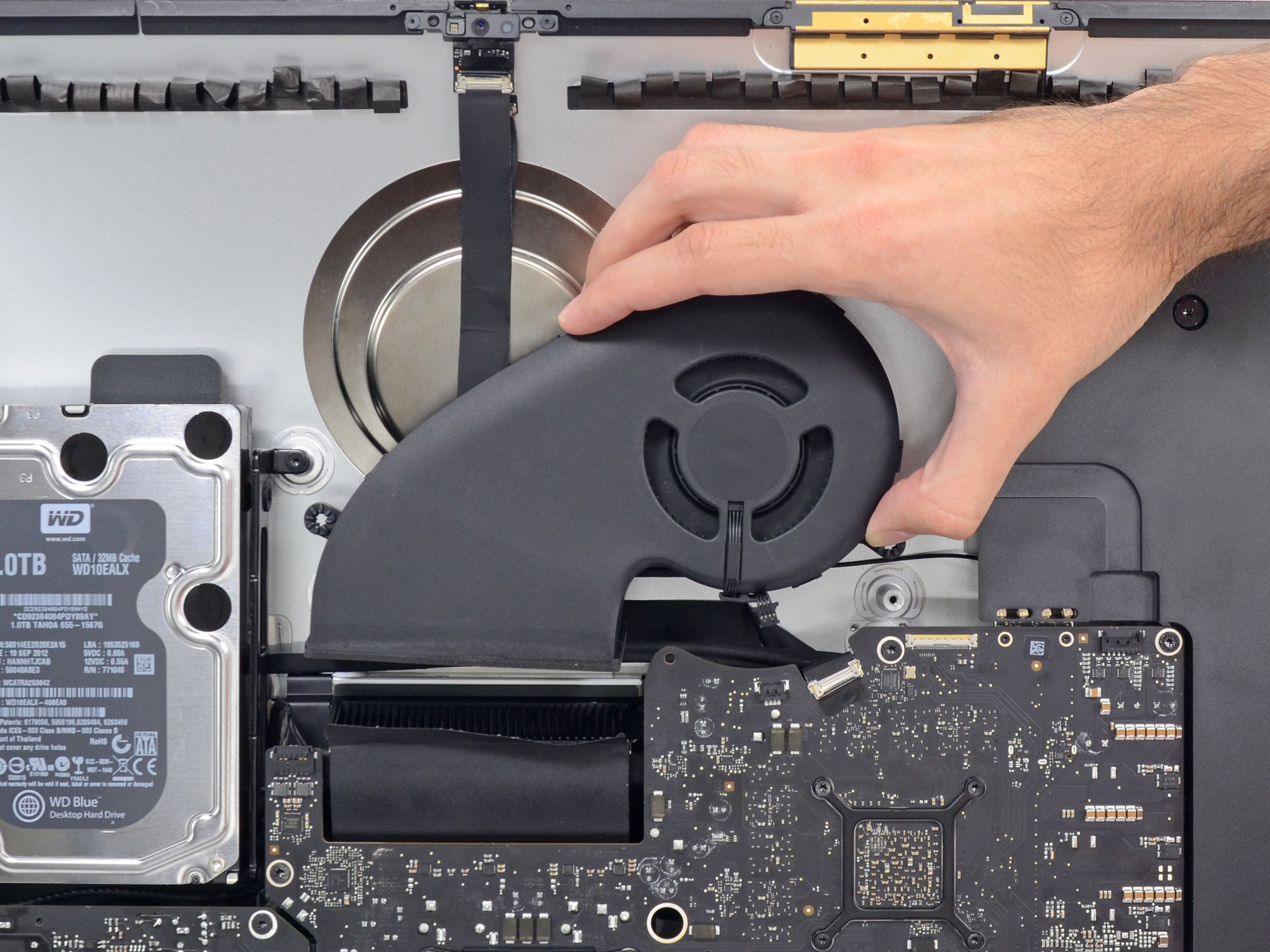

A shame it is such a total buggeration to get to and clean the fan in this model. iFixit shows 19 steps just to get the screen off and you need replacement adhesive strips to put it back on. I'd be very upset if I went to all that effort and found little or no dust.
I hope it's as simple as that. Please do let us know in a few weeks if the problem returns or not.
Attach a flat nozzle or drinking straw to a vacuum cleaner and suck along the bottom vents, with the machine OFF (else the machine fans will suck the loosened dust further into the machine). There is a screen (grid) about an inch above that catches most of the dust. You can see the dust collection on the grid with a bright flashlight. Best one can do without taking the machine apart.
