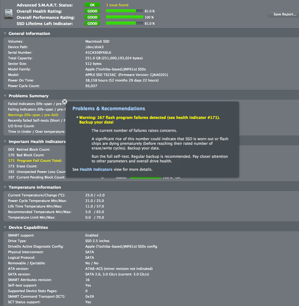

Since starting this thread, I have run some of the disk checks on my own 2011 iMac. It's run flawlessly since I've had it. It has a 256gb SSD and a 1TB HDD. Always been good. I have a backup drive. I've run disk checks on it over the years, but I've never run DriveDX.
So, I ran DriveDX, out of curiosity and it reported that my HDD was all good, but my SSD had errors (see screenshot).
However, then, very soon after, my HDD started clicking. I keep my photos library, and a few other things, on the HDD. I shut down and restarted and the HDD disappeared. I did a PRAM reset and it appeared again and I managed to do another backup.
I then decided to unmount the HDD as it's not required for daily use. Today though, the HDD fans were blowing hard and the HDD has disappeared again from Finder and DiskUtility and it won't remount. All very odd, given that DriveDX reported that it was all good.

Post DriveDX HDD report, if possible.
Unfortunately I didn’t save it but it was all good, no errors or faults. I think it was like 92% lifespan, something like that (which seems crazy considering it’s over 10 years old). Nothing to indicate it would fail in the next few days.
There may have been no way to predict especially given it was the HDD. DriveDx (and CLI tools like smartctl) just pull the drive's SMART counters and highlight if there is an issue. I understand DriveDx compares drive-specific values against an internally developed database to calibrate/risk-adjust so-to-speak but in any case all that requires that the drive believes it is going bad or at least experiencing errors. It's possible that your HDD experienced a sudden, catastrophic failure of circuitry or mechanical components and the best warning practical was what you experienced.
I like SMART and dislike not being able to read it. However, I generally interpret "good" SMART results as "no known issues" rather than actually good. Kind of like you can't prove something is true only that all known evidence is consistent with something being true. Then it's one protection but by no means full protection against data loss / disruption. It's like backup cameras or similar. Even if it only avoids 50% of accidents it still has value.
