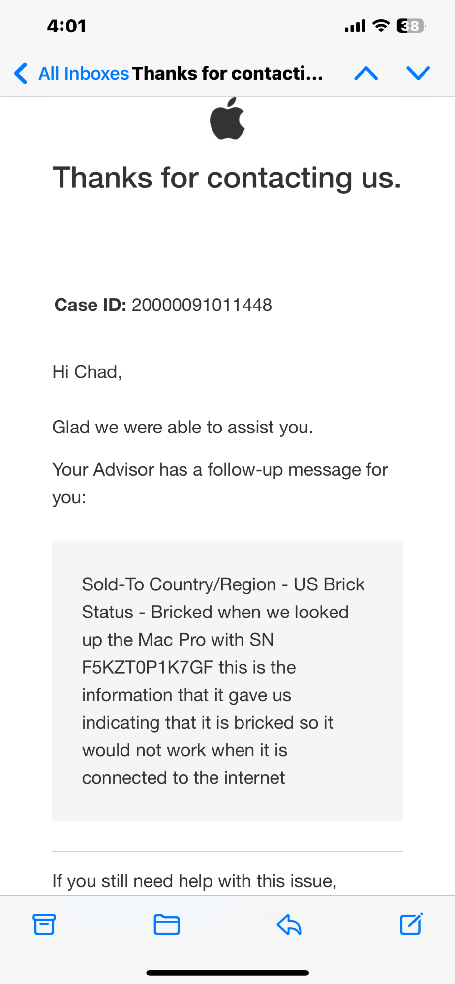

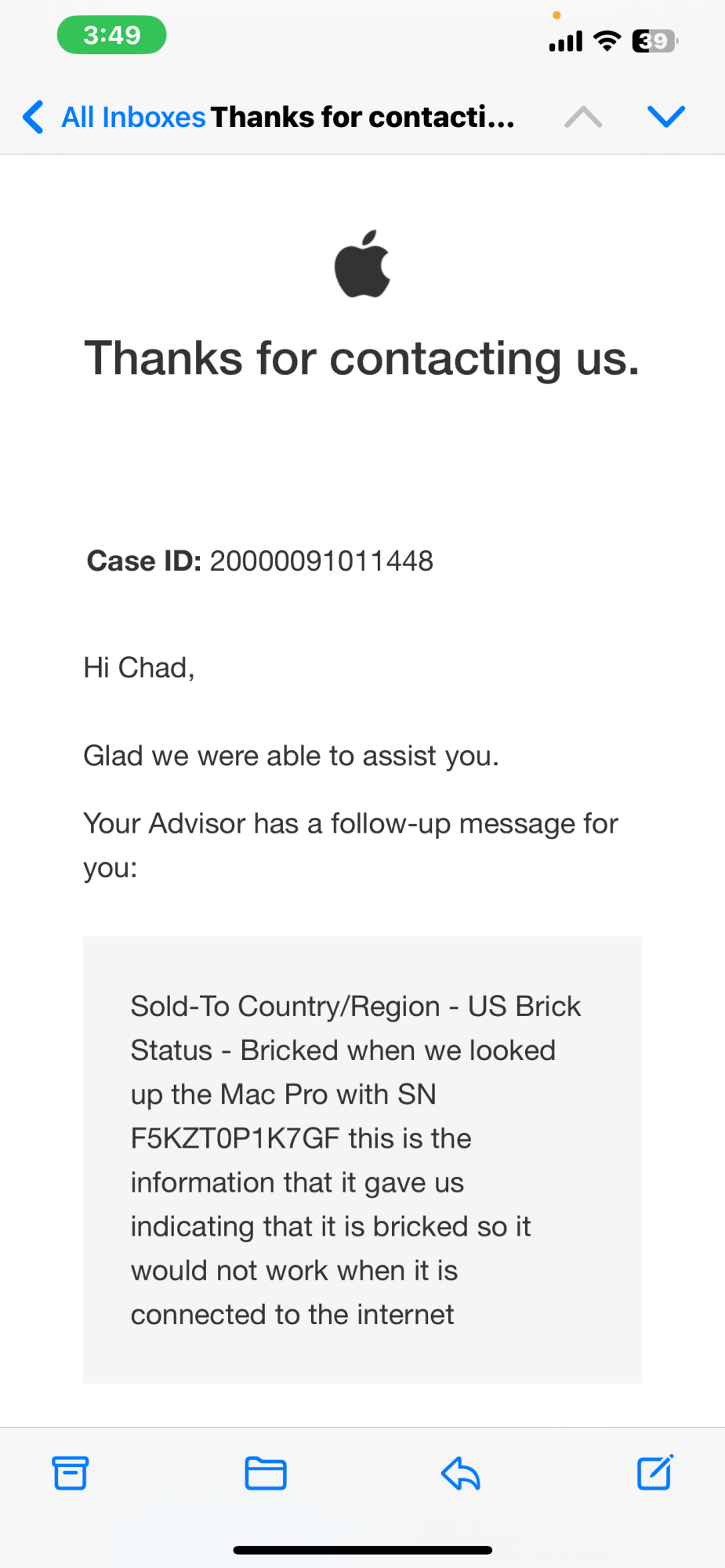

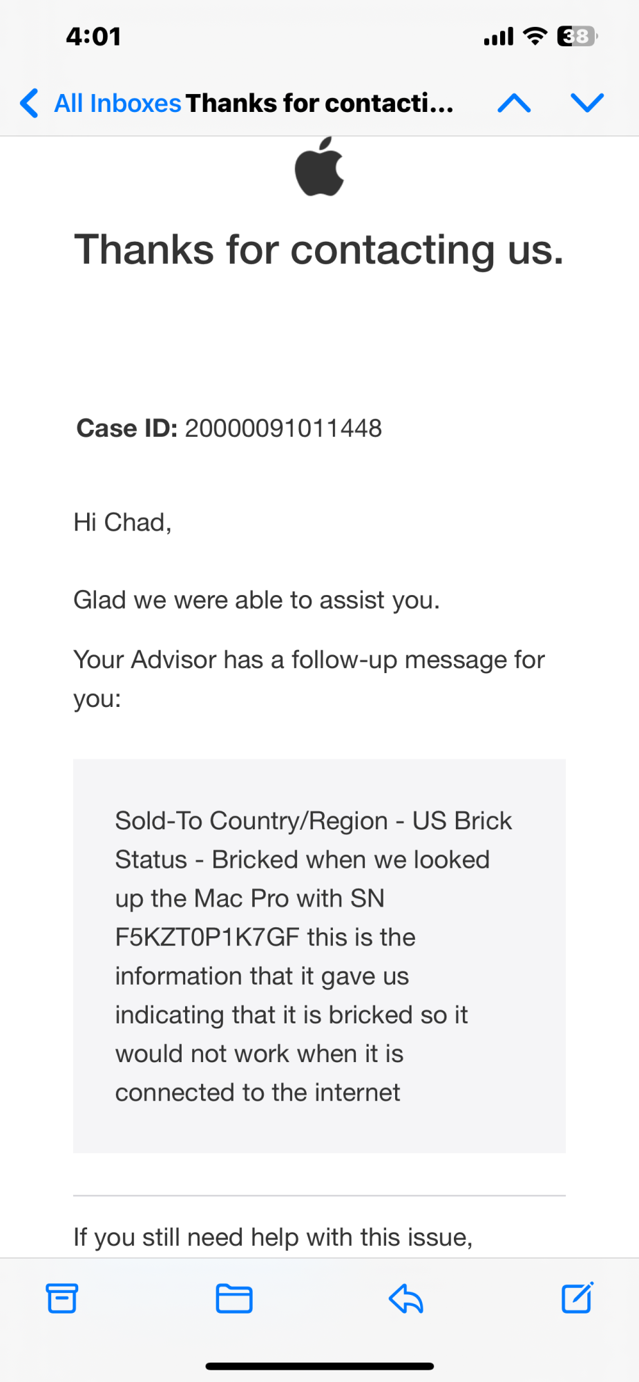

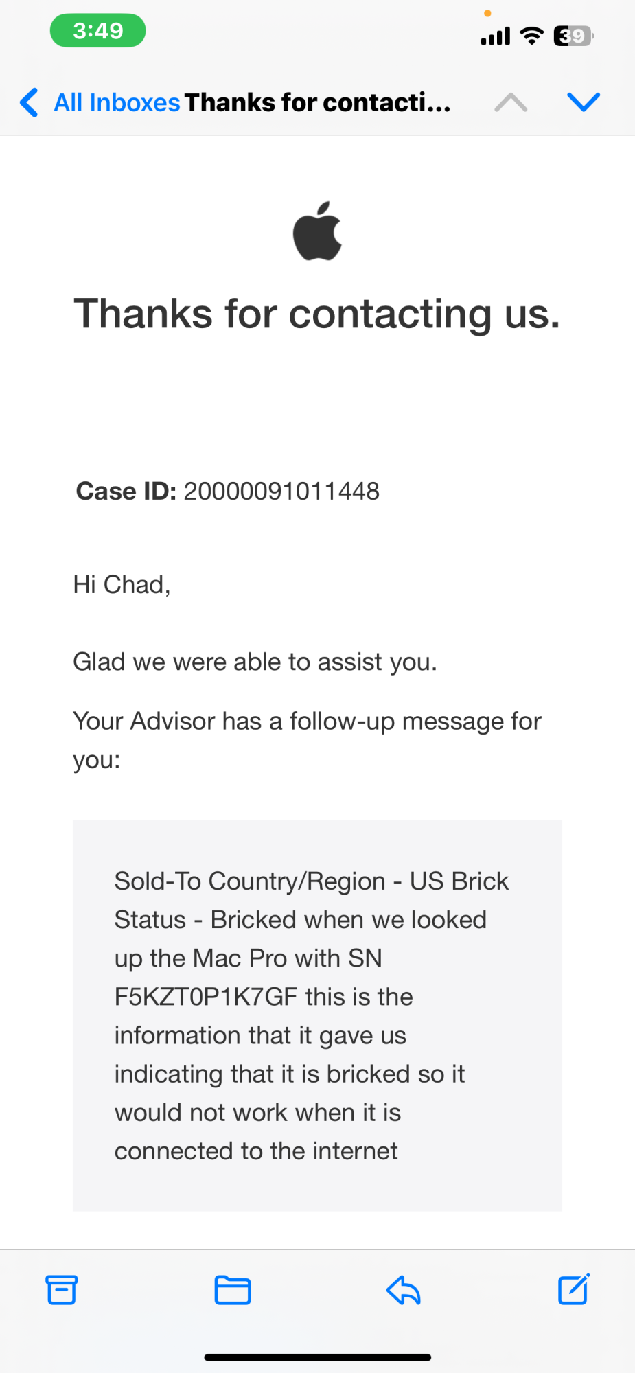

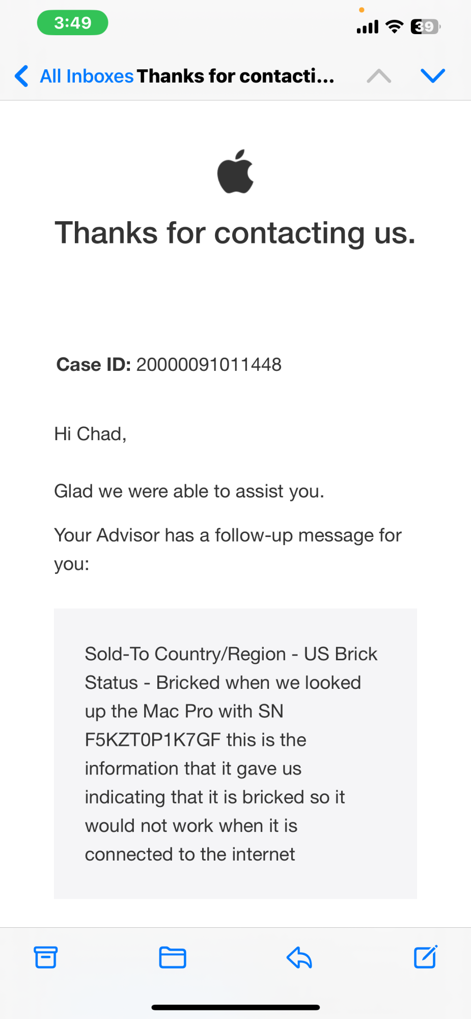

So I called Apple and the guy emailed me this to show the seller. Does bricked effect more than the WIFI and BT? I’m not buying it. A studio is what I’m getting.

What does it mean when Apple support tells you a computer is bricked. I thought “bricked” was an analogy.
Apple support would know a machine is bricked. So they just know it won't start up? No serious issue? what is the common fix?
As mentioned by others, keep away from this, unless you are a major tinkerer and want a repair project (which will probably give you headaches and cost you, as a lot of components are bespoke).

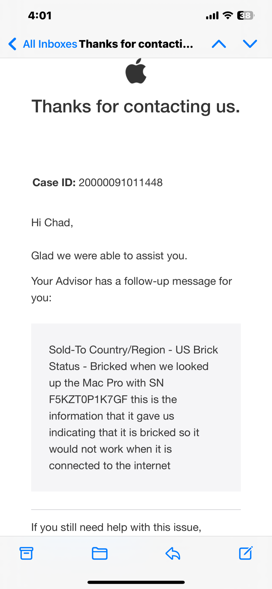

Apple can remotely, permanently kill a Mac based on its serial number or rather, based on its lack of a valid serial number. I recall hearing about one of the iMac factories was stealing surplus parts, and making counterfeit iMacs which were sold "off the loading dock". They were all bricked remotely once Apple found out about it.
Similar to flagging a car's VIN when it's written off by an insurer.

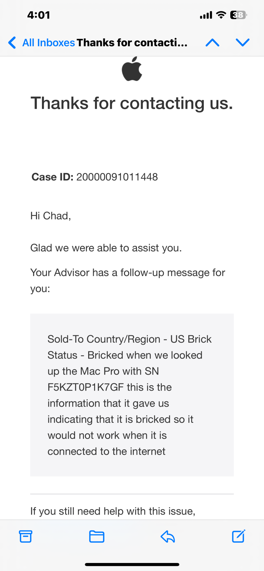

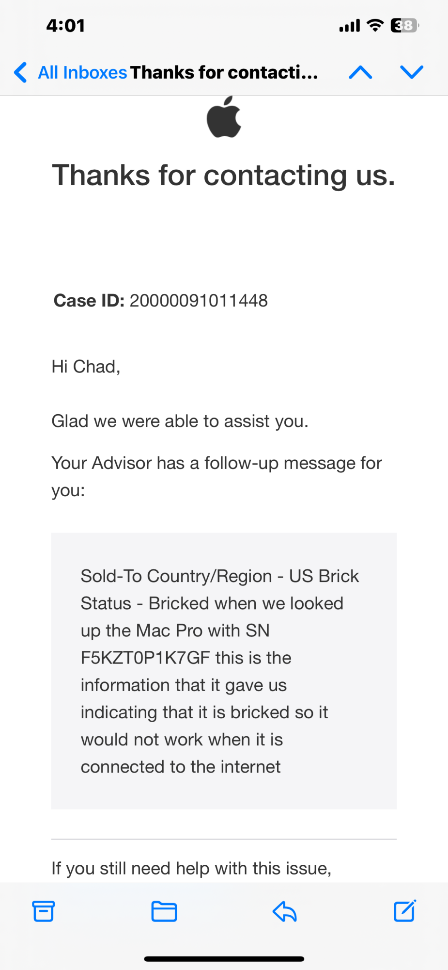

I called Apple support with the serial number of the 7,1, this is what they told me :O. Never heard Apple use the term "Bricked!".
