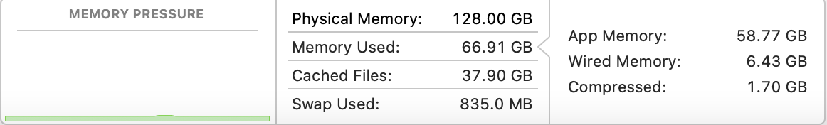

I got my 128GB OWC kit in today. For some reason. I had to install 64GB boot it. Then install the 2nd 64GB and everything has been running smooth all day.
The iMac went for hours or even days without crashing, but it did eventually. I completely shut it down each night and start it every morning. It has happened randomly. By the way, I removed two of the modules and it has been working just fine (no crashes) for over a week now. For some reason, using all four OWC memory modules leads to random crashes. This is 4x16GB modules by the way.
Got a new iMac 2020 i9 10-Core with 5700 XT when it came out. 8 GB Ram from apple which I then upgraded with 4 32gb sticks from OWC. I ordered from Amazon and my Mac would crash every other hour. I narrowed it down to bad ram. I sent it back to amazon and bought same 128GB from OWC and it performed much better. BUT Then it would crash when apps like Folding@Home would run and turn up the CPU's, same would happen when running photoshop, very random. The annoying part is that my old iMac 2012 would never do that.
THEN, thanks to this thread. I took out a 32gb stick (Top One), leaving a total of 96gb inside. Rebooted, machine reads 96gb at 2667 MHz and its been running solid since yesterday(Knocks on wood). With Folding@Home thrown in along a ton of other things in the background. It feels like I got my computer back.
PS. I tried EVERYTHING before doing this re-installed OS, booted in safe mode, unplugged all three hard drives and Wacom Cintiq 24in, and the crashes would still happen. Bummed I can't use 128gb, but not much of a difference from 96gb.

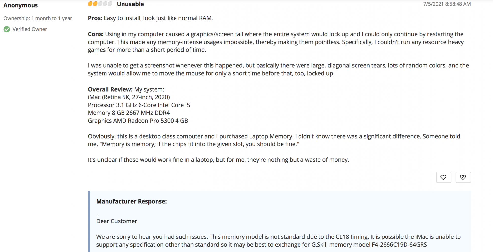

So you haven't encountered any issues because of the non-standard timing? The timing on Apple's stock memory is 19-19-19, while the one you linked is 18-18-18. One of the purchasers at that link mentioned having issues running this in a 2020 iMac, and G.Skill suggested they should install the F4-2666C19D-64GRS (https://www.gskill.com/product/2/197/1610350870/F4-2666C19D-64GRS) instead of the F4-2666C18D-64GRS (https://www.gskill.com/product/2/197/1575884253/F4-2666C18D-64GRS) you're using.
Also, are you getting the full 2666 MHz on these? Sometimes aftermarket memory runs at only 2400 MHz in the 2019/2020 iMacs.
