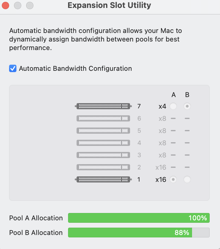

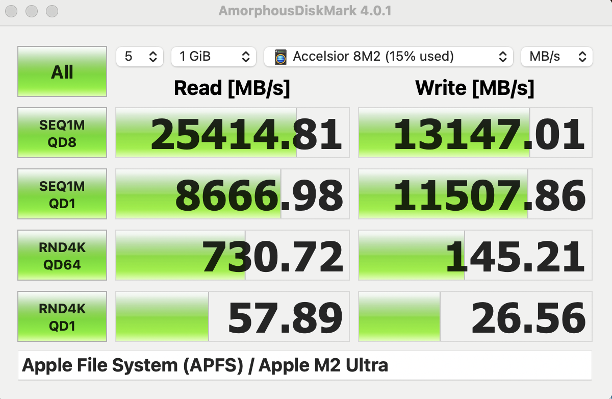

Thanks, but I'm asking for the PCIE Expansion Slot Utility that shows you the PCIE lane usage between the 2 pools allocated. I've attached mine for reference.
I'm trying to see how much allocation a full PCIE 4.0 x16 card takes up in the new Mac Pro to better get a sense of how much bandwidth there really is for those 6 open slots in that machine.
Here's mine!

Wow does that mean after using 2 slots you cant use the other 5 as there is no more allocation. 100% Pool A and 88% pool B with just 2 cards. it might as well be a 2 slot PCIe board then.
It’ll start sharing bandwidth (meaning it’ll slow down the SSD).
I actually don’t even have the power plugged into the OWC enclosure.
I’ll turn istat on to monitor

Are you using RAID 0 or something else?

I think it's just that he doesn't have anything else plugged into those slots. I'm not sure but I think the Mac Pro has a total of 32 PCIe 4.0 lanes with 16x in each block. You couldn't populate each slot and expect each card to have full bandwidth simultaneously, but 1 16x card and maybe 2 8x cards would probably be more than sufficient for many (though not all) use cases. If you move gen 3 PCIe cards over to a new Mac Pro, they would only run at gen 3 speeds anyway.

No changes to speed with power connected. Fans were actually coming on with PCIe slot power only. So this card is fully powered by the PCI slot. No need for power cable to the card

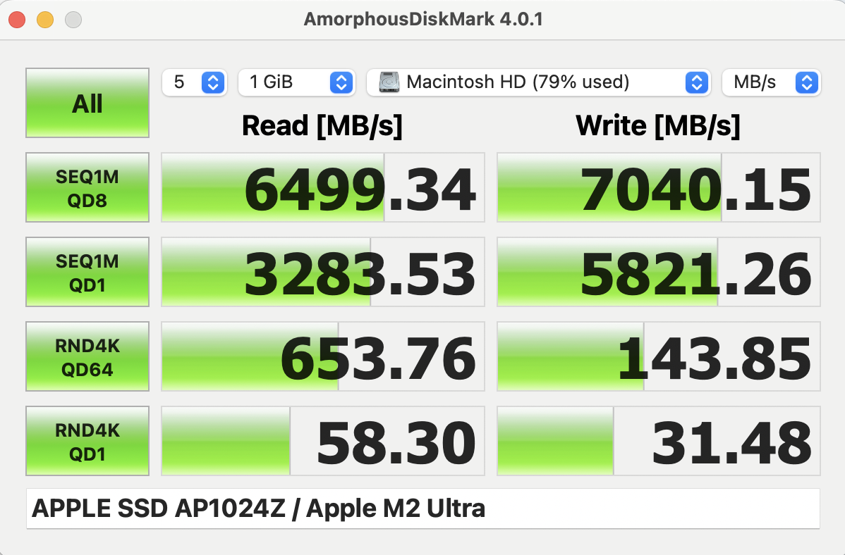

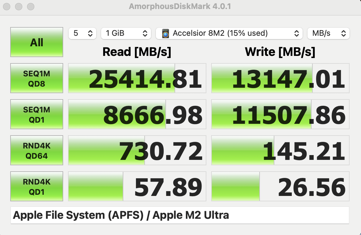

Edit: Ended up adding the 8TB setup from OWC! Love it. Blazing fast, faster than the onboard SSD!

Kind of sad that you have 6 slots but basically are limited to just one serious card. :( Showing one SSD card basically saturates the bus, and any further cards will deteriorate your SSD performance.
I wonder if you fill up the other 5 slots with say 4x cards (not crazy for many sound pros) and then keep the one x16 card for SSD, what your tests would be then.
My hope is while those cards are inert that you would still get full speed. But it's common for 2 or more of the other cards to be pulling in data (eg audio) and then I wonder what the Mac throughput of the SSD would be?
You need to balance that for it to work if you have real time acquisition concerns.
Yeah, when I saw the new Mac Pro in the Apple Store the other week, the stock 1/O cards the come with the machine already take up 88% of one of the 2 PCIE pool allocations!
So one full x16 PCIE 4.0 card would pretty much saturate all the remaining bandwidth given it would take up 100% of Pool B. Crazy its that limited, given its 6 open slots.
