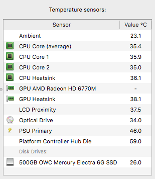

Here's what the 2009 iMac temps look like in MacsFanControl while idling with a browser window open:
The CPU temps are pretty decent, and never seem to get over 60°C, even under continuous load, and the CPU heatsink is never less than 7-8°C below the cores. The GPU is a little worrying -- the 2009 iMac apparently can't recognize the newer card's temp sensor, so I can't see the GPU temp; but the heatsink seems to be about the same as before, if maybe a little better.
