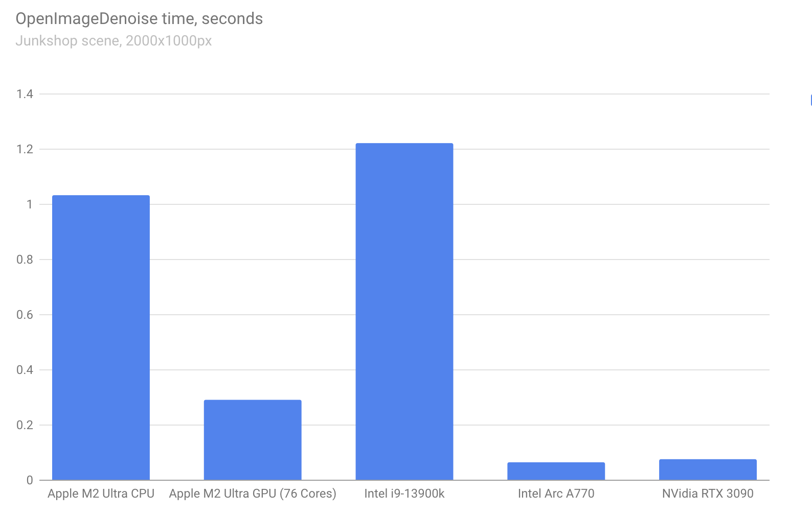

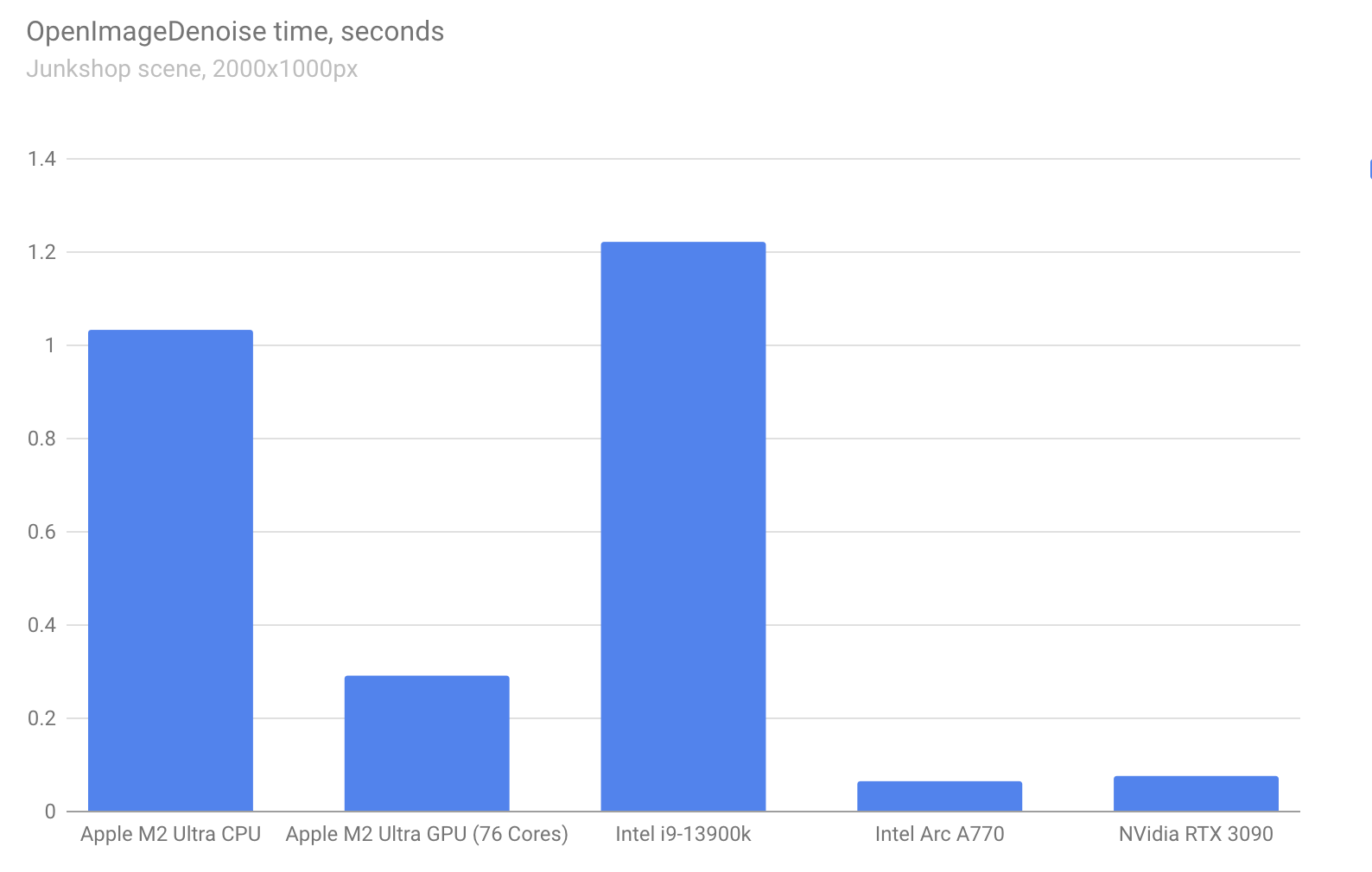

What would that be used for? Denoising? Are tensor cores currently used for denoising?
Intel Open Image Denoise library uses tensor cores.
Intel Open Image Denoise exploits modern instruction sets like SSE4, AVX2, AVX-512, and NEON on CPUs, Intel® Xe Matrix Extensions (Intel® XMX) on Intel GPUs, and tensor cores on NVIDIA GPUs to achieve high denoising performance.
It also works on the Apple Silicon GPU, but not on the NPU.
Intel Open Image Denoise supports a wide variety of CPUs and GPUs from different vendors:
  • ARM64 (AArch64) architecture CPUs (e.g. Apple silicon CPUs)
  • Apple silicon GPUs (M1 and newer)
Reactions: aeronatis
I would think so, yes. OptiX is using the Tensor cores in a similar way to DLSS. Right now, choosing OptiX as denoiser almost halves the duration of the render on Nvidia card; however, Apple Silicon does not have anything corresponding to that. Anyway, I still think it is quite good for M3 Max to be similar to RTX 4070 Laptop with OptiX enabled, especially considering the overall app experience is much more stable on M3 Max.

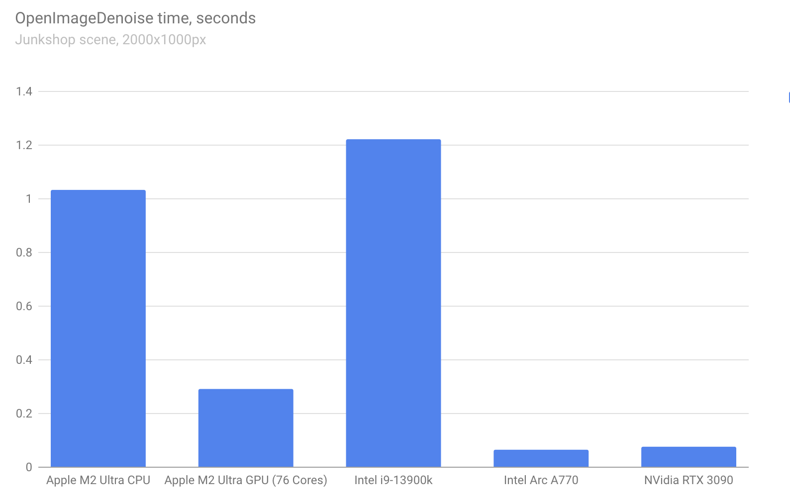

It’s only for one scene (and Blender benchmark scenes vary wildly in complexity) - still this cross-platform chart of denoising times is interesting to me.
Perhaps unbinned M4 Max GPU will approach the M2 Ultra GPU denoising time results (a fraction of a second when rendered at 2000 x 1000 pixels)
Reactions: komuh
Perhaps unbinned M4 Max GPU will approach the M2 Ultra GPU results (a fraction of a second when rendered at 2000 x 1000 pixels)

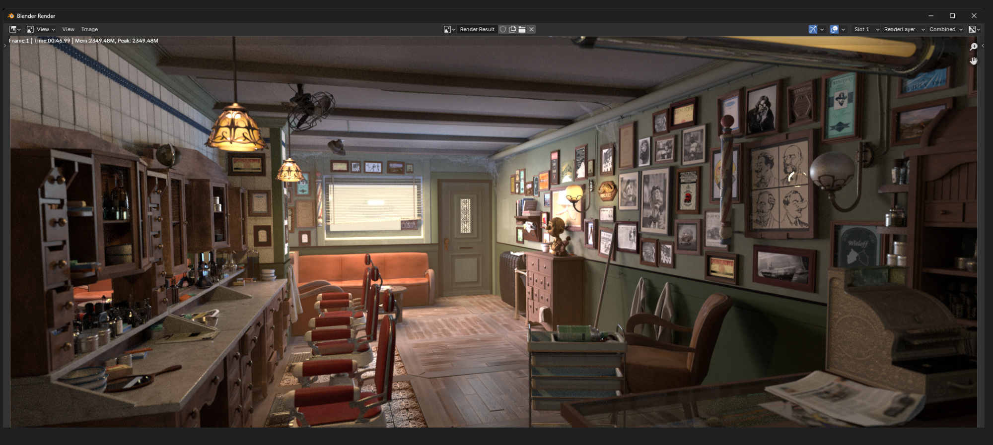

M3 Max and M4 Max have hardware RT, which dramatically increases the performance for Blender. Let me share the same scene I mentioned above (Scanlands) for:
M1 Max: 06:55
M2 Max: 04:09
M3 Max: 01:04
My RTX 4080 Desktop finishes the scene in 00:28 with OptiX and in 01:16 without OptiX, which means M4 Max gets roughly between RTX 4080 Desktop CUDA and RTX 4080 Desktop OptiX if it completes the scene around %20 faster than my M3 Max.
Reactions: Homy
M1 Max: 06:55
M2 Max: 04:09
M3 Max: 01:04
If M4 Max completes this scene around 00:50, it means it is already close to

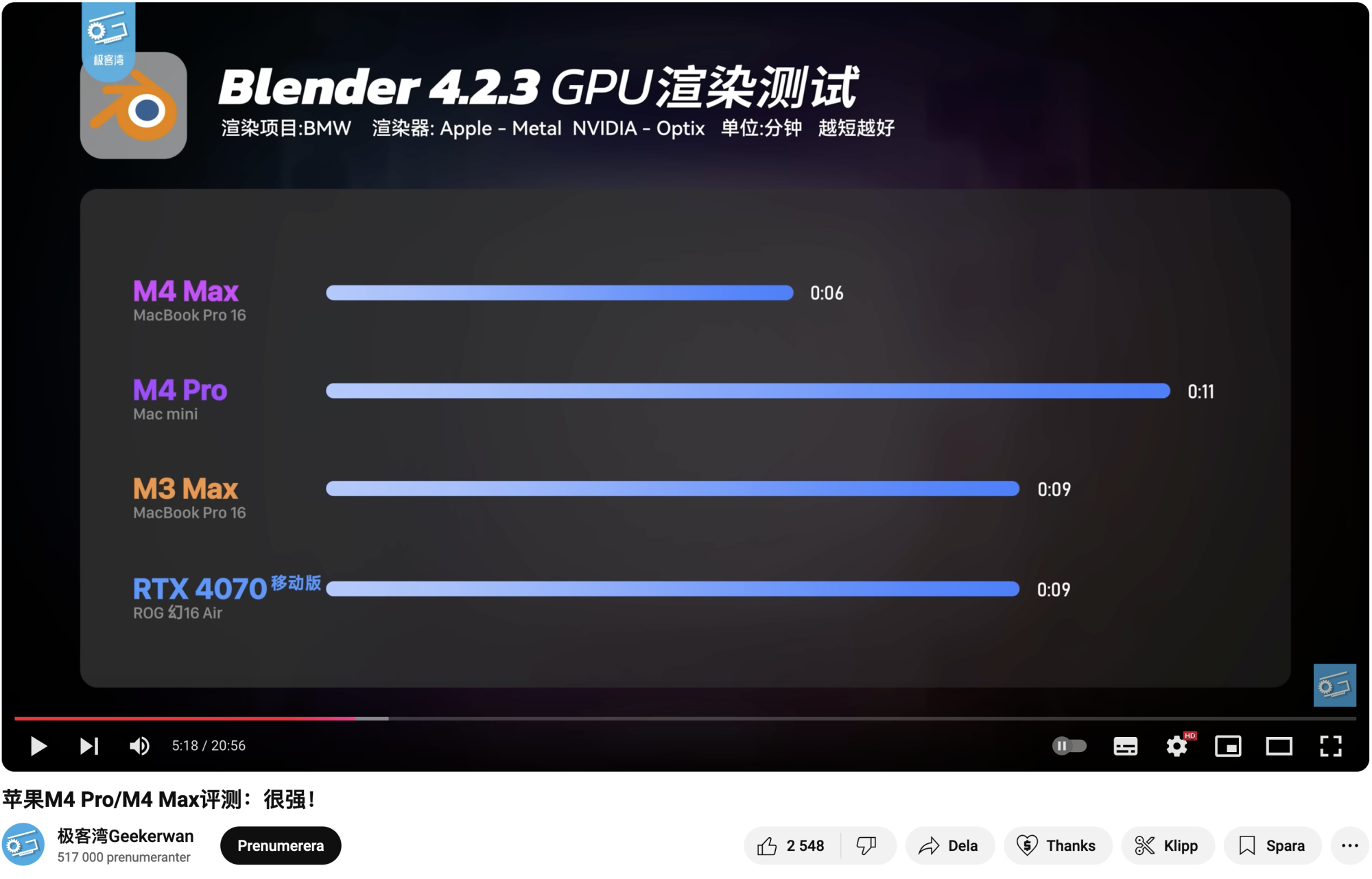

Why such short render? Are they afraid of posting completion time for something longer like Barbershop?
I agree, the bmw scene is not the best. Would be nice to get the Moana island, or Alabs scene, but sadly youtuber's want something that is fast to benchmark, not something representative of production use.

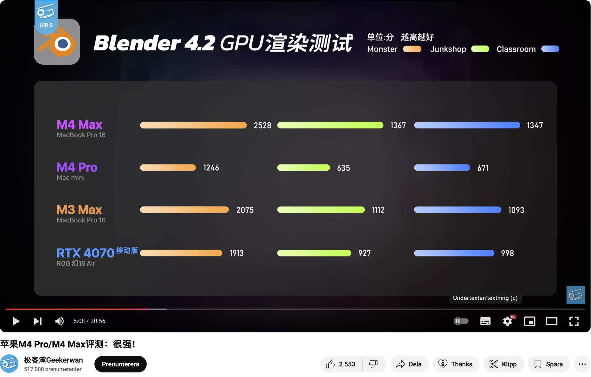

M3 Max is 2.4 - 2.8x faster than M1 Max.
But like you said, the Blender Benchmark sums for all the scenes, and the score database on their site doesn't list the individual scene scores. The fact that Apple isn't sharing the full result so that one can easily compare to the PC scores in the result browser speaks volumes, I would assume.

That is actually shockingly bad performance on the M4 Max in comparison to the Nvidia hardware, TBH. The M4 Max, according to that benchmark, is only eeking out ~4% of the performance of a 4090...
edit.. I just saw other already noted that.
I think you made some confusion, according to the results from top of the page the M4 max reach about half of your 4090 performance:
