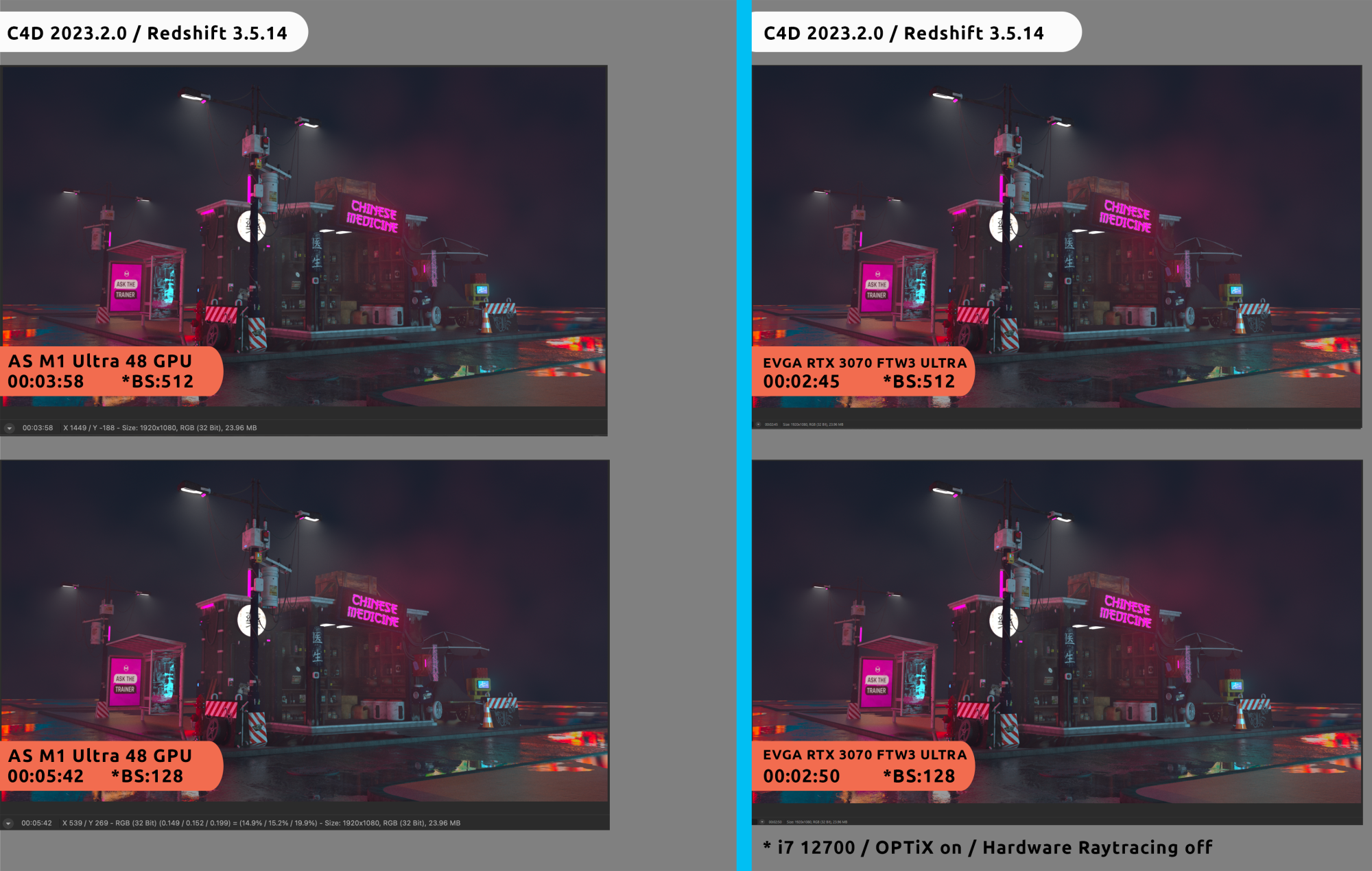

Another quick data. Maybe it will be useful for anyone. It is not for comparing AS with PC's. They are all have their own issues 🙂 I still quite sure to use AS for 3D workflows. I do not want to start another PC v.s. Mac endless topic. They are what they are. Anyone could choose any of them or both of them. It depends on your workloads and budget.
You could see AS main peak is using higher block size while rendering. I believe if it is not restricted with 512 block size by Redshift, base spec Ultra could reach 3080 or even 3080 Ti level for single frame rendering time and it will be great. I hope but not expect these function 🙂 maybe next Redshift release ( in a couple of days I guess ) it could be.
Any one could download these project files from Maxon Training channel and could make their own experiments.

Rendering on 3D is slow for now on M1 Ultra v.s. RTX 3000/4000 series. It is like 2 times slower against 3070 and 4 times slower against 4070.
