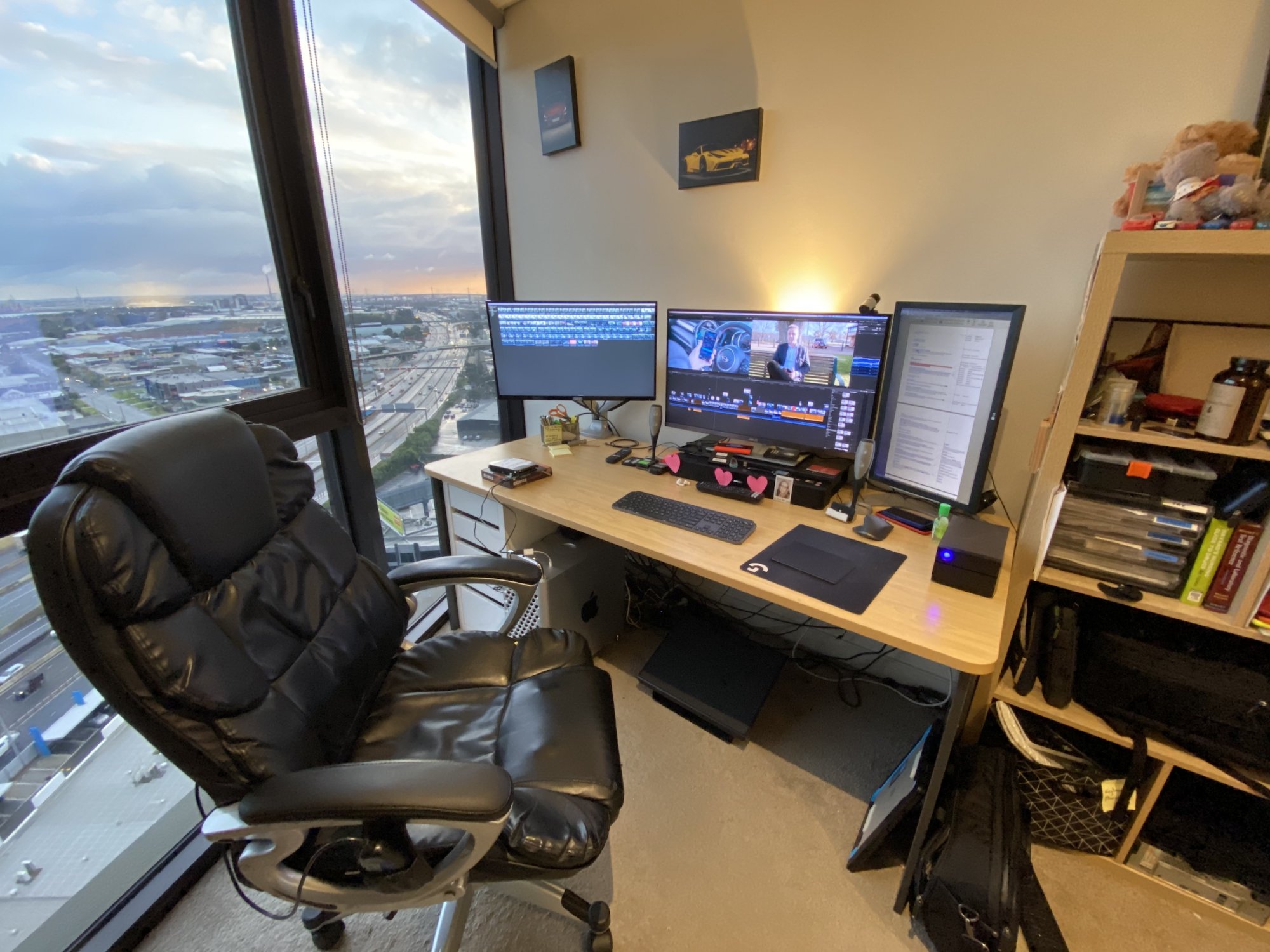

Hi all,
Still working to tune my new setup, and wondering if anyone has similar issues using a non-Apple display (i.e. something other than ProDisplay XDR or LG Ultrafine).
I picked up an ASUS ProArt PA32UC display to pair with my new MP, and it just doesn't seem to want to play nice over Thunderbolt 3.
I have three displays setup, the ASUS using Thunderbolt 3, a UHD display to the HDMI 2.0 port, and a 1080p display in portrait using an Apple AV adaptor (had one lying around).
All the screens work great until I reboot, then the Thunderbolt 3-connected ASUS doesn't light up or show as connected. I have to pull the cable and reconnect, and then it shows up. Often it will re-enable the HDR mode, so I have to manually turn it off again.
I have tried connecting it to both buses on the W5700X but doesn't seem to make a difference.
At this point, I'm considering ditching TB3 and switching to a USB-C to DisplayPort cable to hopefully gain some stability, but it sucks to have to give up the USB 3.0 hub on the monitor, especially when this should be working fine.
